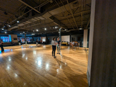

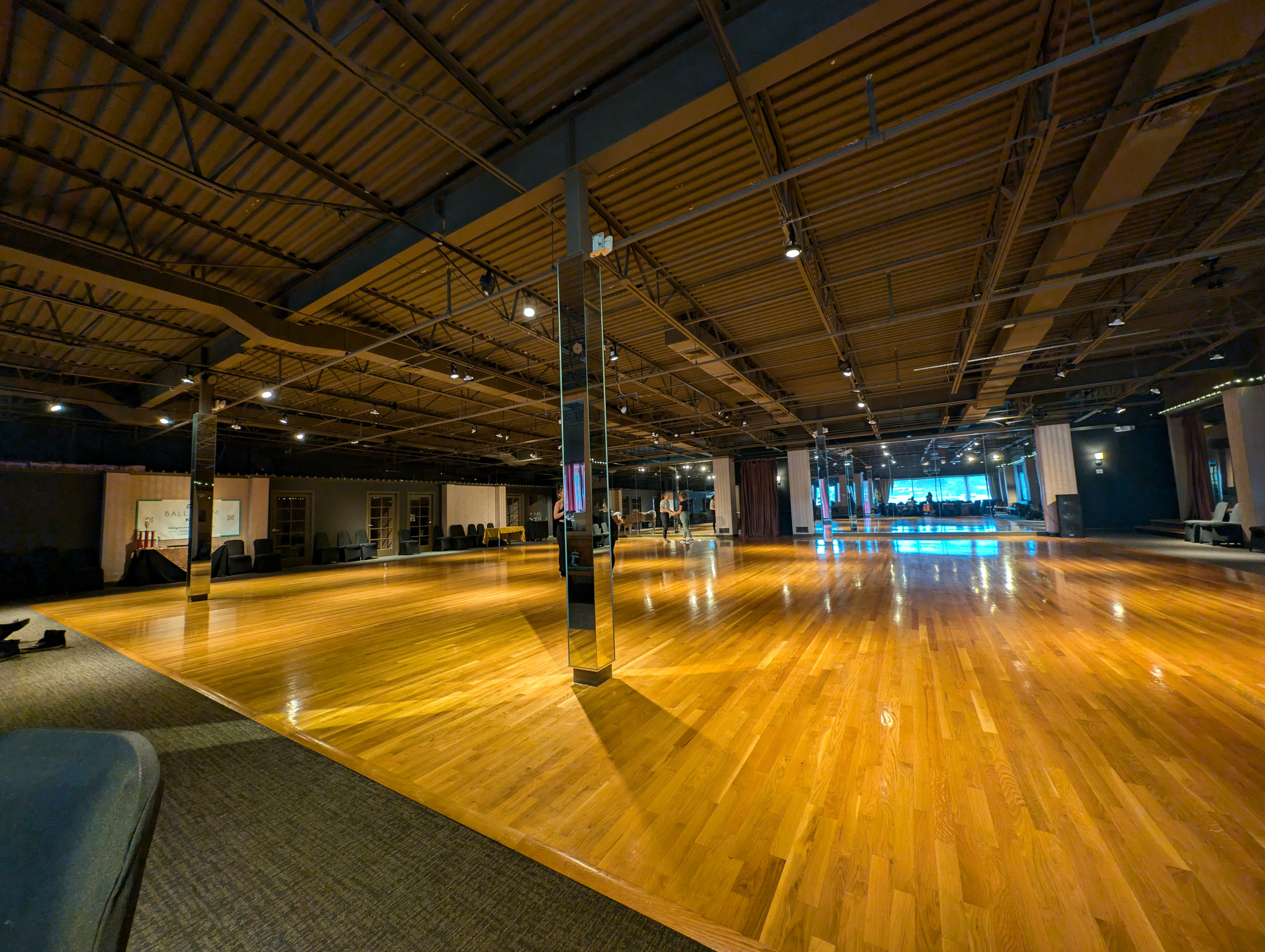

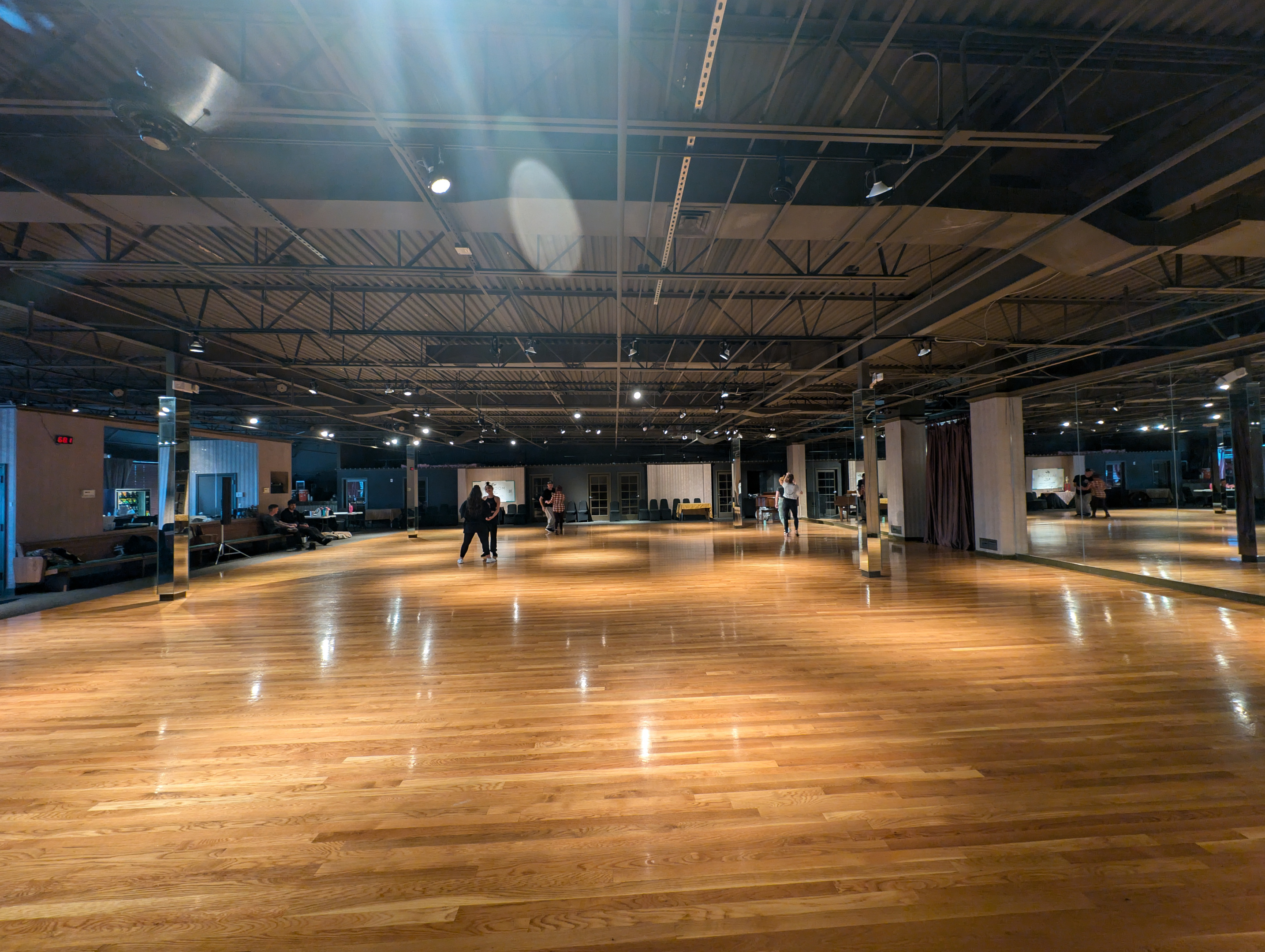

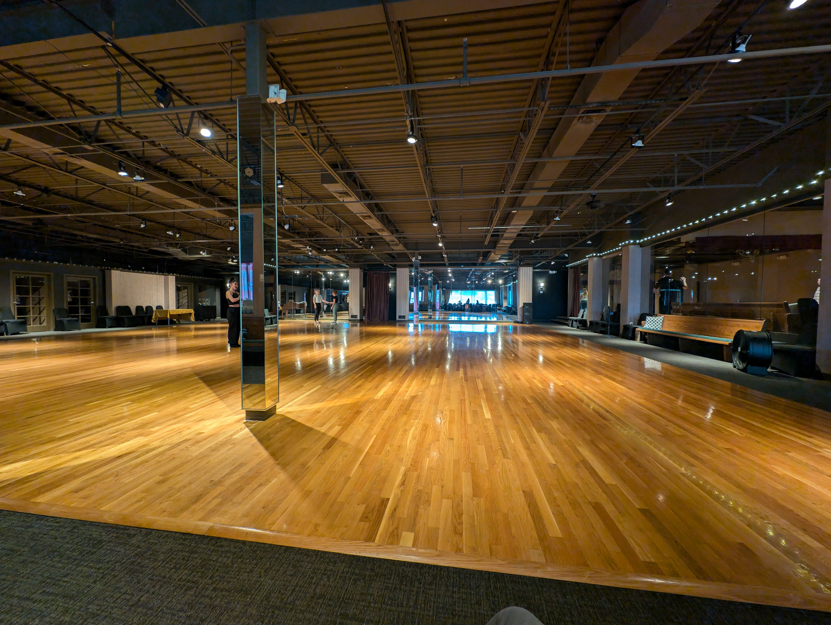

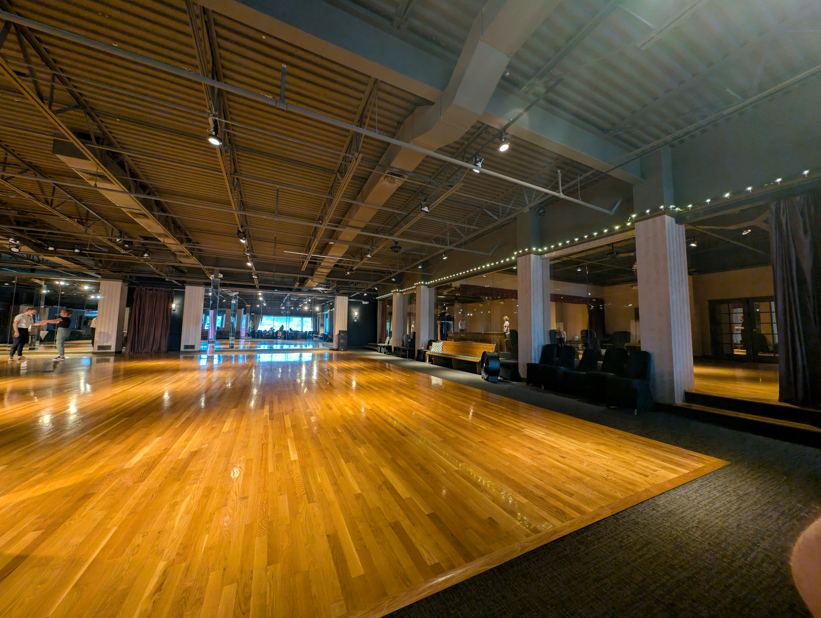

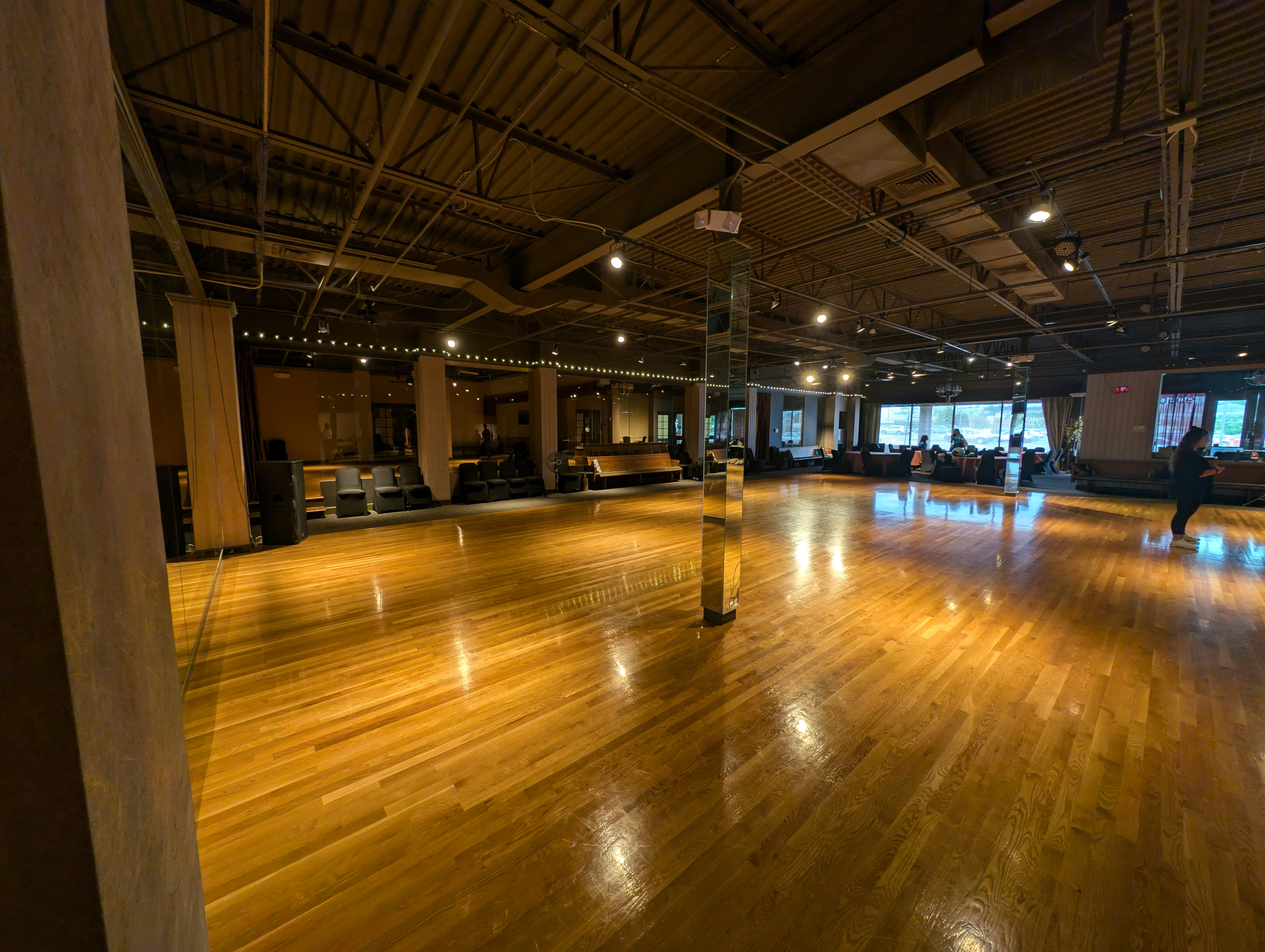

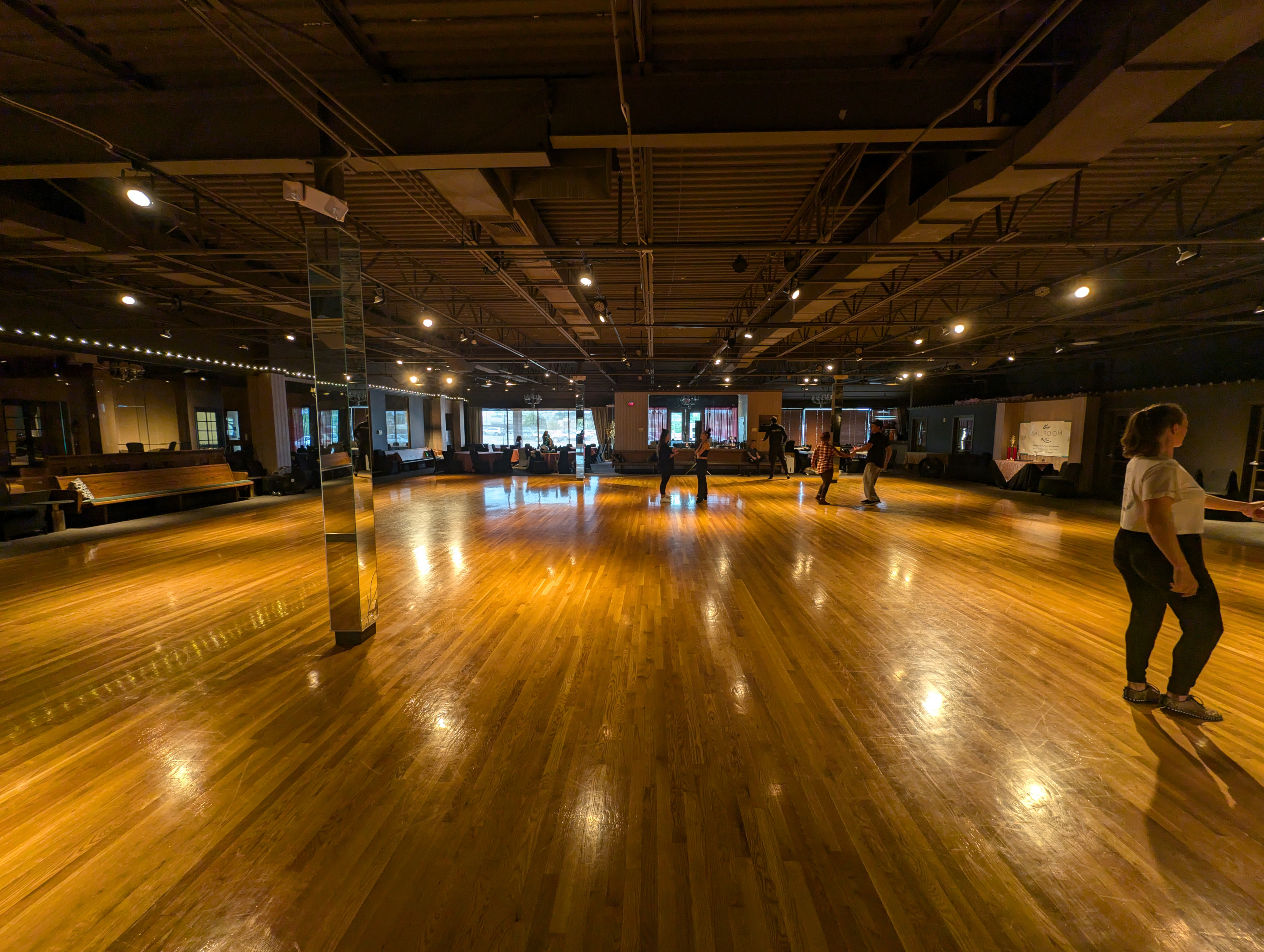

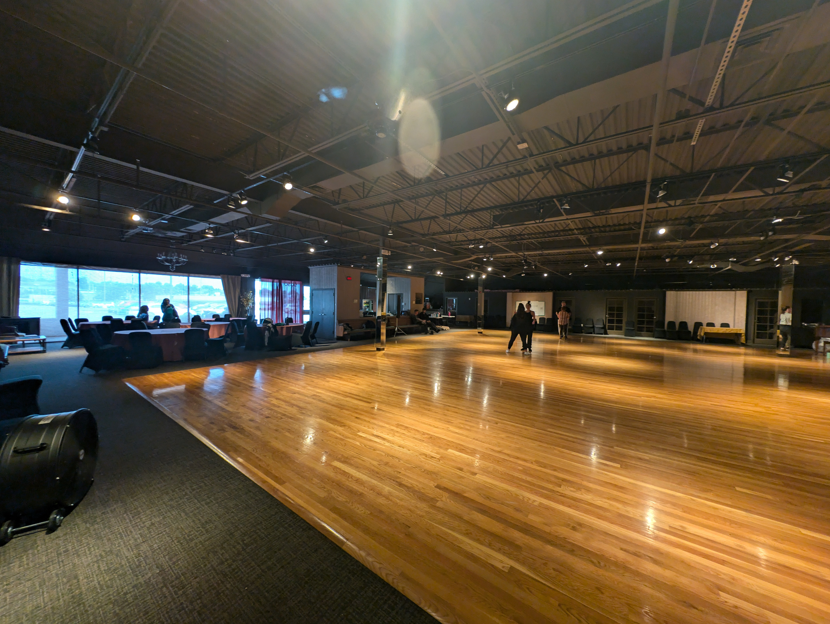

My wife and I dance west coast swing and our local ballroom needs a lot of help in the audio department. This ballroom hosts different types of dance including ballroom, salsa, WCS, east coast swing, and sometimes live music and dinner theater as well. WCS music is basically anything, but mostly it's modern pop, hiphop, RnB, some jazz, some blues, and a little bit of country.
The main dance floor is roughly 50' x 55' with space around 3 of the sides. The wall with the mirrors has a hallway behind it and does not extend to the ceiling.
On a busy night, the main floor can hold I'd say around 50-60 people at a time.
Here's some shots of the main ballroom:

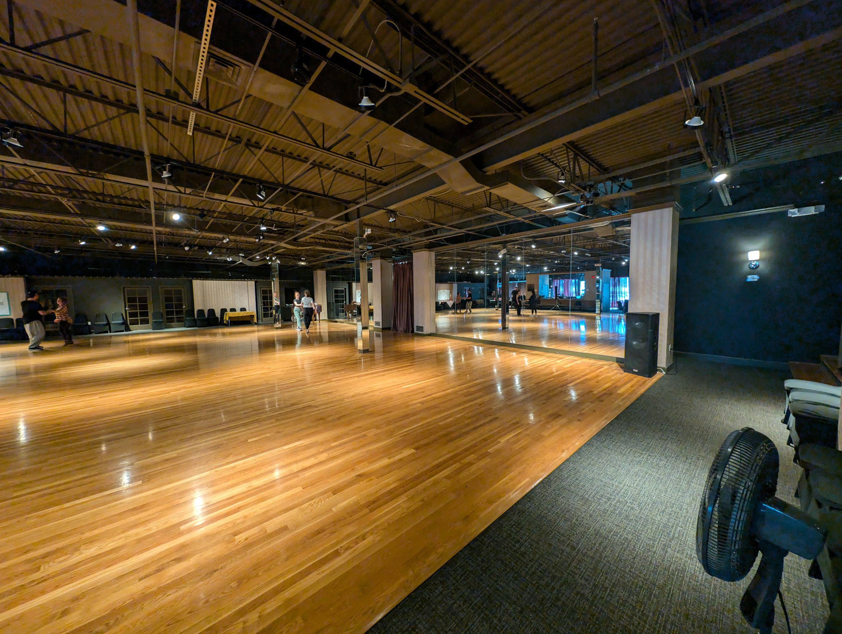

The current sound comes from two tower speakers at either corner of the floor (one can be seen in the images, the other is next to the piano) and a third speaker (Behringer Eurolive B215A) sitting on top of the wall to the left of the floor (kind of covers the back left of the floor). The tower speakers are QSC KW153s.
As you can imagine, the sound is....well....pretty bad. Muddy, muffled, hard to hear even when the sound is cranked up pretty loud (not club volume, but dance party volume).
I'd like to help this place out, especially since they operate as a non-profit so they don't have much in the way of disposable cashflow.
My immediate idea is to fly 4 Jack 115L at each corner of the dance floor. Would that be enough? Is it a terrible idea?
Thanks in advance for any input. You guys are far smarter than I am!

They need line sources, like TLAH Pro, or a large number of SLA Pro. For something resembling decent sound they need to make the ceiling non-reflective. There's no inexpensive way of doing that.

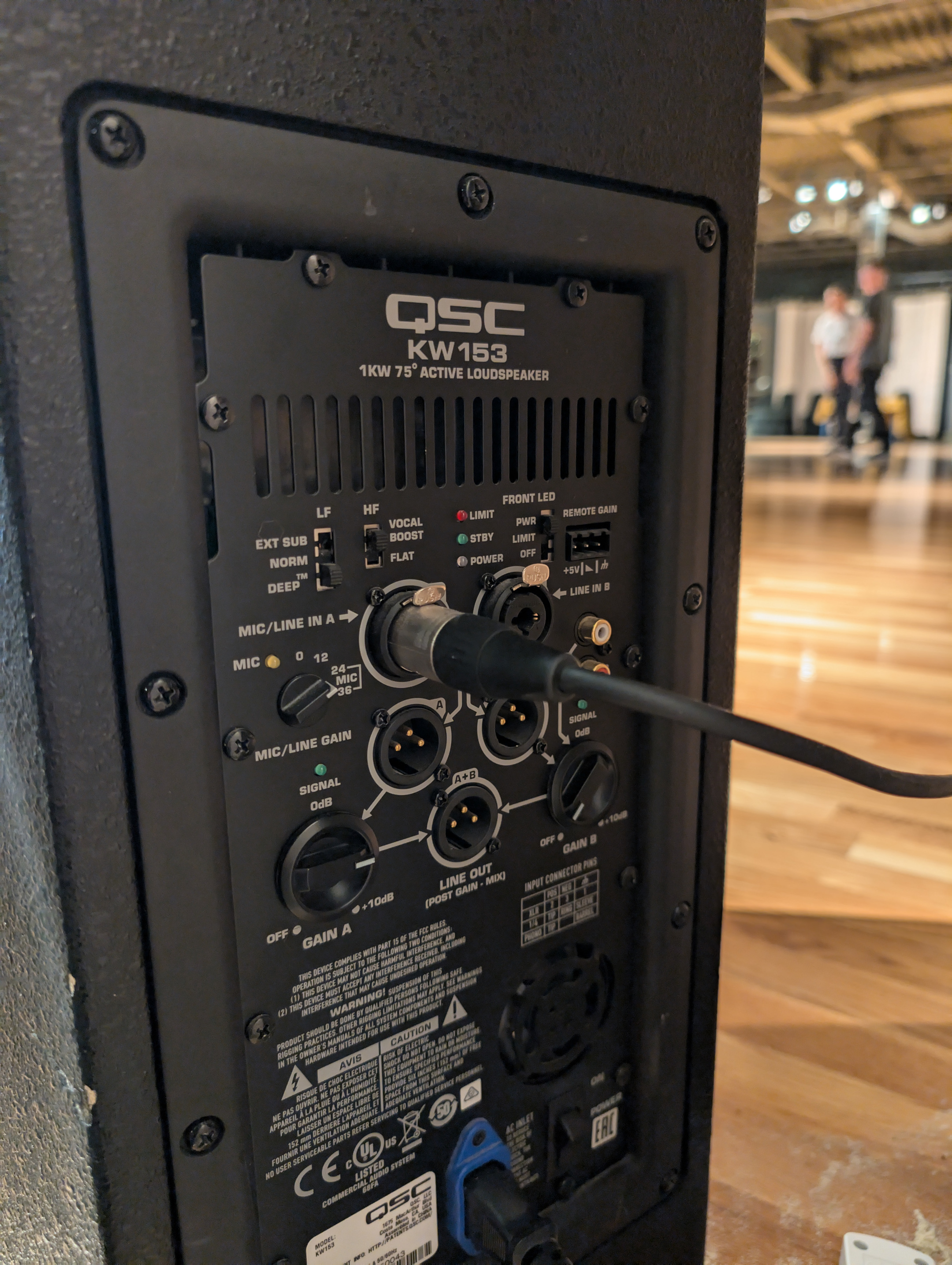

The first thing to do is configure that QSC correctly.
Take it off the Deep setting and set it to normal.
Set the input to line - NOT Mic. It's currently set to Mic - that overdrives the input stage if you are sending a line level signal. In fact, don't use the first input at all - go to the second one. It can only be run as LINE - that way, nobody can screw it up.
Turn off the Vocal Boost switch and put it at Normal.
That speaker has been set up totally wrong. I see this all the time with those QSC boxes - too many options and people always choose the wrong ones.
Those are good boxes and should sound great in that room. What are you using for a mixer? Is there any EQ?
When you use the Deep setting, that will engage a limiter to keep from blowing the woofer with the extra bass.....and with the input running hot on the Mic setting and the Vocal Boost engaged. You've introduced a distorted signal running through an internal EQ that engages a midrange bump for speech and limited the bottom end with the Deep switch. Fix those three settings and just turn up the mixer some.....and use an EQ to clean it up.
If you don't understand these fundamentals, building new boxes isn't going to solve the long term issues. See if you can get those boxes sounding good, then address a new system.

One issue with the towers that is causing a lot of the mud is that they're on the floor. So when people are dancing, bodies get in the way of the sound unless you're dancing in the "front row".

Certainly, getting 'em up in the air will help the clarity. The trade off will be losing some bottom end when you take away the boundary loading. If you have a sub, add that to the mix and put the 153s on stands. If you build any boxes, you're going to need some subs regardless.shane2943 wrote: ↑Fri Aug 23, 2024 9:06 am Noted! Next time I'm there, I'll take a look at those towers. They have a mixer but I doubt they have an EQ. I'll look though and report back.

Six to eight SLA Pro is preferable to two TLAH. Line arrays will make things better, but they can't work miracles. Treatment of the ceiling is a must if they don't want it to be an echo chamber. I wouldn't even consider subs without it.

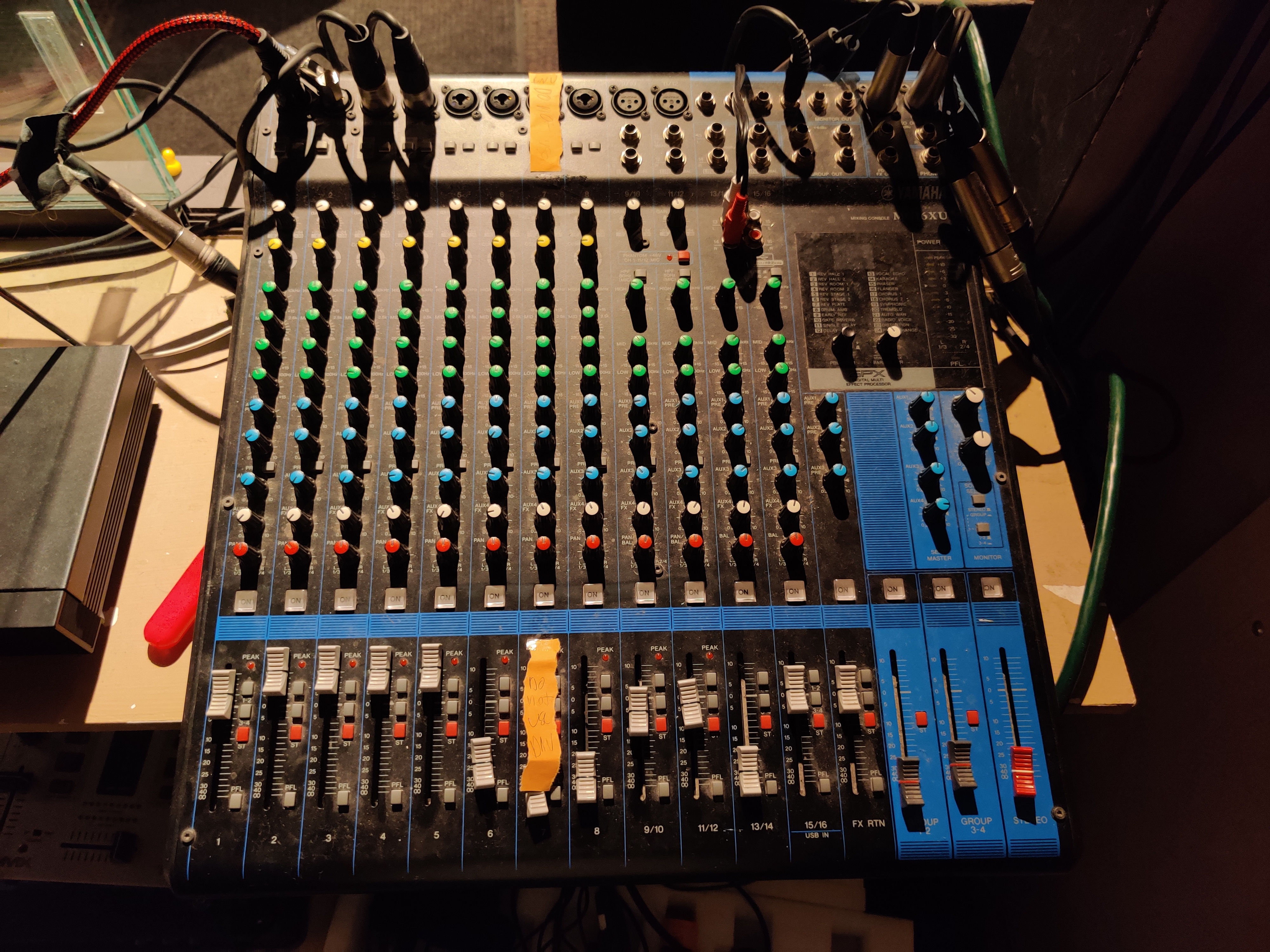

The signal chain is really simple: laptops and mics (no EQ) connected to a beat up Yamaha MG16XU. All speakers are powered so no separate amps. Speakers are connected to the stereo LR outputs on the board. Here's an image:

YIKES!!!! Gain structure!
Channel faders hammered and the Master fader barely cracked open.
Pull those faders down, turn the gains all the way down, put the Master Fader at -5 below unity. Then bring the channel faders up to about -5 below unity. Now, slowly turn up the gain on the channels to the volume you need. If a channel is peaking, then you may have to increase the fader and turn down the gain.
With good metering, you'd run the gains up to just below clipping, then add the fader - but, with only a clip light and making sure you have some headroom, I'd go with the fader first approach. Right now, you're driving the channels hard and barely letting anything out through the master fader.
Think of it like running cows through a bunch of pens, one leading to the other. If you close the last gate on the last pen to where it's just barely open and open all the ones before it all the way, the final gate gets too many cows jammed up trying to get out, creating distortion. But, if you open up the last gate (master fader) and the gate before that (channel fader) - then the cows you let in (gain knob), can run freely through the gates with no distortion.
That's a fine mixer and should do everything you need. I can't see the EQ on the individual channels, but that could be where some of the mud is. Start with the EQ controls at noon.
That mixer has sweepable mids - so, the two middle knobs control that. turn the bottom knob of the two (gain/cut) to about 9 o'clock. That means you are going to turn down some some frequencies. Now slowly turn the top knob (to the left most likely to get rid of the mud) and listen as you sweep the frequencies looking for the offending one. Once you find it, you bo back to the bottom knob and take more out or put a little back in depending on what it needs. I'm betting that somewhere around the 100-250hz mark is where you are going to find nirvana.
Remember, setting EQ is about getting rid of what sounds bad, not adding other frequencies trying to cover up the bad. In other words, if the sound is muddy - don't turn up the highs.....find the mud and get rid of that. That's what those sweepable mids let you do. Then you can season to taste with a little highs or lows, up or down as needed.
If you get proficient at the EQ on the channels and that doesn't get it done - then look into an outboard EQ. Based on the what I'm seeing in the fader setup - I would bet that the EQ is probably just as messy. Master the basics first before adding another layer of complexity.
