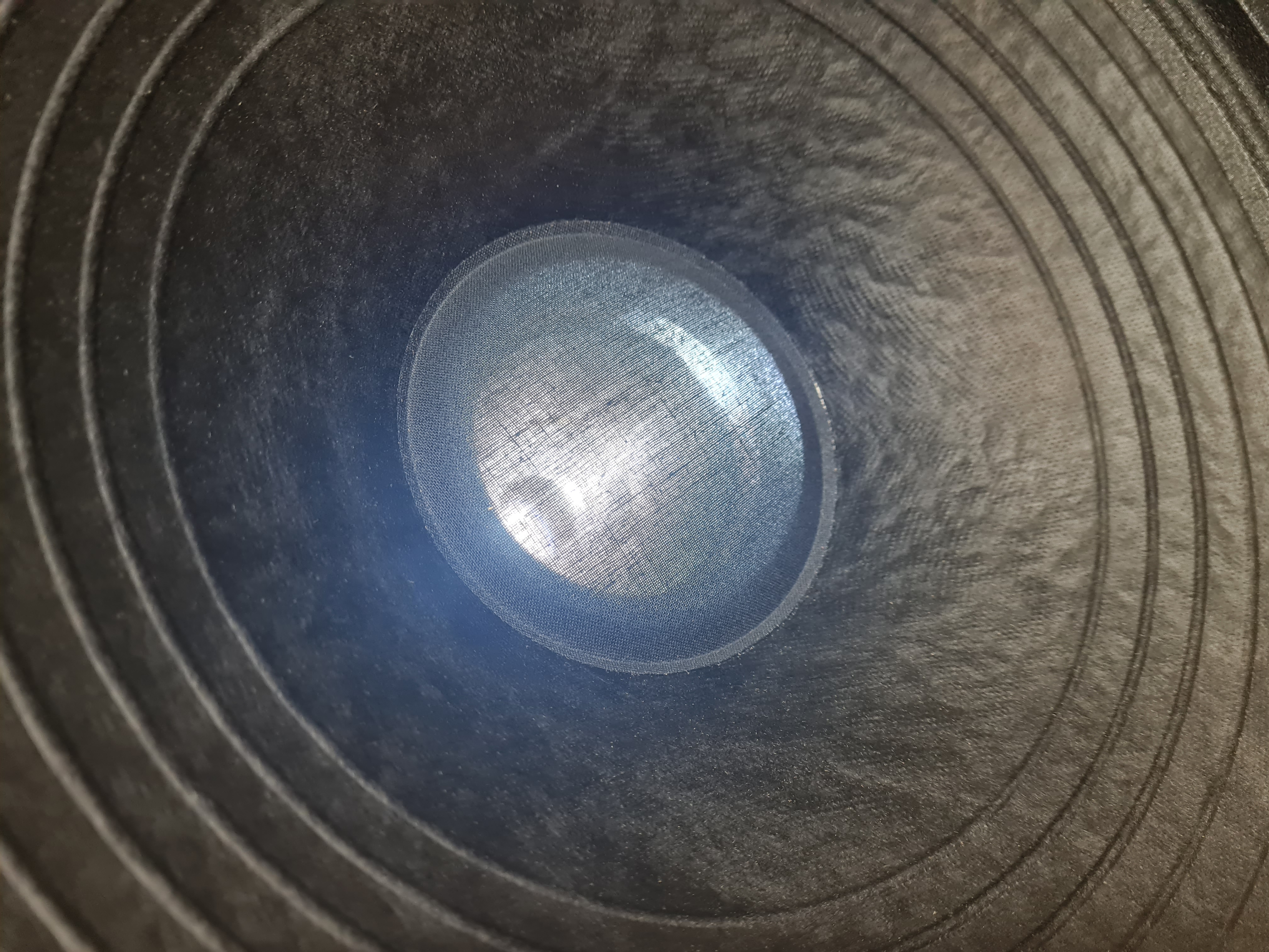

Would Eminence co-axial series Neo woofers like the KL3012CX-8 and KL3015CX-8 used without a HF diver, be unsuitable for DRs and Titans for the open rear of the magnet? The specs looks ok, but I'm off reservation.. could the HF driver port be plugged? :fingers:
Keryn O'Shea
Posts: 664
Location: Brisbane, Australia
Re: DR build questions
#20 Post by Keryn O'Shea »
Looks like we're going to find out.. we have to jump on anything close to spec here, so if it seems silly to try this, keep in mind we have no Parts Express, or anyone stocking practically any driver we need!
The cap is see through on the CX's as shown, like a glued/pressed fabric. If l look in the vent at the rear of the 3015LF with a torch l can see the back of its cap, could l glue a paper cap on the CX, fit mesh to its vent and give it a try? Adding weight to the cone... yes l know that's not the best, however l bought these new here for $300ea including freight.
Posts: 29146
I'd do just that.

The caps showed up finally, l used a Starbond rubberised CA adhesive from Hammeroo, the same guys who stock Unobond. Would two hours of 30hz at 12v be enough to see if they want to fly off?
Posts: 29146
#24 Post by Bill Fitzmaurice »
The normal break in would suffice.

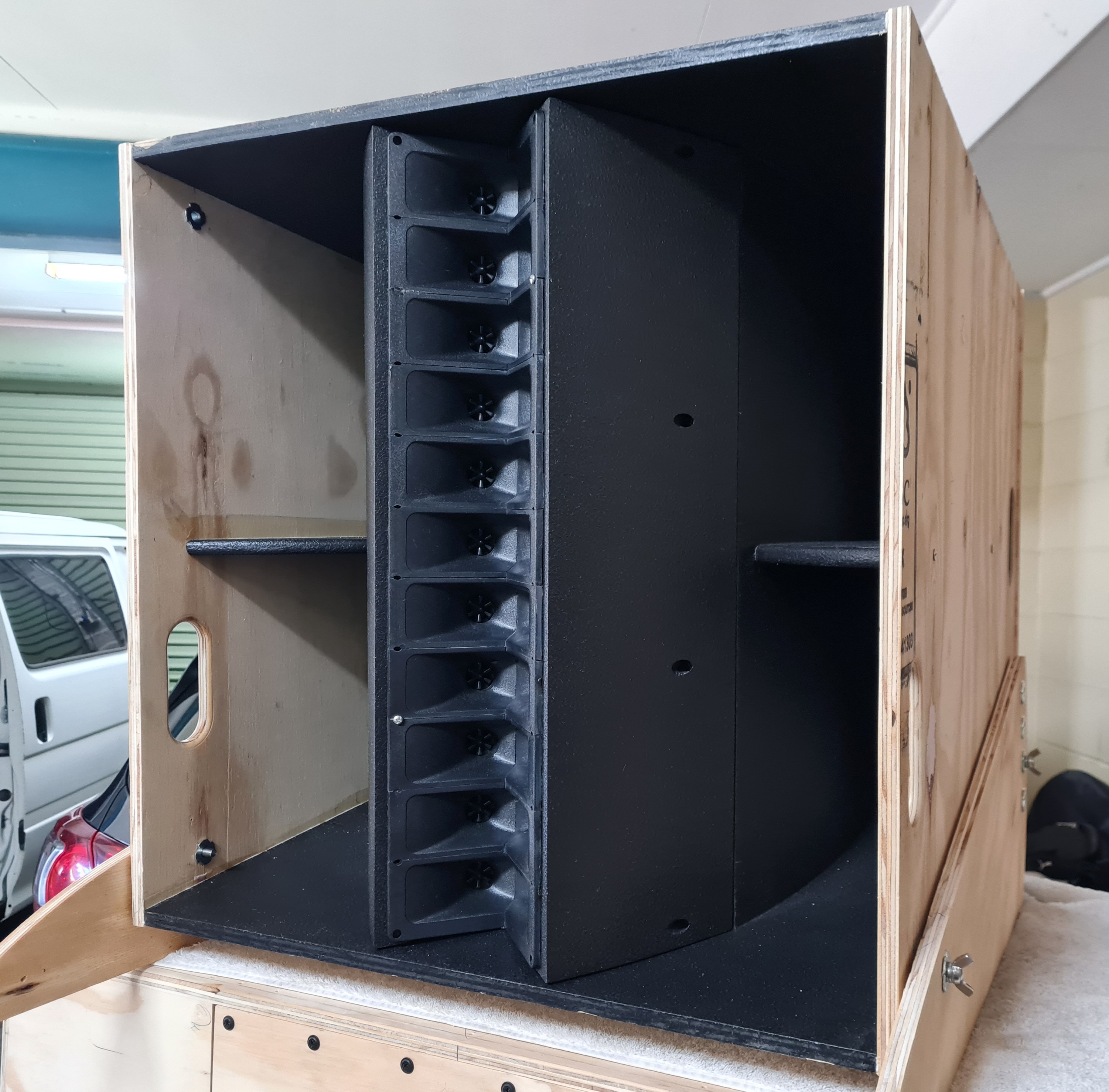

Ok will do, thank you. 1x DR and T48 operational, tested & working well, I'll paint the outside of all cabs in one go once the other 3 subs & DR are completed apart from diffuser and waiting on black mounting strips for the melded array. It was wicked to finally hear the 280, soo loud & clear! The DR handles on all four corners work well too, and to me don't look out of place. What do you guys think?
I bought a Dayton UMM-6 mic and downloaded REW, which should have happened 10 years ago, so I'll fit the KL3015CX in the next T48 built, (this one is 3015LF loaded) measure both and report back.

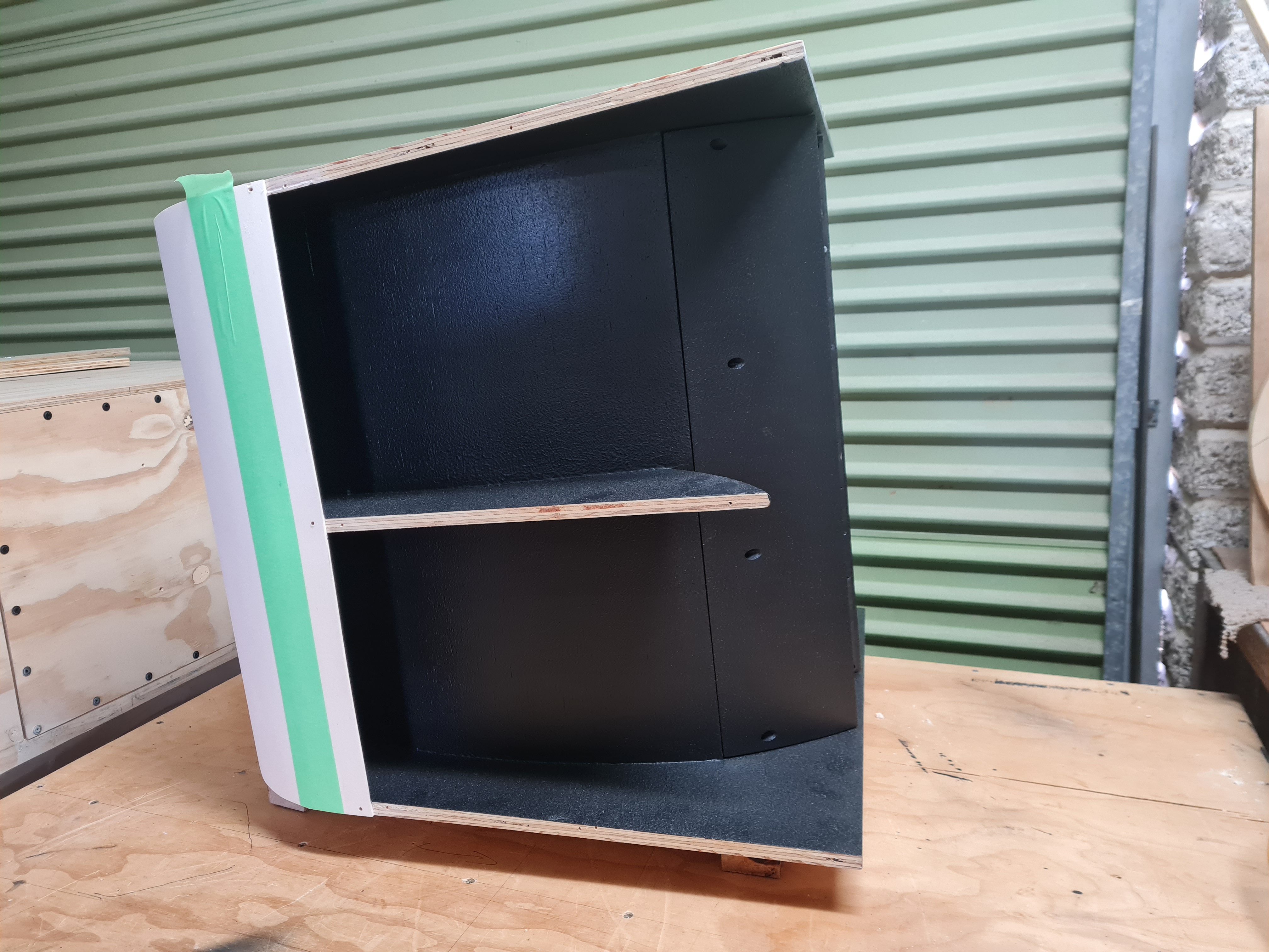

Thanks mate! Still a fair amount of finish work to be done yet. I'm looking for a way to protect the cab paint, and clear the plastic corners from the ground stacking brackets, I'm using large penny washers to space it away atm, that's why there's no bottom to the plate as yet.
Painting the cab from the inside as l go has been challenging also, duratex in the horn with three differently bent long handles and a cut down textured roller, then flat black sprayed on the inside of the rear panels before assembly.
