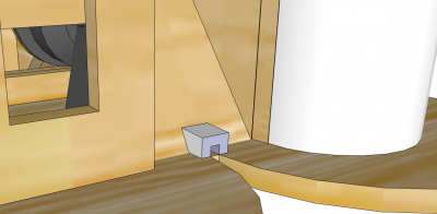

If I understand you correctly, you did something like this
Clever way to route them, somewhat incognito, without wires in the horn path. Pretty slick :thumbsup:

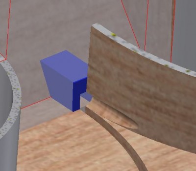

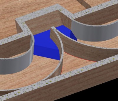

I wanted 100% PL around the future drill path. With the example you show, a 1/4" drill would cut through both curved backs right at the entrance to the channel. The tangent of the drill cylinder would be exactly on the edge of two 1/8 thick plys. And with wood tolerances, I'm confident it would break through somewhere, see my photo. For demonstration I made a simple square/rectangular wire channel 1/2 x 1/2 with 1/4 by 1/4 groove and showed the theoretical 1/4" drill into one of the curved backs. I removed the other to show the cylinder tapering out.
In the second screenshot the blue part is my 'wire channel'. I matched the reflectors and the taper to the horn throat Then I used my multi tool to carve the curve to match the buttcheeks. It's length is far enough past the 'crack' that I have 1/2" of air between the curved backs for clean drill through without breaking through. And the wood is over 1/2" thick where I drill through, so not breakout. I'll fill that drill through with caulk when the wires are in. At assembly of back curves I PL'd the whole crack, even filling the wire groove, knowing the drill will walk through that easily from the inside out. I should have enough 'channel' to guide my drill back out. I'm using a 1/4" x 18" long flex drill bit for that step.

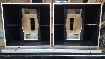

I have the mouths cleaned up. I removed any nails that shot out sideways. I used a nail set to sink any heads that were proud. I finished painting the mouths so they are starting to look finished internally.

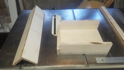

I started on the melded array jigs per the plans. I roughed out the wood shapes Friday and glued the base up for each. Today I cut the saw slots and put stops in. Maybe next weekend I can murder some piezos?
