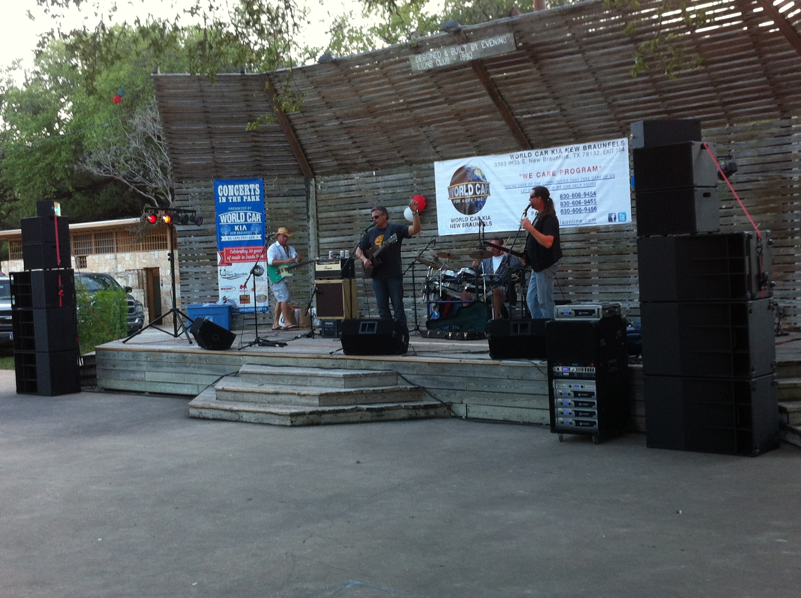

Bruce has 6 x T39 3012lf at 23 15/16" IIRC with Otops 12's and a T24 for drum fill if required, and places them based on coverage requirements...
The big shows in the park get the T39s ( 2-25" and 1-20") stacked on their sides split on the sides of the stage with the OT12s on top. I can get 'em about 48 feet apart. With a high pass of 47hz or so, there is a small null right in the middle of the crowd. But, the ease of setup and tear down is worth it.
Adding the 5th and 6th sub kinda' negated the v-plates, so this is a good solution for us.

The V Plate makes the horn path a bit longer, but its main purpose is to make the total mouth area larger, which increases sensitivity at the lower end of the passband. Adding more cabs makes the total mouth area larger as well, so there's a point where any additional area from a V Plate has little to no effect.The V Plate is most effective when you only have two cabs.

Bill Fitzmaurice wrote: Sun Aug 13, 2023 6:57 am The V Plate makes the horn path a bit longer, but its main purpose is to make the total mouth area larger, which increases sensitivity at the lower end of the passband. Adding more cabs makes the total mouth area larger as well, so there's a point where any additional area from a V Plate has little to no effect.The V Plate is most effective when you only have two cabs.
One summer, when I only had 4 subs, I'd V-plate two per side and put the OTops on stands. It worked fine, but the additional setup time in 100 degree weather on concrete made the ease of stacking way more palatable.
