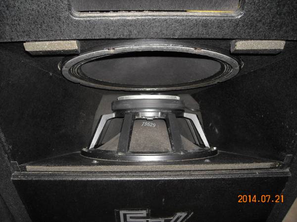

The current Tuba 30 is close to the old T36 in size/shape at least.
30"x30"x (16"-30") for a single 12" driver option. 30+" for a dual 12
Your drivers would possibly work to swap over, although I'm not familiar with the specific Beyma drivers you have pictured above.
Hi pass filter requirements on the T30 are at 35Hz or when used in groups of 4 or more, 30Hz.
I'm not sure on the T36 specs, the T60s were already out before I came around in 2010.

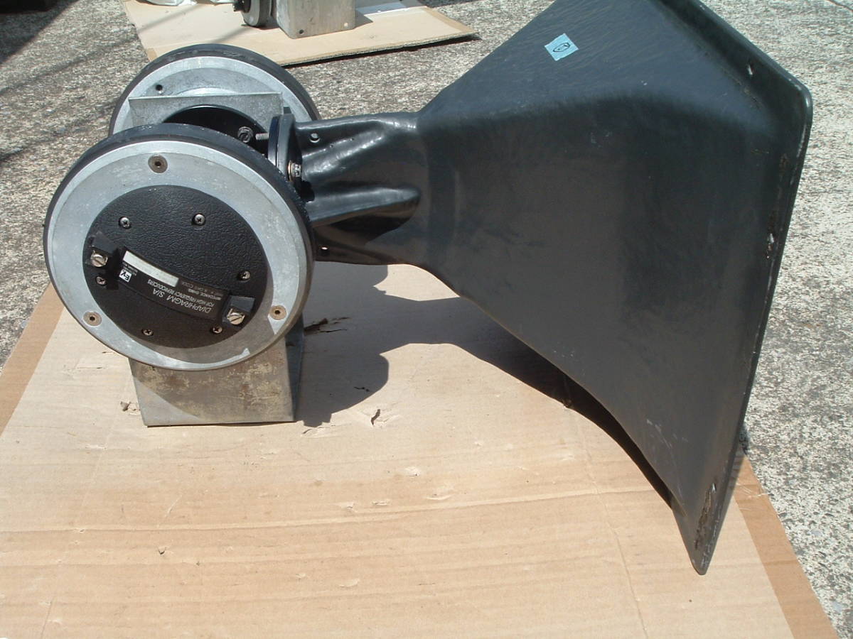

I run DJ sets outside in the desert most of the time with mono 2 stacks 20ft apart with couple double 18"s in the middle. i have EV double mids (old rare model) and EV Manifold Horns (loudest horns i ever saw). i have also an option to use 4 EAW KF850 as tops or 4 KF650 as tops with the 6 T30 each side. not sure yet what i prefer for now. i have also 6 KF300 that I'm not sure what i will do with them, they good for DJ monitor for now.
