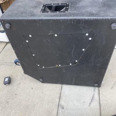

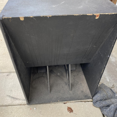

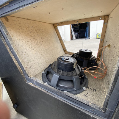

need help identifying this cabinets
- dimachertnik
- Posts: 6
- Joined: Sat Mar 25, 2023 1:10 pm
need help identifying this cabinets ita 27X36X36
i have 2 and looking to buy 2 more
- Posts: 29146
Re: need help identifying this cabinets
That's a T36. It was replaced in the lineup by the T60.

im looking to buy or build the another pair because of the size and looks of the cabinets. the size fits my mids and hi by size perfectly. The T60 way way way too long to fit in my needs and space provided.
- Posts: 29146
I no longer have a copy of the T36 plans but you could scale up the T30 by a factor of 1.2 to get a close approximation. That's how the T36 was arrived at.
