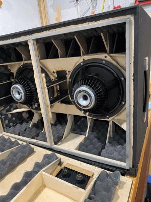

Thanks dude!Keryn O'Shea wrote: ↑Fri Dec 02, 2022 3:10 am Wow man, that's so precise and gorgeous!! How did you paint inside the throats?
Well, I took a calculated risk with the finish. It was rattle can truck bed liner. Only found a few reviews that were used on trunk woofer boxes. I figured that if the adhesion fails it will all come off in chunks, be easy to clean up and recover with something else. If the adhesion holds, then.... great!! It was quicker and easier to spray vs rolling. Side note: it went on thin and drys quick. Took 5 cans. I did touch up the back of the throats with regular spray paint by spraying a puddle in a container and applying with a foam brush. Managed to drip a little on the grill cloth
So far its holding

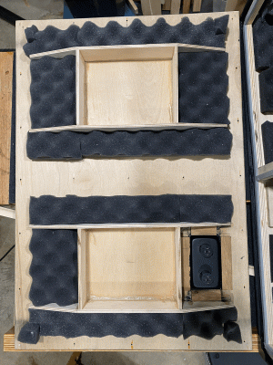

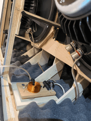

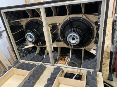

Foam and speaker mount done.
Haven't decided on using the LP filter yet. I will be playing a jazz bass with it that I enjoy the highs. But the intent of this cab is to be used in a band mix so maybe getting the most out of the mid range with the filter is better? My amp head does have a treble boost switch on it too.
Ready for wire. Getting closer

Re: J210 Lite Build
Damn, just realized I made the back braces to wide
Bill, should I fill it in to make the 6" wide dimension?

The woofers will play higher without the filter, but the high frequency dispersion will be so narrow that unless you're directly in front of the cab you won't hear it. This goes to the reason for having separate low frequency and high frequency sources. It's not about bandwidth, it's about dispersion.Clef's of Bass wrote: ↑Sat Dec 03, 2022 9:04 am Haven't decided on using the LP filter yet. I will be playing a jazz bass with it that I enjoy the highs. But the intent of this cab is to be used in a band mix so maybe getting the most out of the mid range with the filter is better?

I see. LP filter it is then. Better to get the midrange gainBill Fitzmaurice wrote: ↑Sat Dec 03, 2022 10:07 amThe woofers will play higher without the filter, but the high frequency dispersion will be so narrow that unless you're directly in front of the cab you won't hear it. This goes to the reason for having separate low frequency and high frequency sources. It's not about bandwidth, it's about dispersion.Clef's of Bass wrote: ↑Sat Dec 03, 2022 9:04 am Haven't decided on using the LP filter yet. I will be playing a jazz bass with it that I enjoy the highs. But the intent of this cab is to be used in a band mix so maybe getting the most out of the mid range with the filter is better?

Re: J210 Lite Build
It probably is okay but, if you want, you could add some gussets inside against the cross braces of the back braces, to fill in the need. 2" high, 2" long with the diagonal 1/4" away from each.Clef's of Bass wrote: ↑Sat Dec 03, 2022 9:16 am Damn, just realized I made the back braces to wide

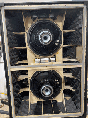

Re: J210 Lite Build

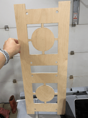

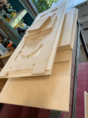

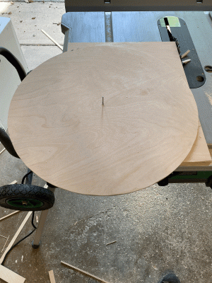

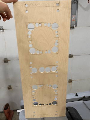

Few more build pics. These were buried behind some vaca pics on the phone.
Side note on the table saw radius jig sled: Shave flat edges first, do not rotate the piece on the blade until enough material is gone that it doesn't extend to the opposite side of the blade. If you rotate with too much material left then it will pull the blade (not good).
Re: J210 Lite Build
Well now I am really curious. I have seen that sort of circle jig on the internet, but have never tried it. So far all my circles have been done with a router. Does it have an advantage over using a router?
Also curious how you cut out your baffles. You got rid of most of the excess material, which suggests that you used a router to do the final cutting...but the corners are sharper than you'd expect with a router...
