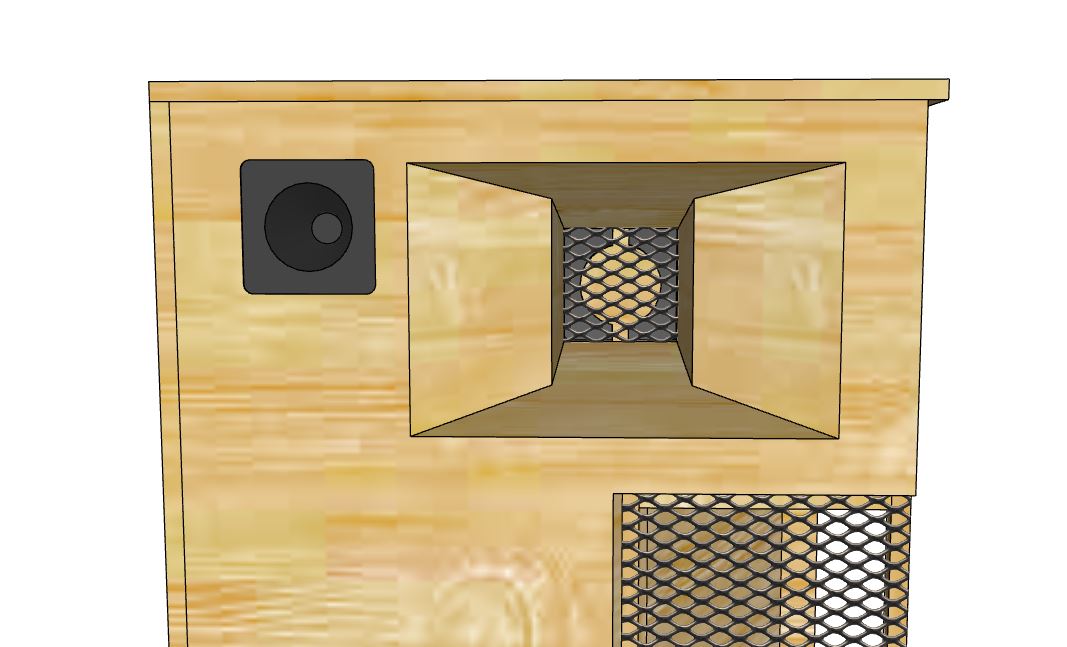

Ok, all the REAL Baltic Burch has been cut and sanded for assembly.
While the woofer doubler ring was gluing up I started laying out the mid and tweeter on the face.
I was going to use the APT 150 horn instead of the 80 as this will be a PA/recorded music speaker only..
Looking at the 7.5" wide flange of the tweeter and the 11" opening of the mid its getting crowded on the 19" wide front panel.
Any suggestions as to the optimal layout, plans say
"The tweeter and mid horn mount side by side on the cabinet front. Mark the holes as high on the cabinet as possible. Place the mid horn on the cabinet front, tracing its location. If you don’t use a tweeter center the mid horn as high as possible on the cab front. "
Are there any rules as to how close the mid horn and tweeter can get?
Weldon Carter
- Posts: 29041
As close as possible.
