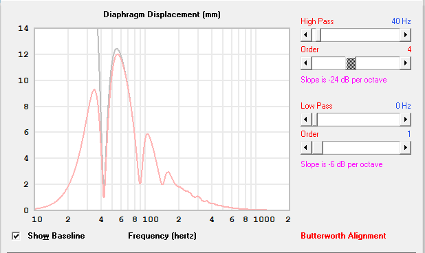

The voltage limit of a specific driver in a specific cab is derived by using modeling software. Hornresp is the software most use to predict the performance potential of horn loaded speaker cabinets and drivers used in them. The program calculates various performance parameters of the driver and enclosure. One of which is diaphragm displacement, sometimes called excursion. It's the distance the cone travels in one direction from it's at rest position. With identical input voltage, the excursion varies widely throughout the frequency range. The voltage that causes the cone to move the furthest at some frequency without exceeding the driver's Xmax rating is what we consider to be the maximum safe voltage. Unless the driver's RMS power/voltage is less, that's where we limit the voltage.
I've reverse engineered Bills cabs from the SketchUp files and entered the dimensions I've taken from that into the program. I assume the dimensions I use aren't exactly what Bill has used. I do believe they're close enough to get a reasonable idea of how specific drivers will behave in the cabs though. And Bill, please step in and correct anything in need.
Here's your driver's diaphragm displacement in a 36" wide T48 with 95 volts, using a 24dB Butterworth highpass filter set to 40Hz.
Displacement crests 12mm just below 60Hz, the driver's Xmax is 12.1mm.
So, you can put more into it. And you can probably do it safely. But, the gains to be had after that point are slim. At less excursion than Xmax, the cone movement is fairly linear and doubling power typically net's an additional 3dB in output. But, beyond Xmax, cone movement is less and less linear and doubling power will net less than 3dB. There's less coil in the magnetic field to translate the voltage into cone movement and the cone's suspension becomes increasingly resistant the further out the cone is. So, you get less and less output the more you increase the voltage beyond it's designed useful limits. That's typically what leads to driver failure, especially with horn loaded subs, because they sound so great and don't exhibit the audible que's direct radiating subs do when pushed too hard. Louder, louder, louder, pop.
So, we limit voltage at Xmax and that's how I came up with 95v.
