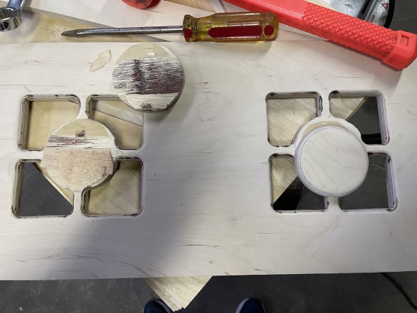

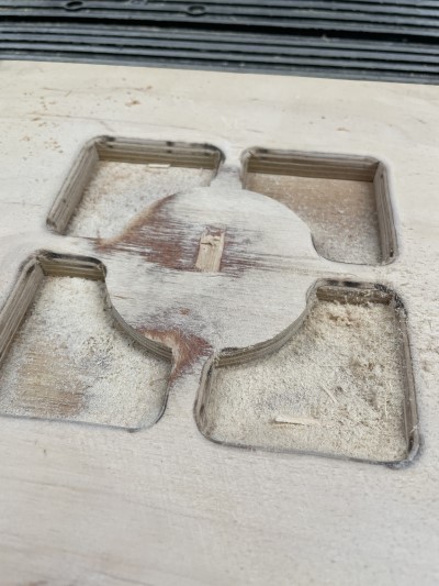

Woofer spacers
:cussing: I set these down and put some 5 lbs weights on them, but they slid :chainsaw: PL works really good :roll:
Nothing a little belt sander can't fix

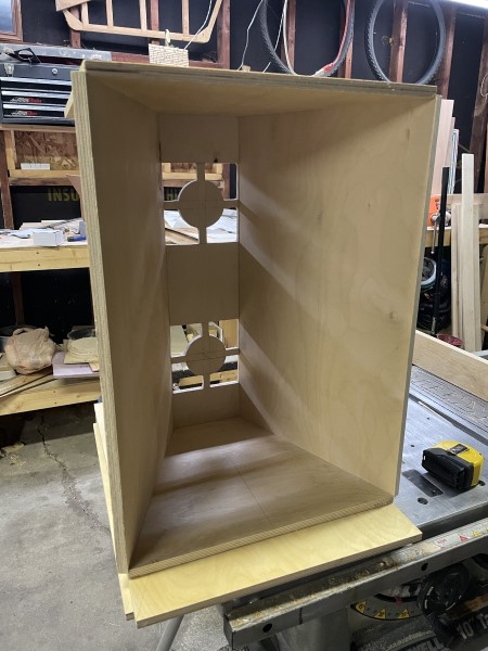

Could not be happier with the progress tonight! I test fit the pieces and everything fits reaaal nice!
Actually fit so good, i was able to pick it up as seen here.
I will have to do a bit of clean up on the edges were the woofer holes meets the horn. Nothing a Dremel tool can do.
Should look like a could of speaker boxes tomorrow.

A few more photos.
Test fit all the driver hardware, before glueing the top and bottoms, glued top, bottom and horn sides. I did the horn to side braces after the fact, so I could trim to fit.
Tacked on the skill saw guide and trimmed off the horn sides, not as smooth as I was hoping for, should if used a better blade, nothing some wood filer and black paint can’t fix. And finally test fit the sides! Starting to look like something!
