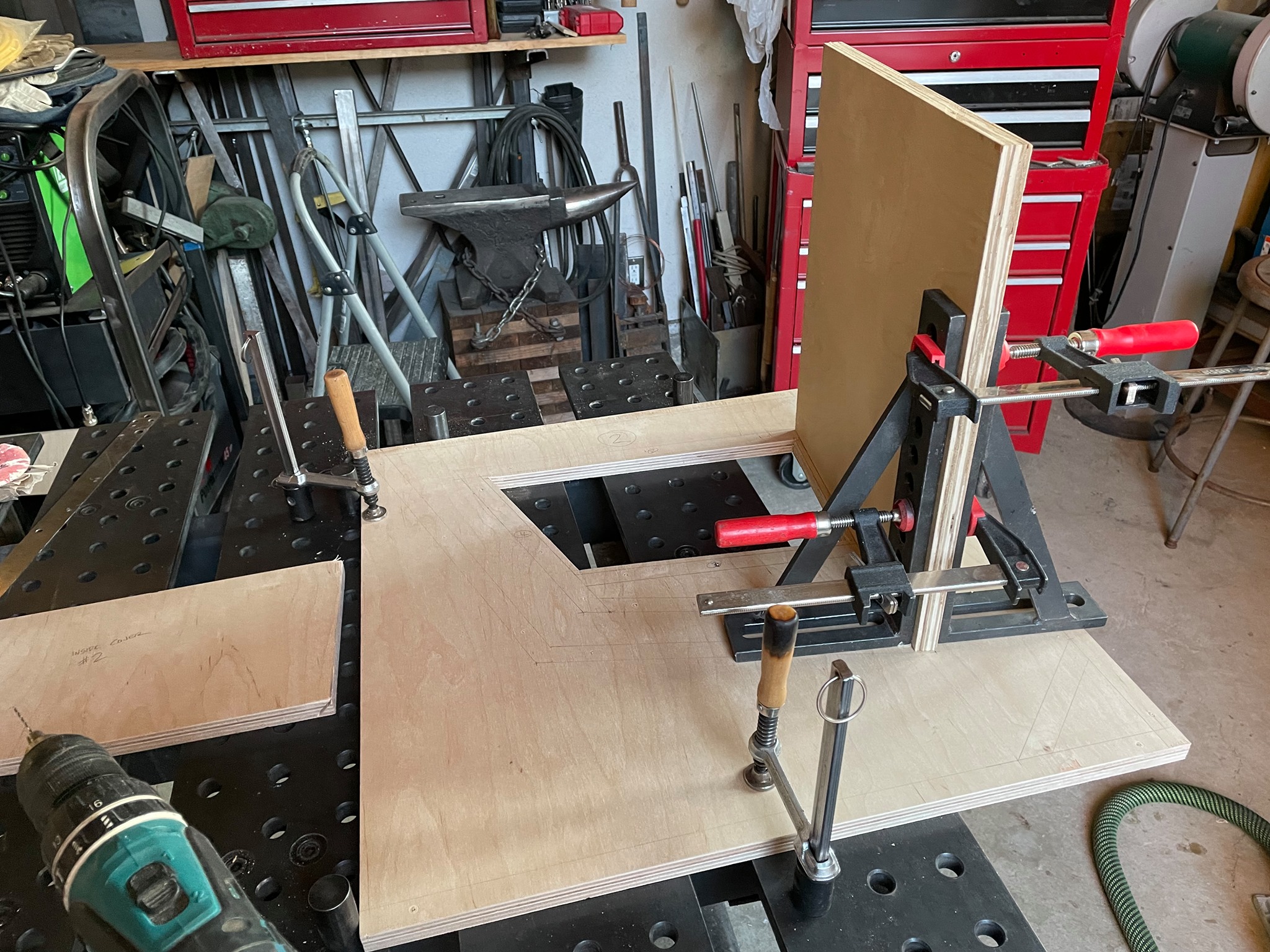

This pic is for the welding table and jigs. I didn't plan on using this for woodworking, It sure makes things easy and square tho.

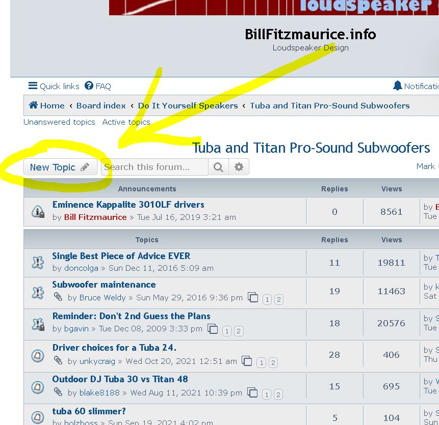

unkycraig wrote: Wed Oct 27, 2021 12:29 am I have only seen the "NEW TOPIC" button once. I keep scrolling thru menus. I can't find the dang button. So I tapeworm onto old threads. Any clues to a fresh post routine?
For me the New Topic button shows near the top left whenever I am browsing any particular sub forum.
E.g. if I am on the following page:
Tuba and Titan Pro-Sound Subwoofers
Then it sits in the top left corner, just under the crumb trail "Home > Board index > Do It Yourself Speakers > Tuba and Titan Pro-Sound Subwoofers", just left from the "Search this forum..." box.
See below:
New Topic
New Topic
