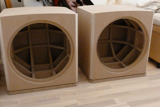

Very pretty...but can they fight?
In this case, not really. Far easier to build panel to panel braces will work considerably better. The purpose of bracing isn't to stiffen panels a bit, it's to make them inert. Braces that connect opposing panels do that better, using less material, than any other method. Spline bracing is OK if it's the only alternative, but that's the only time I use it. Bracing that comes within a few inches of the box corners is wasted material and unnecessary weight, as that's the strongest part of the box.
