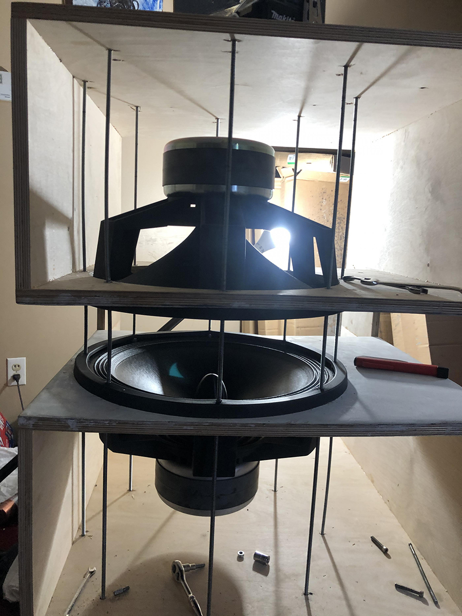

HI all....I have a sub I am trying to tie up my loose ends with....it is a sealed box of the PushPushSlotLoad variety....I have 2 18s facing each other in the slot and threaded rod going from one side of the box to the other mounting the drivers....Potentially overkill in that area...but....oh well....
I have come to understand that the majority of vibrations come from direct contact of the drivers to the baffle....the force cancellations of the opposing woofers should take care of most of this one would with....the way the bracing is setup so far with the threaded rod...the baffle directly behind each woofer should be about taken care or close to it.....but there is a back baffle that I need to address...the top baffle are skinny and likely are fine without additional bracing....

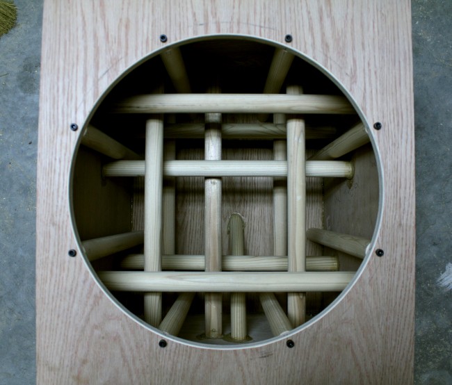

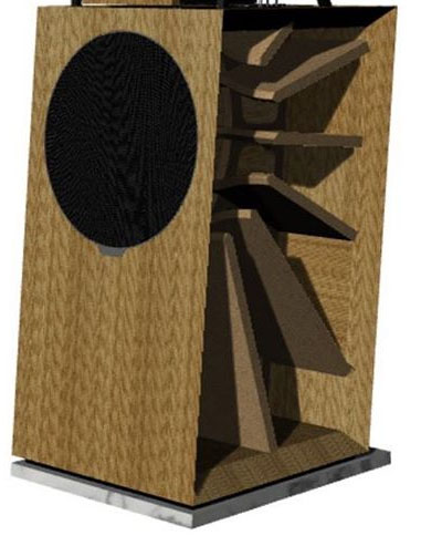

I can have come to believe that matrix bracing and what I call TL style bracing is the best. M atrix bracing, I think everyone here is familiar with and TL style bracing is just inspired by the bracing cause by folding a line, like you guys do with your horns.
In regards to matrix bracing....does anyone know what the baseline spacing is? A brace beam every 4" maybe?
the attachments show my bracing start so far, and examples of matrix bracing and what I call TL inspired bracing or atleast one iteration of....for a sealed cad one could build a 1/2WL closed transmission line, folded, for the same results.

The middle picture has way too much wood for braces...I wouldn't want to carry it. If you look at shelves or inside cabinets, you will notice that a brace along an edge is between 1 and 2 inches (wider is better). That same idea could be incorporated inside the cab.
The lower pictures shows dowels near a side panel, but, that would be a case of overkill. Only the top/bottom dowels would be sufficient for the baffle.

OK wait I think you are talking about the full width boards...You are probably used to seeing holes and such cut into the bracing or dowels etc...pros and cons... in the above example each full plane of bracing breaks up resonate modes into higher less energetic notes...if its worth it? I don't know...Tom Smit wrote: ↑Mon Apr 12, 2021 10:33 pm The middle picture has way too much wood for braces...I wouldn't want to carry it. If you look at shelves or inside cabinets, you will notice that a brace along an edge is between 1 and 2 inches (wider is better). That same idea could be incorporated inside the cab.

Perhaps the most obvious thing to point out with the second and third pics is that their bracing reaches all panels, not just the sides, but front and rear as well, and the brace planes are not points, and the second pic also extends to contact significant lengths of each panel.
Yours, and the third pic, contact at points on the panels only, and I would think that may be insufficient.
The idea of bracing, is to prevent whichever panel it touches from flexing (regardless of what causes that flex) over significant area of that panel, as flex robs output by up to 3dB.
It's also irrelevant which way the panel flexes, either out or in, as that is still flex.
To that end, you would need to add lock nuts internally on the threaded rod to achieve that, even then, the rod itself will flex...

Each rod goes through a threaded insert at every baffle...locknuts hold the woofers, there is a good amount of tension on each rod, but I get your point. I've got to figureout how to keep the rods from ringing at this point...I'm hoping tape will do.
Thanks to the bracing provided by the threaded and my new info regarding brace spacing (8"-12" separation) The side panels are near finished...The top/bottom baffles are 12" wide so, bracing is not needed there. I think a few cross members and some ribs jutting out several inches from the back wall running top to bottom will take care of the back baffle which is 32Wx29H...the front baffls are 12" wide and so no bracing needed there either.

On the bracing the last picture is the best scheme. Six inch spacing is adequate.
