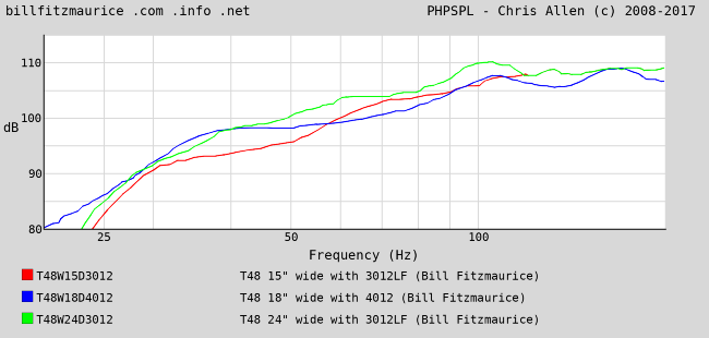

Josh, are you limited in transportation space so much that you can only do the 14"? (I haven't looked at your other posts). Here is a graph to show how much more one can get with more width.

this wasn't clear for me that this would make such a huge difference...
Thank you very much.
I know that it would be much better if I would go wider to get the most out of each driver. My initial plan was to build a double twelve but decided to build splitted for easy transportation.
Because if I go to a width of 24" I could equip with a fifteen but the 3012LF I have four on my shelf
I will play a little with the SPL Tool and maybe choose a different width.

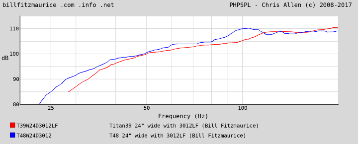

I find interesting that the difference between the T39 and T48 isn't huge if you calculate with SPLmax with the voltage limits written in the plans:
EDIT: added two T48, 15" wide with 3012lf under SPLmax and T48 24" wide with 3015lf under SPLmax]

If you
can go 24, do it. And use the 12's. You'll not be disappointed.
At 40Hz, a single 24" is nearly the same output as two 15" wide cabs.
Put another way, if the driver could hypothetically take it, it would take nearly 1200watts in a 15" wide cab to match what a 24" cab will do on 300 watts at 40Hz.
But, if you absolutely need/want a slim cab for ease transport for smaller gigs, do that. They are still stellar performers and they can still be added to the stack of wider cabs for larger gigs.

jemo1234567890 wrote: ↑Tue Jan 19, 2021 4:16 am
They are similar. Except the T48 keeps the driver loaded for a little more allowable extension.
I think these are measured results (instead of estimated)

Posted: Tue Jan 19, 2021 4:57 am
by jemo1234567890
Seth wrote: ↑Tue Jan 19, 2021 4:50 am
Where did you see that file/code option?
Just added the faktor in dBs
