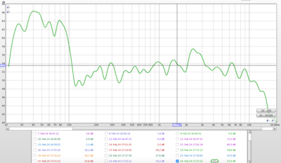

So we placed an RTA 1 meter from the center point between the JBL and B&C, muted the subs and started with sweeping and and examining each xover type. By looking at the REW plots it was clear that the Buttersworth 12dB filters made the most sense for crossing the B&C to the JBL in these cabinets.
We then proceeded to use the Ashly DSP to get a +/- 2.5dB response from about 100Hz to 10kHz for each speaker. These horns are really tapering off the JBL driver at that point. We ended up adding a high shelf to get a little more energy up there and it still only added a couple dB. Now, I realize this wasn't recommended necessarily and doesnt compare to doing this in a free field.. BUT. We unmuted the subs and WOW. We listened to the reference track at this point and it was the best I'd ever heard it. Then we listened to one of the tracks I'm most excited to play in my set this Saturday (https://deepmedimusik.bandcamp.com/track/avet) and it was Jaw On The Floor Mother Of God stuff.
We then pointed the RTA at the center of the moth of the sub just to see what it looked like.. interesting.. probably worthless data though.

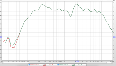

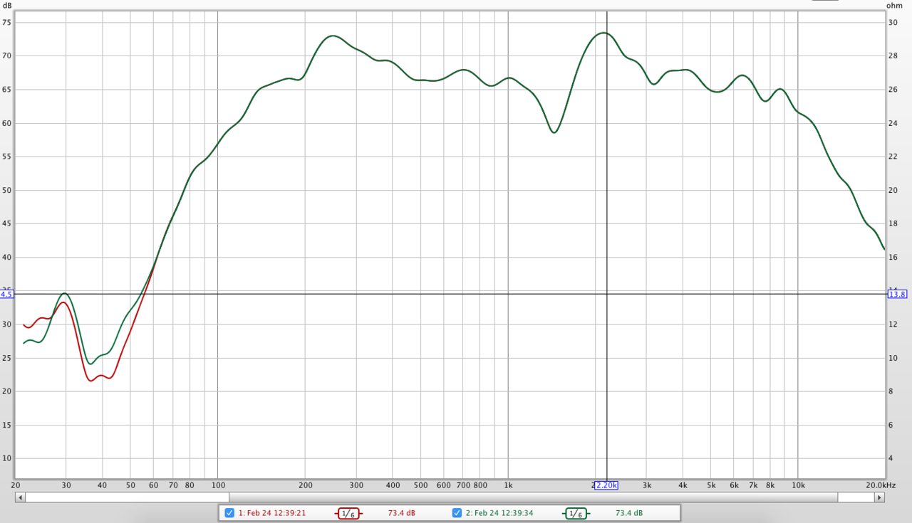

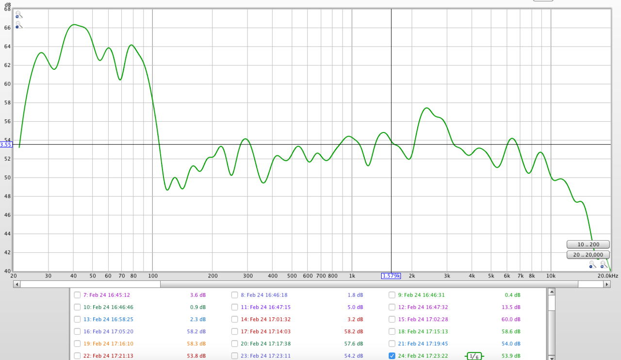

You're first screen shot is probably the room.5meohd wrote: ↑Tue Feb 25, 2020 11:02 am Listened to my reference track (https://blkrtz.bandcamp.com/track/aint- ... -feat-fink) and decided that it was nice and of course still needed work. All graphs are 1/6th smoothing.

When you slip in the BSS, try a -3dB notch at 250Hz and 2.5K.
Check your REW settings to see if it's set to equal loudness curves (if yes, turn it off) or has weighting (eg A or C). If you can, turn all weighting off.
I'm a little surprised at subs response, but again think it's the room or some setting.
Measure subs from further away.
You may be getting some rumble from the subs. Have you ever run through all your tracks and actually worked out how much LF energy is there, and how low? If you can raise the T60's up from 25Hz because there is no content there, that's going to be a good thing.
Later, one day, run your songs through something like audacity, which let's you examine frequency content. Then you'll know.
In order to protect your Jaybee's more, try this, and if it sounds ok, use BW24 on their high pass rather than BW12.
Other than that, the first tweak after initial setup brought about the most significant improvement from a listening perspective.
That's where I'd stay until I actually worked out exactly what's going on...
Re: Trying to dust the cobwebs off.
Can you elaborate a little on the surprise of subs response?
the first chart is with subs muted. I think I failed to mention that. Sorry.

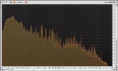

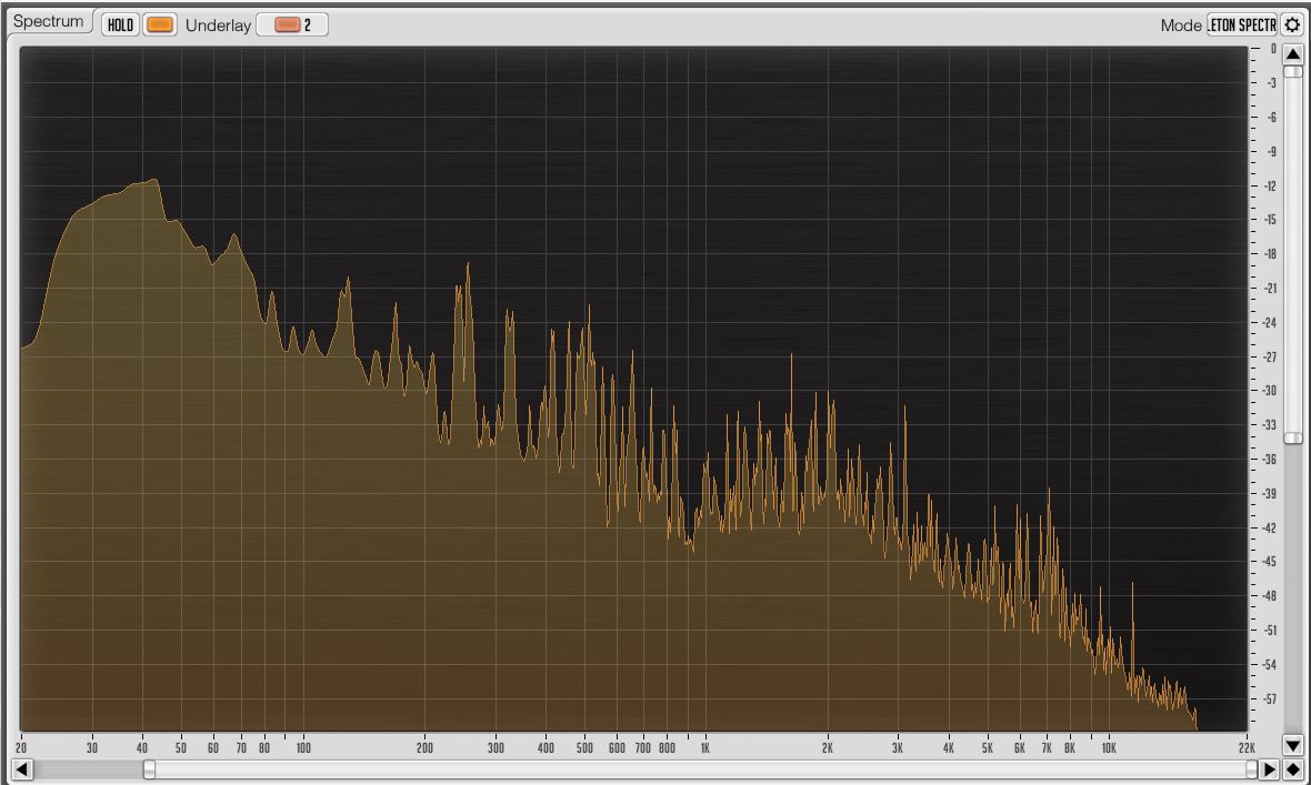

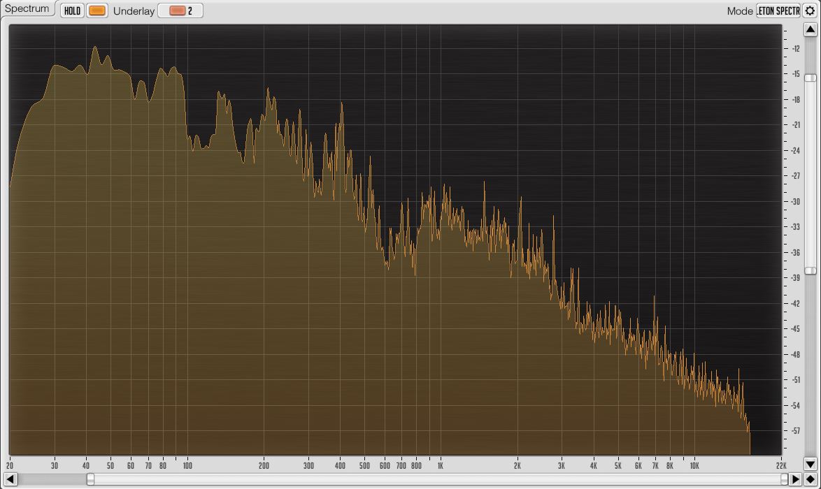

I'm curious about the HPF setting on the subs. I'm looking at tracks with Voxengo Span in my DAW. I do see sweeps dipping to 22-25ish.. but of course the fundamental notes of the tracks are mostly 30 and up.
Is the recommended HPF setting in the build doc? I want to make sure I'm getting as much energy potential as possible.

Yes, it's in build doc. "High pass filter at 25 to 30Hz". Speaker cabs are not headphones. Don't lower the HP.5meohd wrote: ↑Wed Feb 26, 2020 12:02 pm I'm curious about the HPF setting on the subs. I'm looking at tracks with Voxengo Span in my DAW. I do see sweeps dipping to 22-25ish.. but of course the fundamental notes of the tracks are mostly 30 and up.
Got it! I dug out the old doc and read through it. Been a while.

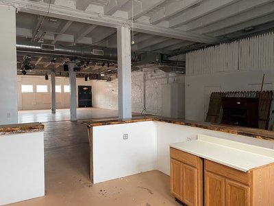

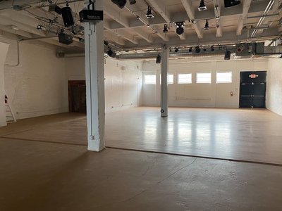

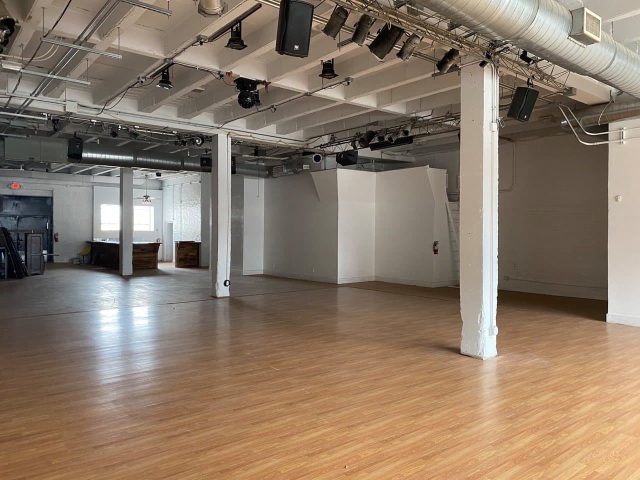

Getting a head start here... What do you think would be optimal placement for 4 T60s in that space?
Looks to be about 50'x100' with 15' ceiling. +/- a few feet.

First spot I'd try out... First pic, corner loaded in the corner to the left of, and on the same wall as the door.
How much room is in the corner to the left of the doors in pic 2?
Have you heard of the sub crawl?
That corner is indeed what I was thinking. Would you try to stack all 4 subs vertically facing the corner? Or put them in a cube orientation? I wish the sub placement sticky had T60 guidelines...
