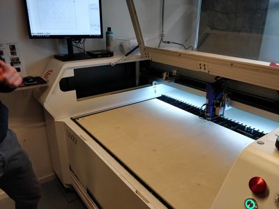

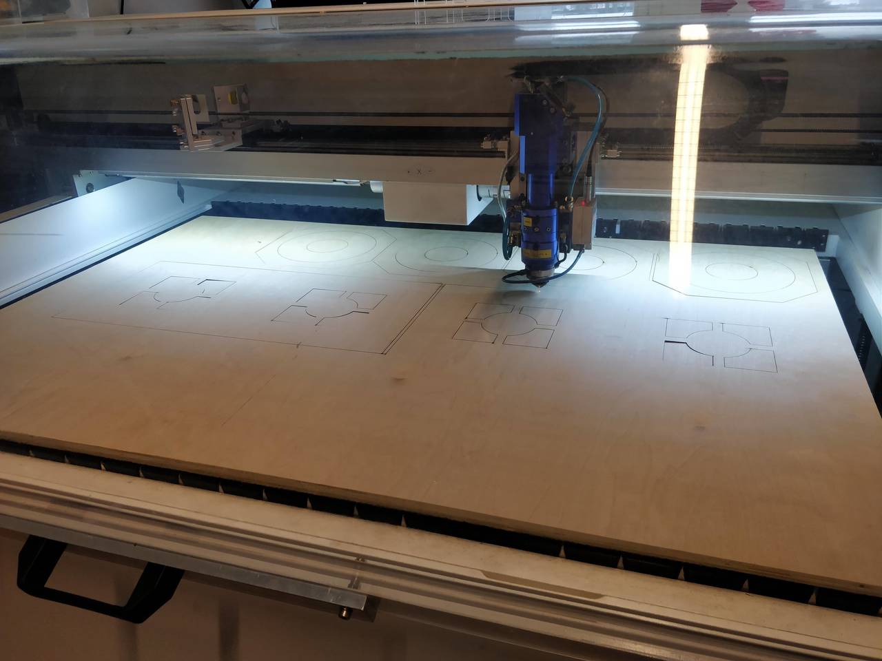

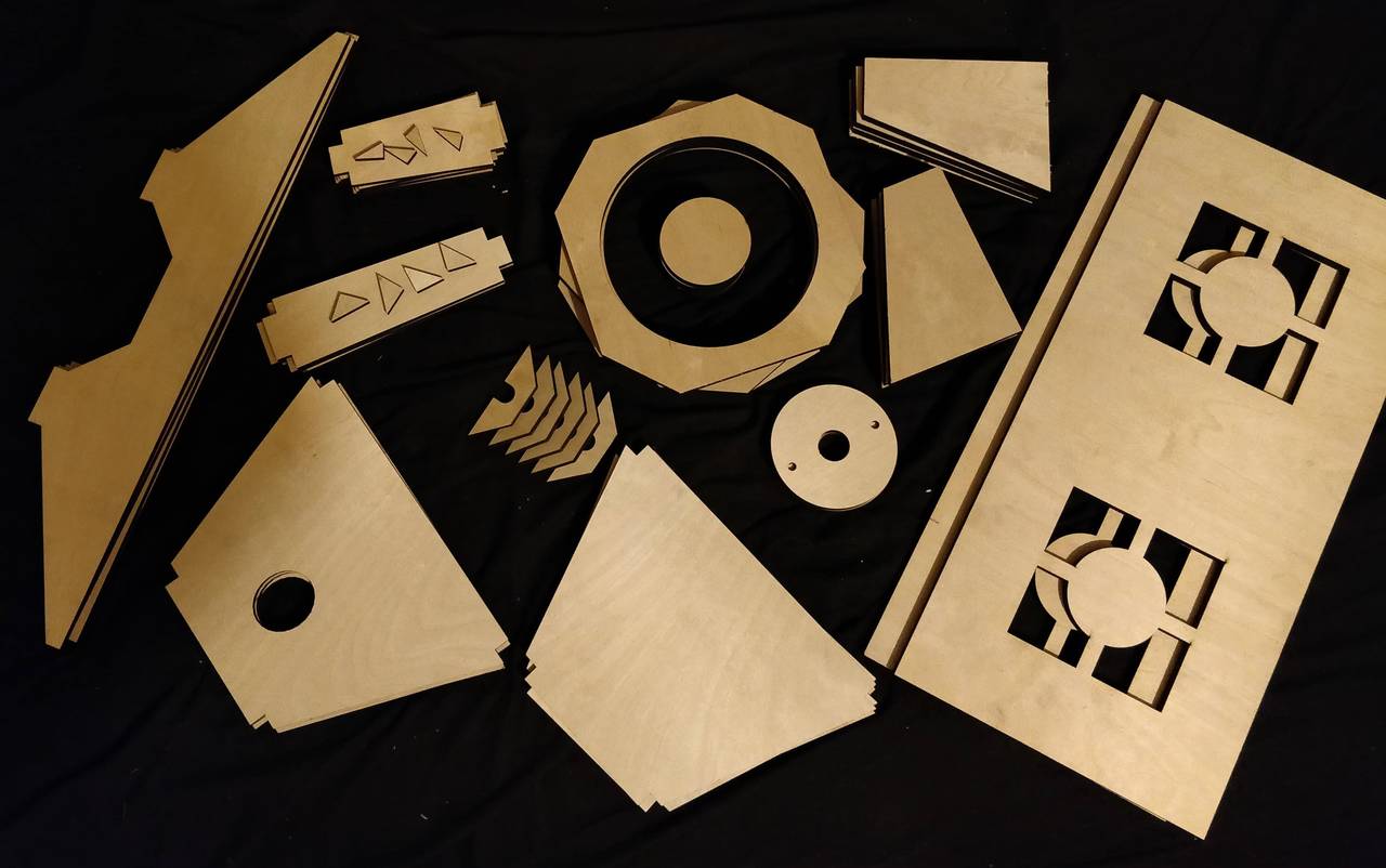

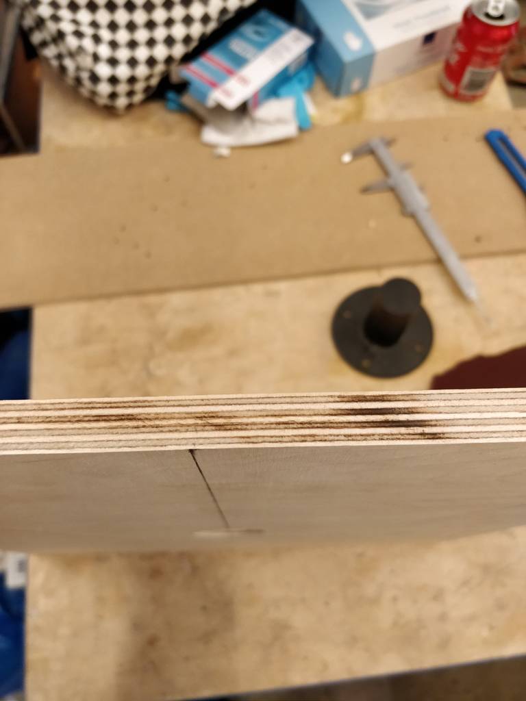

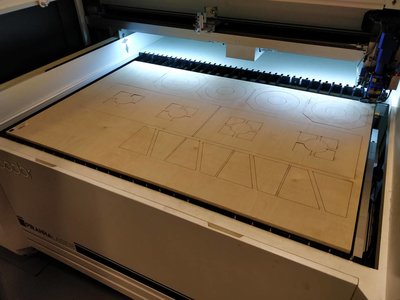

Spend a few hours with the laser cutter today.. And I must say, that I'm quite amazed; being used to 3D printers, this was just a piece of cake.
I had already drawn the models in 2D, but as I'd drawn the models directly from the plan, the models were scaled in inches.. So they were quite small when imported as millimeters...
I then converted everything to millimeters, double checked the scales, and was then ready to lay out the models (you can see the layout on the screen).
After testing the settings, all we had to do was close the lid, turn on the ventilation and hit the big "start"-button. :chainsaw:
The 12mm parts were then cut.
The HF parts were cut in 6mm. Same with mid horn reflectors. Also I checked the hole for the top hats with the 25 degree angle - fits like a charm :hyper:
I added a margin to the sides with angles, why some components might look a little different...
All the parts that were cut with the laser cutter:

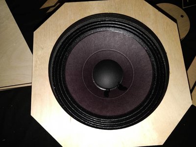

Test fitting the woofer spacer - used the dimensions from the datasheet as it fit quite well with the recommended diameter from the plans. The woofer spacer is slightly smaller than the inner frame of the woofer - so it seems spot on.

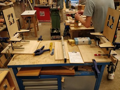

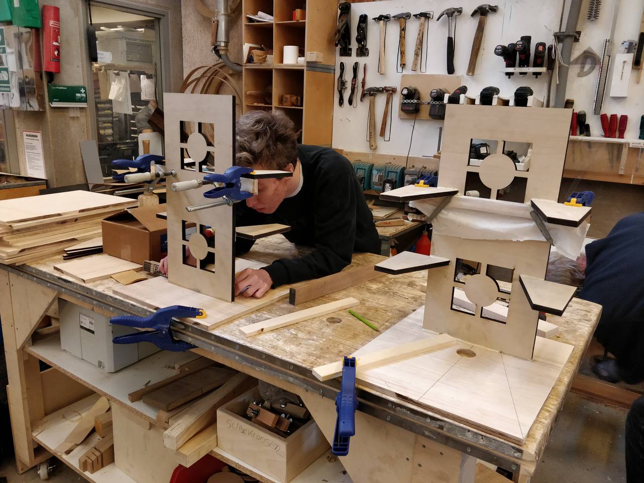

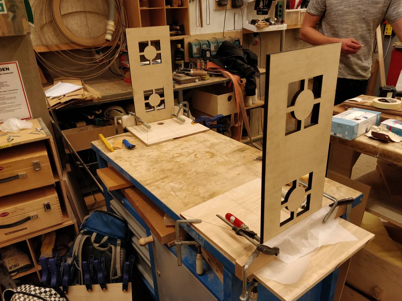

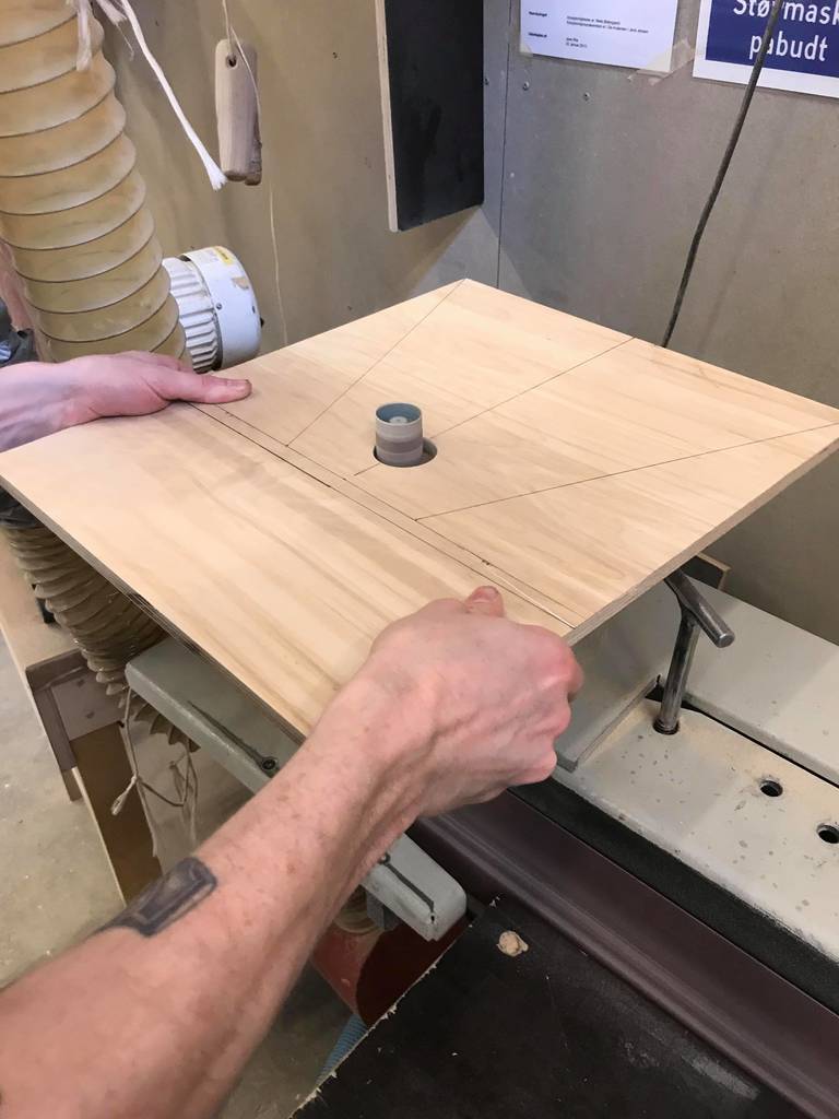

First day in the workshop!
We decided to go to a public workshop, as it's really close to my place, and also they have a lot of nice tools.
There are professionals who are ready to help. This meant that we spend the first couple of hours getting introduction, and trying out some things.. But of course (as I also expected); Bill's ways are just the easiest.

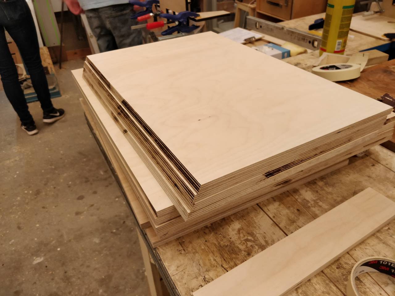

So we were ready to get going, and first was cutting the top/bottom pieces. The plywood was bought in the workshop, and it's of really nice quality!
We drew it all and made sure that everything had the correct measurements. As some clever board members wrote: measure twice, cut once. We did more like measure 10 times, but yeah, it fits really well.
After drilling the center hole, we found out, that the tophat isn't a perfect cylinder... There was 1mm difference from the top and bottom, that we had to adjust for - easily done with this machine.. (lesson learnt as well):

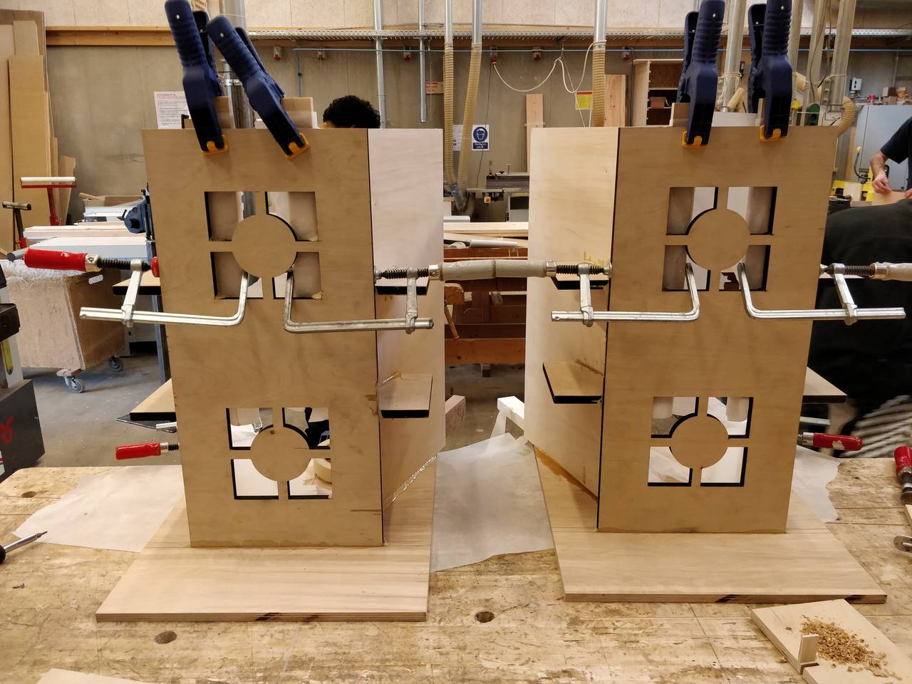

Time to install the baffles. Went better than expected with jigs and wax paper.
Waiting for the PU to dry, so we cut the rest of the pieces. We now have all the wood and it's all cut out - also the angled 12mm parts.
Installing the braces. We were a little scared to work on the baffle while the PU dried, so we decided to wait a little longer.. This was also the last part we could do before the workshop closed. I'm a little sad that we didn't get to install the other braces, as we have to wait for it to dry before installing the horn sides..
While we waited for the PU, we also started cutting the angles on the 6mm parts. We didn't run into any problems, but also we didn't do the harder parts yet.. We'll see how it goes tomorrow! Can't wait to continue :hyper:
I've cleared my schedule, so we'll go to the workshop tomorrow and Friday as well. The opening hours are limiting us a little, but it's alright. We're not in a hurry, and the build is actually super fun! But tomorrow will be another 6 hours and Friday 5 hours. Then hopefully it'll start looking like an Omnitop :chainsaw:
We use the Sika Bond 545 PU (the one I've seen other Danes use on the forum). We checked the ingredients, and it's very similar to the PL Premium. It also works wonder! Did some tests, and it's just insane how it spreads and expands. So nice! A question: How long do you usually wait before continue working on the glued pieces? The bottle says that the pressure time is 3 hours and hardened time is 24 hours. :feedback:

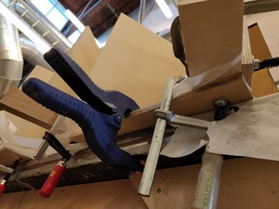

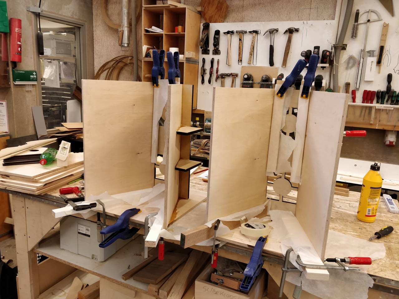

Second day in the workshop :chainsaw:
Another set of braces were installed first:
As we wanted to make sure that the braces were dry enough to work with, the horn panels were installed a couple of hours later. This was actually a little more complicated than expected. All the panels fit like a charm, but the jigs and gluing was another thing - gravity was not exactly helping..
Well, the panels were installed and kept in place with, maybe not the prettiest, but quite functional jigs. Also there's no warping, so no screws were needed. Only clamps, jigs and plenty of wax paper!
You can see the effect of gravity on the PU on the bottom plate. We'll have to remove that tomorrow. At least it'll be airtight and indestructible.. :fingers:
They look quite nice, and people are very interested in what we're building. Worst was someone asking us if we were building a doll house :lol:
All the panels follow the edge very smoothly. The jigs worked wonder :hyper:
As we spend a lot of time waiting for the PU to dry, we also cut angles for throat reflectors and some parts of the diffraction horn.
Also we began doing the handles on the cabinet sides. It's super difficult to get the measurements correctly, as everything is in inches, and we don't use that... so the tools won't have the exact sizes. The holes were made with a 1mm wider diameter.. Hopefully it won't affect the sound that much..
Oh, and after working with the enormous table saw for two days now, we still both count 10 fingers! Even though the small parts for the horn is a little scary to angle.. we also had a professional to show us some tips!
Tomorrow we only have 5 hours of opening, but the goal is to install the sides. Let's see how it goes :fingers:

#30 Post by hbinderup94 »
Padde298 wrote: Fri Apr 05, 2019 6:10 am Hej Hans.
Really a great thread. Looking forward to more pics. What do you plan to use as sub for the Otop8's? Love how you use spanners! You can NEVER have too many spanners...
Thank you for following!
We finished for today already, but will upload pictures as soon as I get on my laptop.
Haha, that's my thought as well! The goal is to not use any screws to clamp at all - and so far it's going quite well :chainsaw:
We're gonna use 2x T48 24" with kappalites :hyper:
