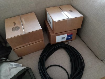

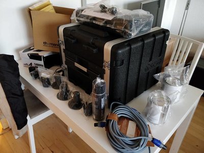

Small update:
The packages from Thomann arrived today! There was 95 items on the shopping list, but here are the most important parts:
Unfortunately we might have to reschedule to next week.. I hope that it won't be necessary! Can't wait to start the build for real :hyper:
