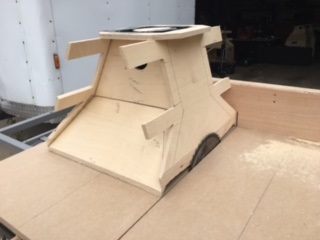

Slow but steady progress. I used the panel jig to trim the horns.
Trimming Horns.jpg (20.98 KiB) Viewed 2328 times

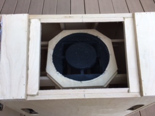

Then installed the ducts, spacer, and phase plug before test fitting the drivers
Driver Test Fit.jpg (20.59 KiB) Viewed 2328 times

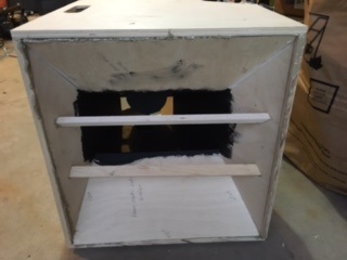

Glued up the horn and side last night on all four. This pic looks really messy due to the squeeze out, but the fit was pretty good and I think they'll clean up nicely.

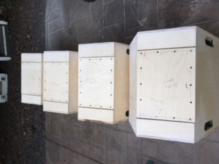

got the access flanges all cut and installed

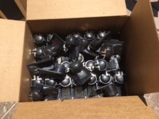

I took a break from the boxes for an hour or so to build a couple jigs and trim 32 piezos

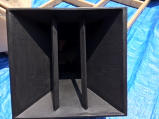

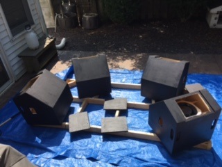

I spend way to much time applying Bondo and sanding it back off. Unsure if I actually need to fill all the little holes left by the brad nailer, but I do anyway. Managed to finally get a coat of black latex paint of the boxes. I love seeing the boxes finally looking like a speaker.

Re: WH10 build started
#23 Post by DJPhatman »
Looks like your doing good from my seat, Preston! :cowboy: :hyper: 8)
If you are going to DuraTex the cabs, now is the time to. Just do a "smooth" coat on the piezo braces.
Helpful hint: Put foam tape on the piezo braces where the array makes any contact. This will save you from chasing tiny "rattles" at certain frequencies later on.

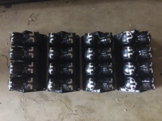

Speaking of arrays, assembled these last night. I built a couple jigs, both for trimming and assembly, that made this chore go quickly and pretty smoothly.
