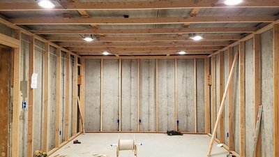

I have thought about the option of leaving the ceiling and screen wall without sheetrock. They'd simply stay as netted cellulose and get covered with decorative fabric tiles (ceiling) and a fabric covered baffle wall (screen wall). 6 inches of cellulose seems to absorb sound fairly well.

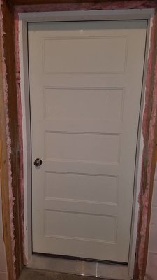

Are you building a room within a room? Without looking too carefully that's what it looks like. With all the concrete it's a little bit of overkill but if that's really what you're going for I'm curious what you're doing with the door and HVAC system. It's a whole nother world if you're trying to minimize sound leakage.
I will disagree with Bill on this: You do want controlled absorption for even frequency response. The concrete WILL keep the audio energy in the room so the key is to try to even out the response and reverb at the listening positions. Since this is a purpose built HT room having a controlled sound with a low RT60 is desirable. It's not a room where you're going to be sitting around talking.

Correct. Just trying to keep things simple for the OP. He currently has a single leaf structure that has a lot of mass. Because of the mass only the lowest frequencies will have enough energy to cause the floor, walls and ceilings to resonate and thus radiate sound to the other side. The simplest way to express this is to say that the concrete will keep the audio energy in the room.
Though I didn't say it directly my concern, especially after seeing the picture with the stud walls is for the OP to have a "balanced" system. In other words, he has a "Cadillac" for a basic room and it would only be fair to hold the rest of the HT system to the same standard. It doesn't need to be expensive, but just take care with the rest of the install.
By installing the stud wall and ceiling and making it a two leaf system he's implying that sound isolation is very important to him. Thus my question about the door and the HVAC system. I visited a studio once that an older man built after his wife passed on. He had built a new building with sand filled cinder block walls with a tracking room and separate control room. The doors were heavy and well sealed. He had sound panels up. He had double walls between rooms with a heavy double paned window between the two rooms. And then I noticed..., underneath the console desk was a neatly trimmed, completely open 6" square hole where he had passed an audio snake between rooms. All that work for sound isolation and it was ruined because of that little hole. But, he was happy and I didn't say anything. What he really wanted was to have vintage instruments and amps and a room that looked like a studio and a place for friends to come hang out. Pretty cool really with thousands of dollars worth of stuff. He had an amp (with the price tag still on it) that Paul McCartney had played on. But still. If the hole wasn't there he would have had much better isolation.
So all I'm trying to say is that you, the OP, have the good basics of a room and instead of making it mediocre sounding put some effort in to make it sound worthy. I'll be glad to give recommendations. If the stud wall is merely there to hang electrical outlets and put in some insulation that's fine. If you are in fact making a double leaf system that's fine also but you're moving into another league of balancing things. Which is it? Are you wanting it to be done quickly and be "okay" (nothing wrong with that) or are you wanting it to be deeply thought out and super special?

The room is a 6 sided concrete box. Above it is what appears to be a standard garage, cars parked, etc. Then I have framed a box within the concrete box. Finished dimensions are around 13.5 x 23.5. The framed 2x4 walls sit between and inch to two inches away from the concrete. I would like to make it as nice as possible but it's mostly DIY. I’ll probably hire sheetrock and carpet. I’m a trim carpenter.

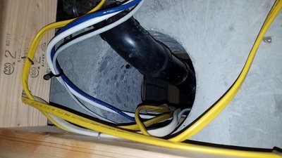

As far and penetrations into the room… I had to cut one eight inch hole in one concrete wall to pass wiring through and plumbing (for the garage drain). I plan to fill that completely with foam insulation before insulating the 2x4 walls. The door is a solid core wood door in an exterior frame with seals on all 4 sides. It will probably be the weak link for sound getting out of the room (I’m thinking about some sort of tuck and roll upholstery for the inside of the door). No HVAC in that room. I've wired for cove heaters in the winter and we don't really need AC below grade in Idaho - basements stay fairly cool in the summer.
So yeah, the room is still pretty much a blank canvas, although it’s probably too late to put drywall on the inside. Once I run speaker wires it’s ready for insulation. The plan is dense pack cellulose for insulation – approximately 6” thick. I considered mineral wool because I can do it myself but I think the dense pack cellulose might give better results. I’d like to make it as well thought out and legit as possible. DIY and not spending piles of money though.
