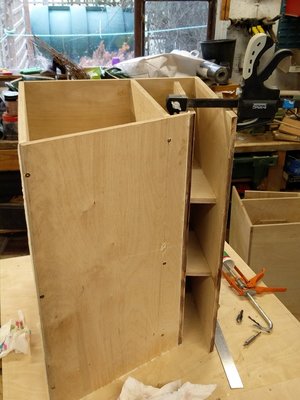

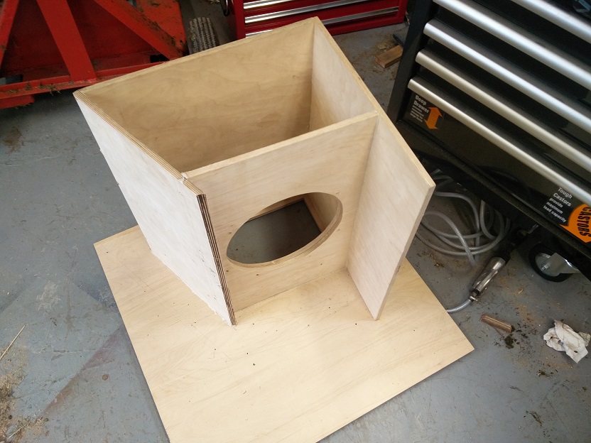

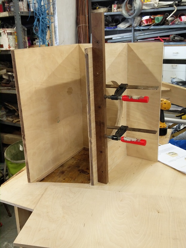

Got some serious amount of work done today, panels 1- 6 are all installed as well as my 5/6 bracers. Hoping the get the remaining bulk of the work done tomorrow.. Thinking about making some handles in 7 and 9 since i'll be lugging these around quite a bit.. Seeing it all together like this is such an amazing feeling!
Must remember to tidy up all the PU that's come out the sides of each joint!
Starting to look more like a folded horn
5/6 bracers in
5/6 bracers in
Panel 4 is a go
Panel 4 is a go
Truing panel 3.
Truing panel 3.

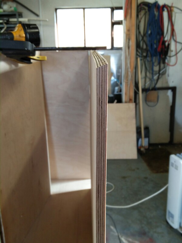

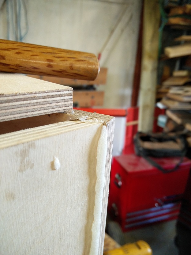

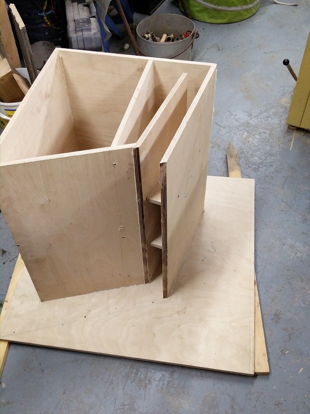

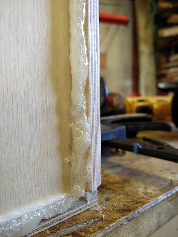

Well the time has come, got off school early today and figured I'd make a bash at getting some more of the cabinets done. I shouldn't have though, because I've made a mistake.
the pictures are of panel 8 on one of the cabinets. Due to my lack of foresight, what was square at one side of the panel was not square on the other, and before i knew it my 5 minute PU glue had set and i was up shit creek. Panel 8 is now not at 90 degrees where it joins to panel 7, and at the top of the joint the difference between where panel 8 connects to panel 7 to the unfinished edge of panel 7 is ~2mm and on the bottom where it joins panel seven there's 9-10mm of clearance, which is what is supposed to be there. What im trying to say should be far more evident in the pictures. So my question to you guys is.. have I thrown putting the "lid" on the cabinet completely out of kilter, or is it possible to rescue it?
Absolutely gutted.
Edit: the ridiculous amount of PU was intentional. Don't worry!

#30 Post by Meticula »

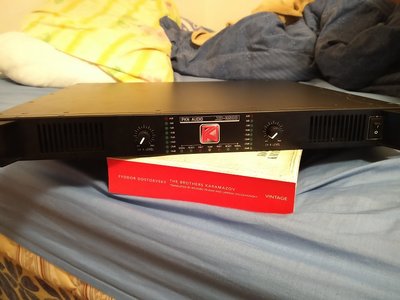

Only good news is that I finally got my PKN. In love with it.
Anyone have any ideas what I should do with my askew install? Really not sure how i should progress and the advice would be appreciated.
