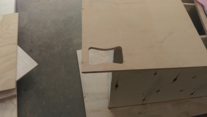

Day 5.... I built an autotuba in a day lets see if I can build 4 full size T60s in a week. Pix, gonna keep it short extremely tired.
This is the most important handle you could install in a T60. Other cut outs are for casters.
