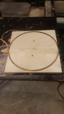

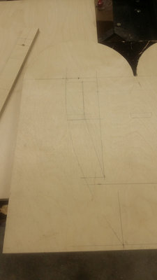

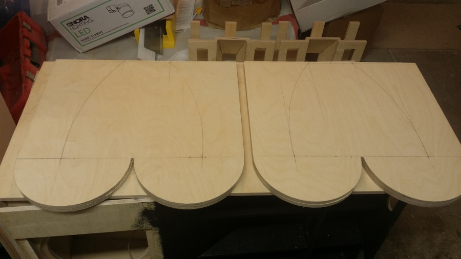

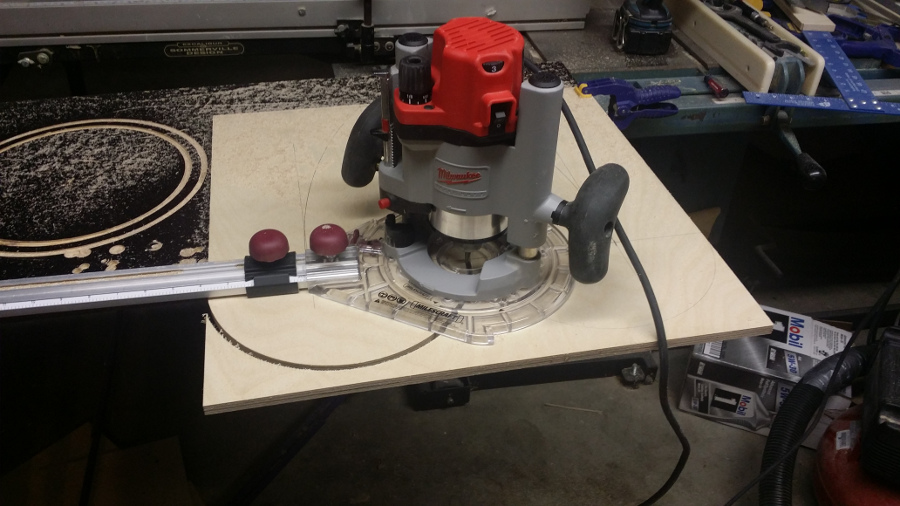

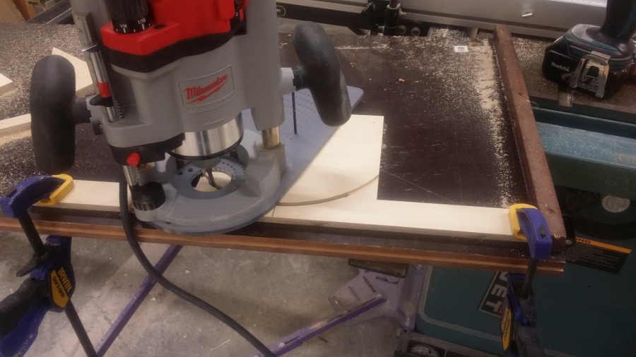

I finally made some more progress. I did the layout on all of the tops and bottoms, and then routed out the two semicircles using a circule guide for my router/
Four pieces, Eight semi-circles, and here we are:

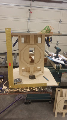

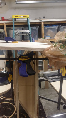

I finally got back to working on my DRs. The Jasper jig works great for cutting the woofer holes. My other router jig wouldn't cut holes small enough (it worked for the 12" woofers on the Titans, but not the 10" drivers on the DR250). I drilled pilot holes, and ran a Recex screw in each of the holes, so I'm ready to mount woofers. Except that I need throat reducers, and Leland doesn't make them at the moment. So I need to go out and buy some 1" solid foam. I hope it is sold in something less than 4x8 sheets for the couple square feet that I need.
I tried using the Kreg jig to make pocket holes on the woofer baffle, but the screws didn't pull things tight, so I reverted to clamps and the brad nailer.

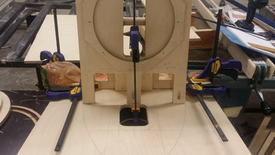

Here's the first side clamped before I flipped it over to nail it in.
The tophat hole was a good place to put the 5th clamp to hold things together. (two held on the 3-degree guide, two others held the horn to the guide.)
next I flipped it over to nail the bottom to the horn.
Then I checked to make sure everything is square while attaching the second side.
now that I have a good measurement, I can fabricate the front sheath braces and the back braces (half circles)
Next comes one of the parts that I have been fretting over the most: the front and rear sheath cleats. I'm just not sure how to get the radius correct on those little parts. This is where I'd love to have a CNC (or a friend with a CNC) mill.

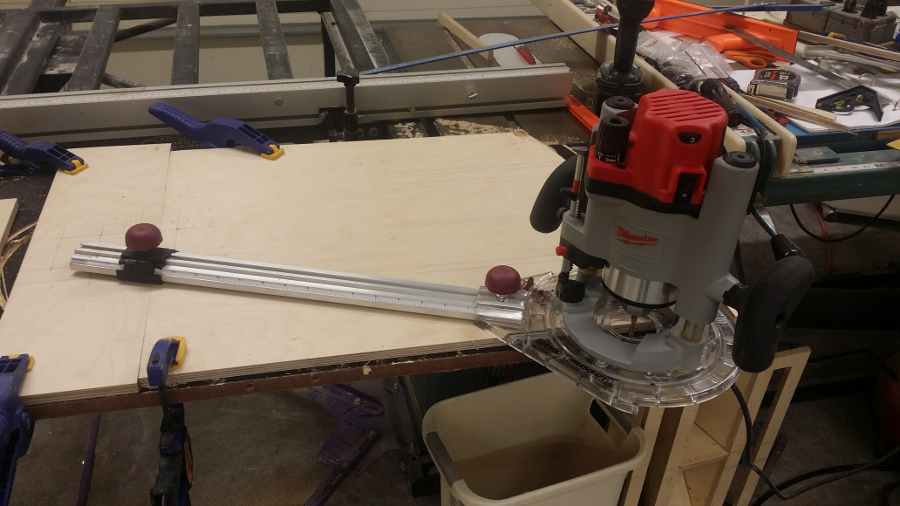

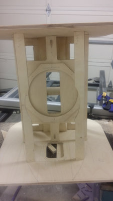

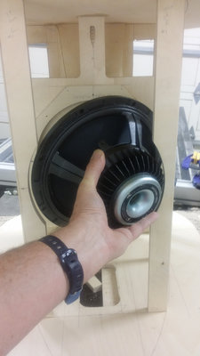

First on today's routing is to cut the radius into the front horn sheath braces. I built up a little jig to hold the braces while I cut the radius with the jasper jig on my router:
Then I dry fit the braces into the cabinet:
Now the big test, can I maneuver the driver between the radiused cuts:
Yup, the driver fits!

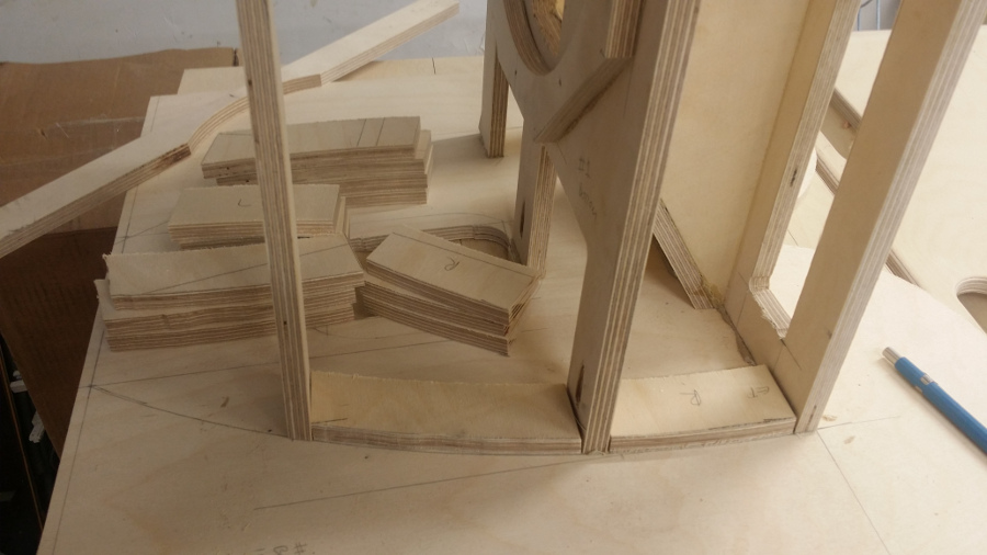

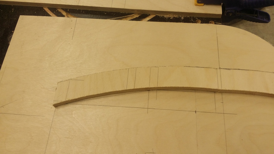

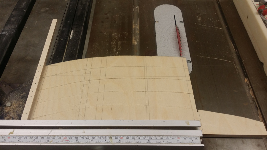

With Grant's help the other night, I finally came up with a strategy to build these little parts. I saw in another build thread someone did them with a pattern and a router table. But I didn't have a router table, and when Grant pointed out that one can get the 24" arcs the same way you lay out the bottom, a lightbulb went off. I switched the Jasper back to the Milescraft circle cutter, measured where the center point was relative to the arc on the bottom panel, and set up to cut the arcs. I left 1/4" of scrap between the left and right arc, and move the pivot of the guide half way across, making an eyebrow shaped piece:
After cutting the first eyebrow piece, I lined it up with the marks on the bottom of my second cabinet:
You can see that I have to cut out a 1/2" piece between the two cleats where the woofer baffle goes.
Next I cut off the wood below the lowest eyebrow in order to have a guide to place flat against the bar of my sliding table. Then I lined up the 4 eyebrow pieces, and nailed a bit of scrap to one side to hold everything together. The last cut was a bit tough, but the parts came out very nice. Here's a dry fit of the cleats in the horn:
Next to dry fit the cleats in the cabinet:
My cleats are a bit different in size from the plans in that they have a radius along the inside, but this reduced scrap material. I'm ready to glue the cleats in, and cut the horn sheaths! Perhaps that will be a good time to bring cabinet number 2 along.

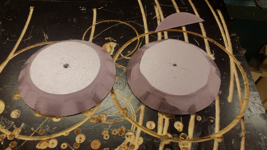

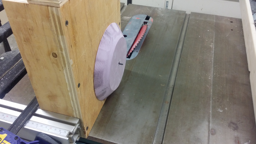

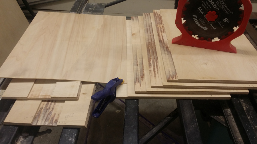

I thought about that for a bit, but for two speakers it seems like too much work. So I figured out a way to make plan "A" work. Plan "A" involves the box that will be the jig for cutting tweeters, turned on its side and my table saw.
While I wasn't able to spin the disk as I wanted, making 8 cuts to get it into an octagon, then 8 more made it round enough to spin it by the blade. Now they just need a bit of sanding. Here are the bevelled disks:
Now just a quick cut to remove the middle slice. My plan is to be ready to mount the woofer and test for interference this weekend.

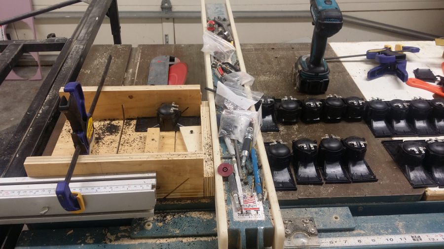

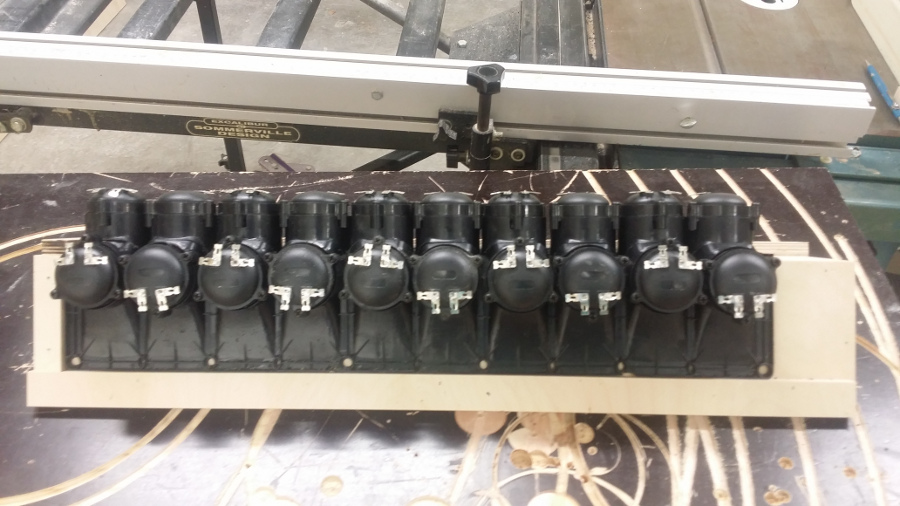

Next I built up the piezo gluing jig from the plans, and stacked up the cut tweeters. The whole set of 10 came up about 1/16" longer than nominal.
The plans state to do the initial tack together with airplane glue, but I don't have any. Another shopping trip. I do have the cans of glue that Leland sent that are specified for the second operation. I'm starting to feel that I can finish these things!
