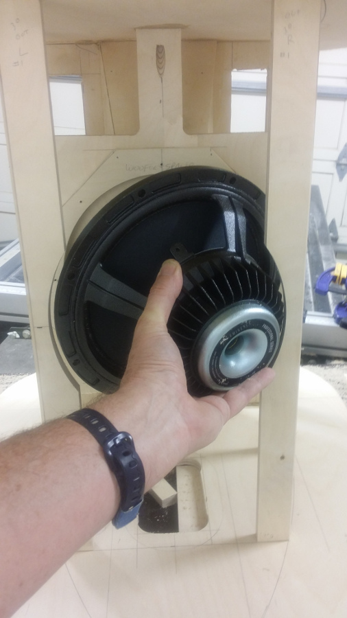

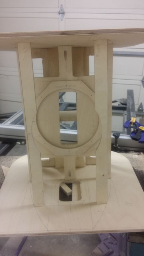

First on today's routing is to cut the radius into the front horn sheath braces. I built up a little jig to hold the braces while I cut the radius with the jasper jig on my router:
Then I dry fit the braces into the cabinet:
Now the big test, can I maneuver the driver between the radiused cuts:
Yup, the driver fits!
