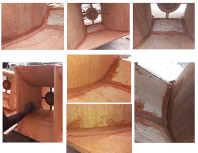

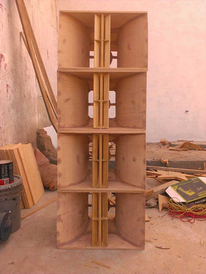

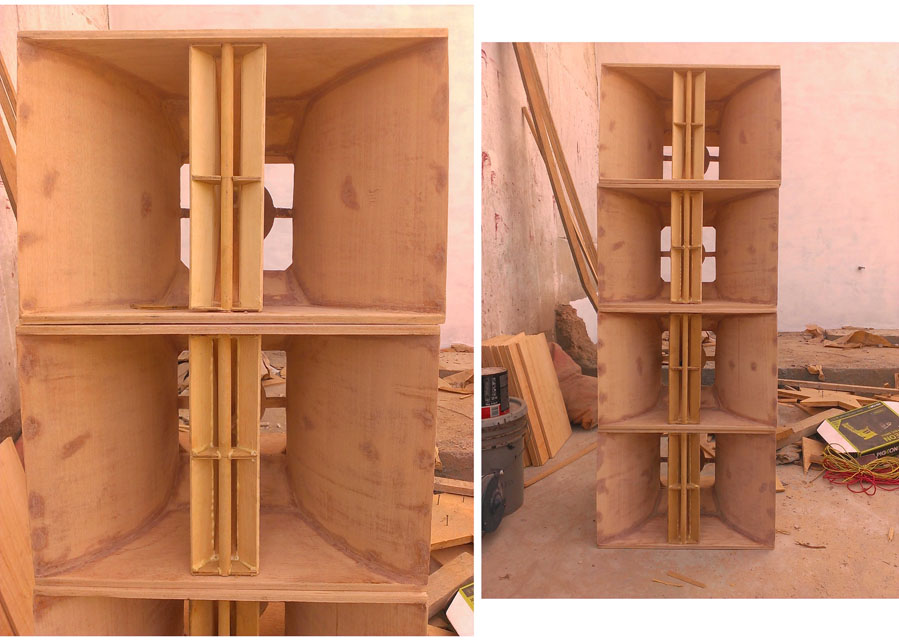

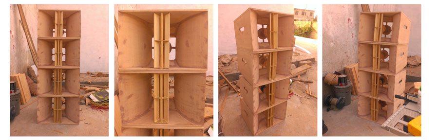

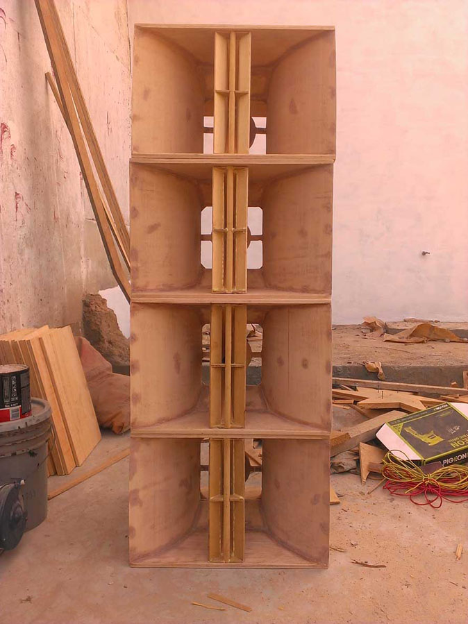

Hi folks,
We took some time off to attend to a few other things but still managed in between time to fill the potential leak points on the boxes with a mix of very fine saw dust and white carpenters glue. This mix bonds so well to the joints and seals all the leaks. We then sanded it smooth and test fitted the compression horns. We are working on the flying rig design and will post pix on thoses soon.
Sanded Cabs. Test fitting Horns
Filler Application
Filler Application
