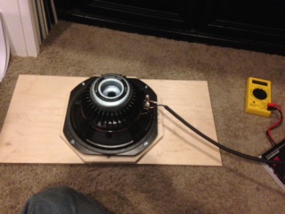

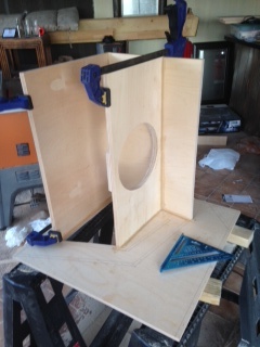

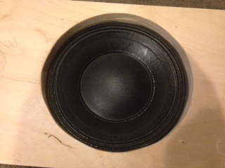

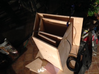

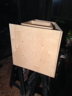

I got the first 3 panels installed today on my first cabinet. I finished sanding on both the spacers (that's a lot more work than anticipated. I thought for sure I'd have no slapping and I was dead wrong... poor jigsaw skills at the moment, may my next BFM build be better than this). I'm currently listening to the drivers being broken in as I write this. Tomorrow I'm going to do panels 1-3 on box 2 and hopefully (fingers crossed) the rest of box 1 glued up. Here are some pics from today. Oh... and today was my first experience with PL... uh... not my favorite adhesive, but it's properties are worth it... is what I keep telling myself. I finally have vertical development on this, which is a huge step in the right direction. Not as difficult as I thought.

Re: 1st Build 2x Tuba 24
As your PL skill increases, you will appreciate it more (and hate it less). But no matter how good you get with PL, you will still get it on places you won't want it on (hands, arm hair, face, socks, big globs stuck to the bottom of your shoe, etc).
I found it very helpful to dry fit every panel. I used #6 screws - 1.25" long. I used three to four screws per panel and pre-drilled each hole an inch deep. Once the PL cured I removed the screws and filled the hole with PL and a bondo knife. By dry fitting the panel before squeezing out any PL I was able to stay very mess free on the PL. That panel won't go anywhere when you drive the screw back into the hole you made on the dry fit. It was much easier than my original game plan which was to clamp everything in place while the PL dried.
+1 that's what the plans sayecut1 wrote:I found it very helpful to dry fit every panel. I used #6 screws - 1.25" long. I used three to four screws per panel and pre-drilled each hole an inch deep. Once the PL cured I removed the screws and filled the hole with PL and a bondo knife. By dry fitting the panel before squeezing out any PL I was able to stay very mess free on the PL. That panel won't go anywhere when you drive the screw back into the hole you made on the dry fit. It was much easier than my original game plan which was to clamp everything in place while the PL dried.

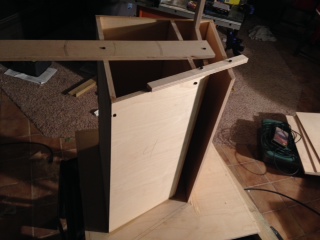

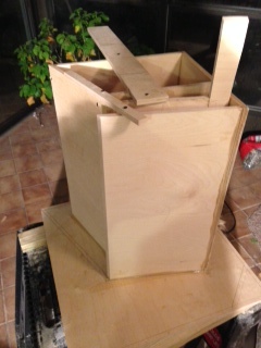

Got a little more work done tonight. A few more panels installed and got ALL the rest of the panels and braces cut. Since this is a 24" wide cabinet, should I use 1 or 2 braces? I was thinking one, then when I held up a brace against the cabinet, I thought maybe 2 would be better. So far I'd decided on one brace on the 2 smallest sections and then 2 on the rest including the opening. Opinions? I'm off all day tomorrow. The goal is to finish cab 1 with the exception of closing it up with the side panel and getting as much done on cab 2 as possible.
Opinions aren't required.nouvo1 wrote: Since this is a 24" wide cabinet, should I use 1 or 2 braces? I was thinking one, then when I held up a brace against the cabinet, I thought maybe 2 would be better. So far I'd decided on one brace on the 2 smallest sections and then 2 on the rest including the opening. Opinions?
It's all in the plans:
"Braces connect the panels. The may be made of one-quarter to one-half inch plywood. They may be drilled or sawn with holes to lighten the cabinet. The braces are spaced no more than about 8 inches apart. A single brace is adequate for 16 inch wide panels. Use two sets for 17 to 25 inch panels".
And:
"Panel 3/5 brace is not used with a 1x10 cab".
It's been shown before that not installing braces as per the plans can cost 3dB in output (due to panels flexing).
That 3 dB is like picking up one of your 2 cabs once the build is finished, and throwing it away!
+1 skimping on braces will hurt in the end, cab rigidity is one of the points I brag on all the time, I'm confident that if girls want to dance on the sub (and they aren't wearing spikes) they should damn well be able to without me having to worryGrant Bunter wrote:Opinions aren't required.nouvo1 wrote: Since this is a 24" wide cabinet, should I use 1 or 2 braces? I was thinking one, then when I held up a brace against the cabinet, I thought maybe 2 would be better. So far I'd decided on one brace on the 2 smallest sections and then 2 on the rest including the opening. Opinions?
And:
MissileCrisis wrote:+1 skimping on braces will hurt in the end, cab rigidity is one of the points I brag on all the time, I'm confident that if girls want to dance on the sub (and they aren't wearing spikes) they should damn well be able to without me having to worryGrant Bunter wrote:Opinions aren't required.nouvo1 wrote: Since this is a 24" wide cabinet, should I use 1 or 2 braces? I was thinking one, then when I held up a brace against the cabinet, I thought maybe 2 would be better. So far I'd decided on one brace on the 2 smallest sections and then 2 on the rest including the opening. Opinions?
And:
That 3 dB is like picking up one of your 2 cabs once the build is finished, and throwing it away!.
I'd been looking for that info, and just found it, right there in that plans. I must be more diligent on the details. Thanks. 2 Braces it shall be. And yes I was aware regarding panel 3/5.

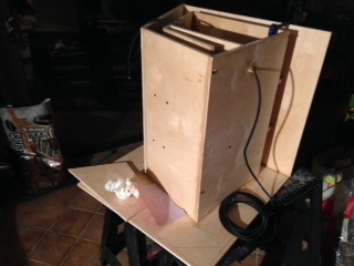

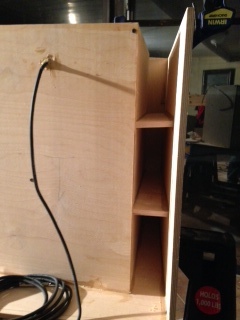

Tonight we did panels 7 and 8 and their respective braces. It's not pretty but it looks like it's going to be airtight. After filling, sanding, and duratex I think it will come out alright. I also drilled one of the holes for the 16gauge speaker cable. Have not yet stapled it though. Yes I'm aware there is a 1/4inch plug on the end of the cable, that's not staying on there. The local GC didn't have what I wanted in bulk without terminations. Tomorrow will be panels 9, 10, 11, and speakon jacks. Depending how things go, I might even get the second side installed, then all would be left is the flanges. Is there any reason to wait for PL to cure between the last panel and the second side going in? or before installing the driver access flanges? I haven't found anywhere in the plans where it says to wait on these. So besides being my first speaker build, this is my first build of any kind. Learning how to use tools, saws, adhesives. I've got great help though. Still getting used to being covered in sawdust all the time.
I see no reason to wait for the pl to cure before doing the rest. That is as long as they are secured with screws or brads as well as pl to prevent them from moving while installing the next panels. I have built entire subs in a weekend - not waiting for each panel or 2 to cure.
