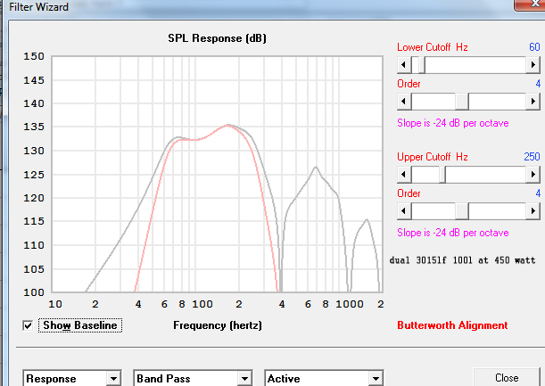

I think I've got something you might like. dual 3015lf "horn" (straight pathlength with a flared mouth) dispayed at thermal limit 450 watts per driver(still within xmax with the filters shown). this was like 20 minutes, probably a much better driver out there than the 3015lf for this job too. response is even smoother if you use 2 per side. if you like it I'll take a shot at folding it tonight (I suck at folding)
EDIT
pic says 100 liter (thats for a single driver box), the graph is actually for 2 of those boxes parralel (aka, a single dual driver box), so the actual vol is 200 liter (plus some extra for build material).
