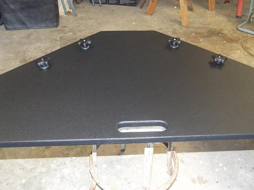

I put this type of weatherstripping on my v-plate....
http://www.amazon.com/M-D-Building-Prod ... 70&sr=1-59
You can get it at any HD or Lowes. Put it on the plate, then crank the screws down tight. I don't get any vibration out of the plate.

ahhhhh.....so the plate is flexing? What did you build it out of? Mine are both made with two pieces of laminated 1/2" ply - to end up with a 1" thickness. They don't flex.Keryn O'Shea wrote:Appreciate the advice, but in light of the increases in output due to the addition of required bracing, the question I'm asking is: Would there be a potential gain in cross bracing the v-plate and driver chamber? Just like the bracing added to Omnitop rear doors. There's no vibrational noise coming from the subs or v-plate, only that the v-plate moves when the subs are put to work, that movement could be translated to output (?), rather than the v-plate soaking up the energy?

Yes that's it! A laminated v-plate would definately be stronger, but heavier? Is a brace inside the horn path going to affect anything? One could be fitted to the top, just have to rip the carpet off!

Adding a brace won't do anything noticeable but if the cabs aren't flexing, there is no need.Keryn O'Shea wrote:Yes that's it! A laminated v-plate would definately be stronger, but heavier? Is a brace inside the horn path going to affect anything? One could be fitted to the top, just have to rip the carpet off!
You could either add another sheet of ply to your VPlate or if you are worried about the 100% increase in weight, some strips of wood (maybe 3/4"?) with the ply running at 90 degrees to the top (are they called ribs?), should be enough to stop the flexing though they would be fragile in transport.

Re: Read the plans, and look at the right sketchup!
Why does your V-Plate look better than my cabs?Bruce Weldy wrote:With a handle in 'em, they aren't that heavy.
