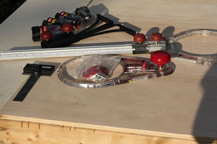

[imgImage][/img]

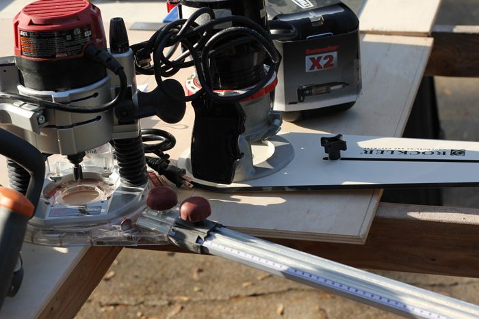

My Circle/Edge Guide and various router bits.

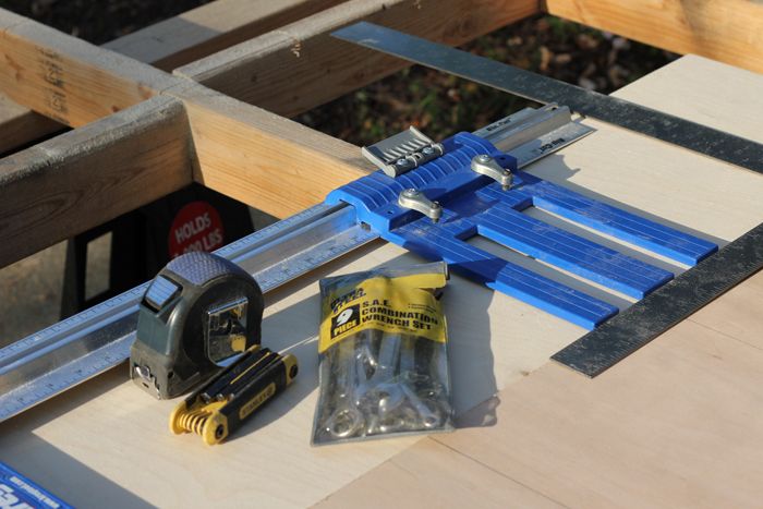

[imgImage][/img]
My Kreg Jig for my routers.

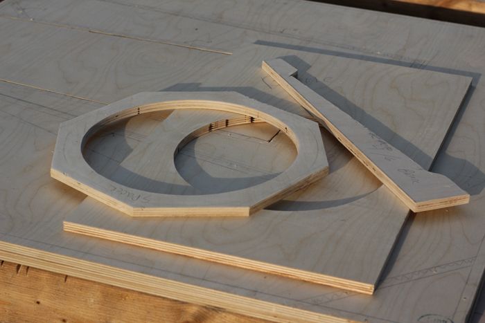

A closer look at my circle jigs.

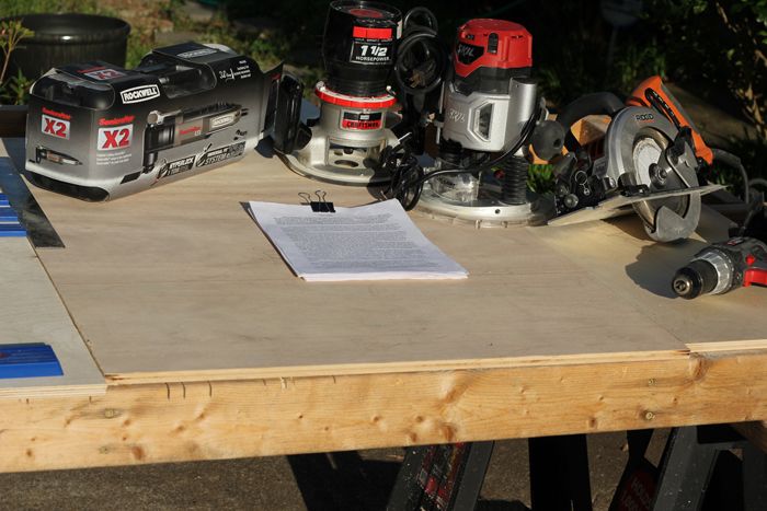

The Master Plan.

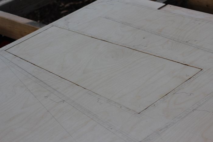

[imgImage][/img]
Was a bit nervous and in a rush as you can tell. This panel was trashed though as I wasn't too proud of the outcome. I have re-cut
another one and it is a hundred times better looking as I was a little more concentrated.

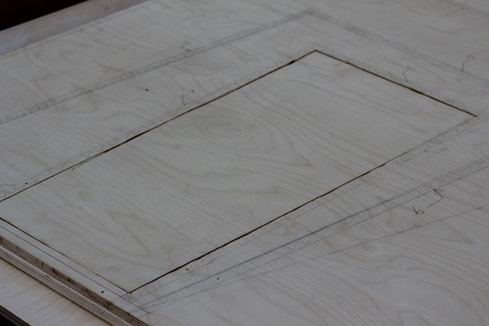

This cut-out has been trashed. I was not happy about the final result so I cut a brand new
one. I'll post a pic of the better version soon.
Here is the opening after plunge-cut. I smoothed out the edges with the X2 there-after. Just still a tad bumpy, but you can hardly
tell when the new access panel is in place.

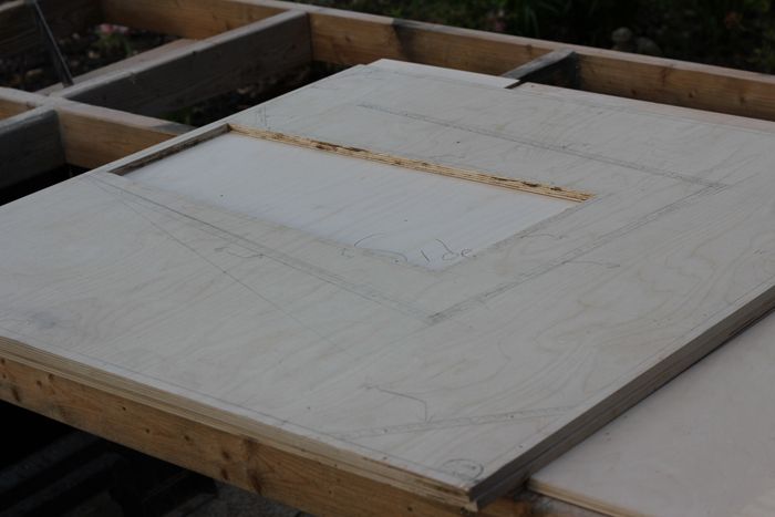

I decided to cut these parts early. The brace was shaped with the X2. It was also used to plunge the triangles off the spacer.
