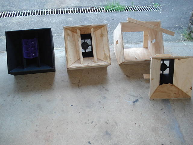

All three, cab 2 is a lot closer to finishing and cab 3 is at least ready to put together tomorrow:

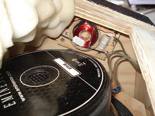

Cab 1, driver and LF board:
Cab 1, driver and HF filter:

I finished assembly of all three cabs yesterday. As in shells and horns on cabs 2 and 3 (cab 1 was already done, as per previous pics).
Then spent time filling screw holes with bog. And PLing those holes from trimming with the 0 degree sled (and any others requiring it).
Today, sanded the cabs down, assembled and installed the LF LP and HF filters in cabs 2 and 3.
I will unscrew the HF filter board when I put in the melded array to finish attaching the melded array to the "outs".
Then took a step away from the plans. For cabs 2 and 3, I installed the drivers before putting on the access panel flanges. Much more room to drive the screws in!
Driver covered with a cloth to prevent sawdust.
These should be done soon (they better be, they are "in use" in 8 days), though not sure if there is sufficient time for grills.
Horns painted.
End of day...

Wedgie 1 is done.
Time for a quick test. Hmm where's the HF? Disconnect the woofer. There but barely audible.
Back to the schematics. Hmmm wonder if I really should have put a wire from there to there. Jury rigged one just to see. Yes, should have put a wire from there to there.
Sinking feeling. I had wired every HF filter in the same fashion (including the DR's which had now been sealed up). HF sections revisted all round.
On a brighter note (pun intended) I'm getting closer to being ready. 1 week away today for the festival.

In your last picture of the HF filter, it appears you're missing a wire between the - out terminal on the left, connected to the - input terminal on the lower right.

byacey wrote:In your last picture of the HF filter, it appears you're missing a wire between the - out terminal on the left, connected to the - input terminal on the lower right.
I saw that, but figured the wire was on the other side of the board.

Byacey and Rune,
Excellent spotting, exactly the missing wire.
The coil and the resistor on the - side are parallel to the cap and resistor on the + side as they should be, just nothing inbetween :oops:
It's ok, they are now fixed and working fine. Glad I found out when I did...

Are you sure you have your phasing correct? I noticed you have the copper colored lead connected to the - out, but the minus input from the speaker jack appears to have the silver tinned lead connected.
The usual convention is to maintain the same color codes on input and output.

byacey wrote:Are you sure you have your phasing correct? I noticed you have the copper colored lead connected to the - out, but the minus input from the speaker jack appears to have the silver tinned lead connected.
Good spotting again, but phasing is correct.
Seems like I don't do a lot of things by normal convention :?
