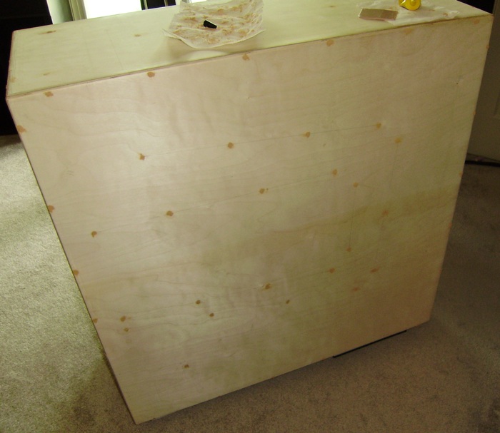

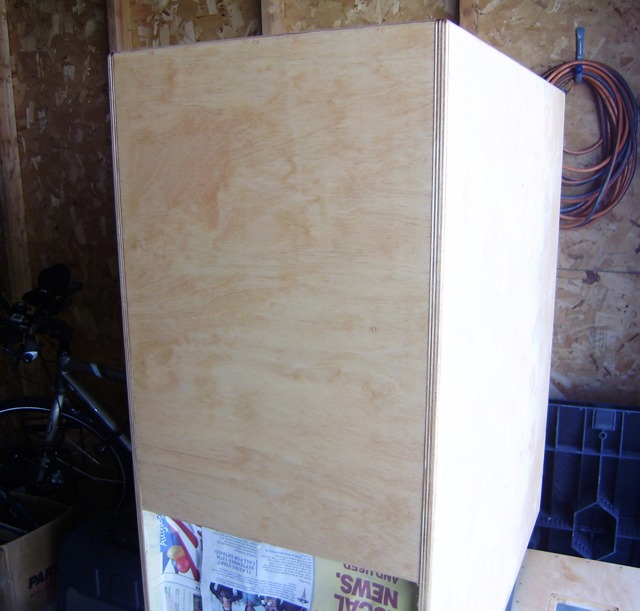

Drey Chennells wrote:Yep I see it's raw I thought maybe a clearcoat for that natural color would be in it's future :)
I've strongly considered this based simply on the beauty of the wood. I think she would prefer a shade or two darker if I go that route, but not much more than that. We both agree the grain really looks nice.
I thought filler wouldn't take a stain though. How difficult is it to match the stuff to a color? Doesn't regular filler shrink somewhat?
Bas Gooiker wrote:if you want a "natural" finish, mix some of your sawdust with ordinary woodglue and use that to fill your cracks and screwholes. will never look perfect from real close but should be a close match.
I dispatched the sawdust when I cleaned up the shop last weekend. :cry:
Drey Chennells
Posts: 1377
Re: THT Slim
#17 Post by Drey Chennells »
Sanding sealer is the way to go for staining for a uniform finish with less grain pop, which helps when you have putty or filler products to consider. Plugs cut from the same birch, lined up on the grain and sanded down is my favorite filler for countersunk screw holes.

#20 Post by Radian »

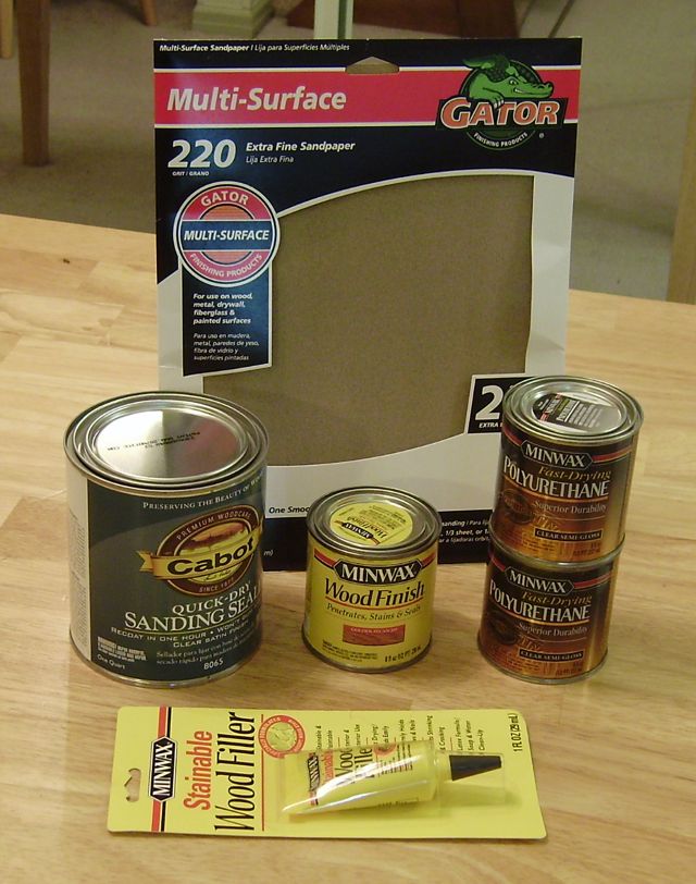

Regarding finishes, it's going to be Minwax Golden Pecan Semi-gloss. The GF pitched-in for the make up, I'll pitch-in the time and fuss to put it on. Time will tell if that was an okay decision. I haven't put stain & clear on a wood working project since high school. :?

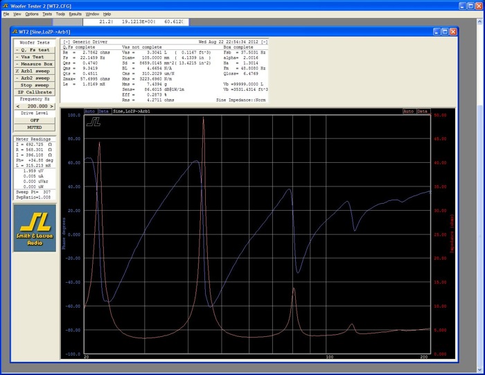

Also swept it....It's officially a THT 8)
Impedance sweep of a 15" wide, DVC 310-88 loaded THT

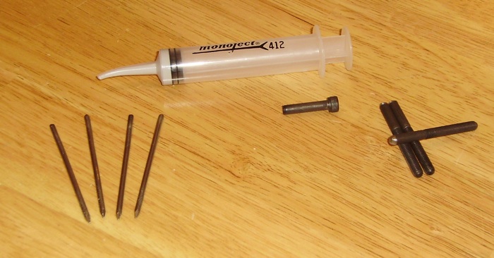

Here's some tools that could help out a little during assembly. They are ideas contributed by other members over the last few years.
I don't make cabs often, but these items have made it easier to hit the quality mark when I do.
In the back is an oral irrigation syringe for injecting RTV sealant into the gaps between the driver gasket segments.
In front from left to right:
-8D finishing nails with the heads ground off and then rounded over. They slide right through the pilot holes if you happen to use screws. Placed in the corners of the cab, these act as alignment pins when it comes time to lay down the final side. Makes the process a clean, one-man job.
-2" Socket head cap screw with the threaded portion cut off and ground squarely. This is used to mark the locations for the driver mounting holes. Once the baffle is centered evenly around the driver gasket, flip the entire assembly over, then tip this with some wet ink and place this through the driver basket holes to mark a perfect spot to drill
-2" Socket head cap screw with the heads cut off and rounded over. Placed in the t-nuts ahead of time, they allow the driver to drop down and line up perfectly with the baffle to avoid possible cross-threading. Not all cab designs have the space required to use these.

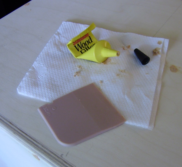

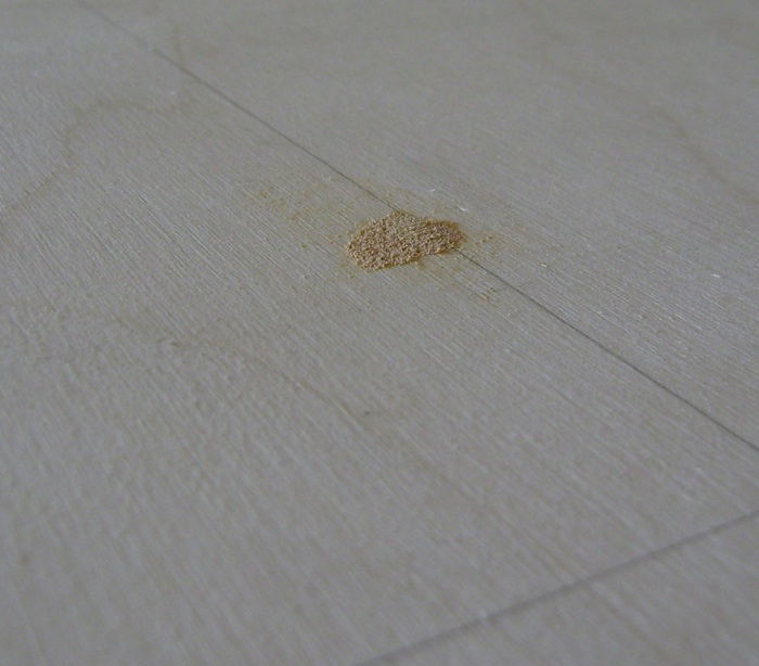

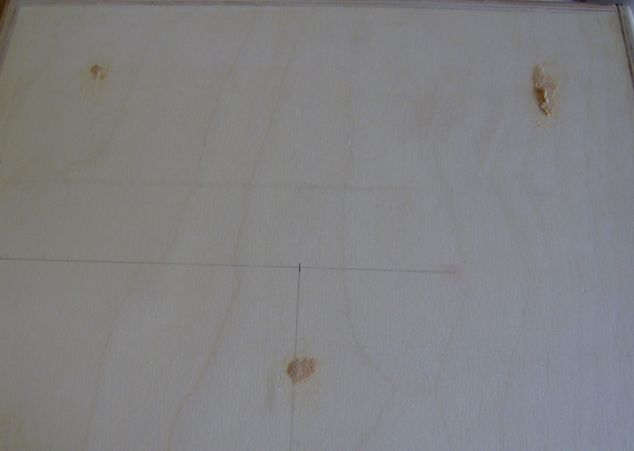

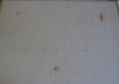

Some folks like finishing. Personally, I can't stand the mess involved, exposure to the fumes, and the cure times. But here goes.... :chainsaw:
The goods. I gather it's enough to rearrange a few chromosomes.
This stuff is really gritty. Used a plastic applicator to spread it around.
A little darker than expected. Hopefully it lightens up.
Complete. Easy enough.
Posts: 2056
Re: THT Slim
#24 Post by Radian »
At the store I went to, this brand is sold in two quantities..enough to spackle a tooth, and enough to spackle an entire warehouse.
Directions say, "Apply liberally to the area."
That would've been fine if they'd actually filled the tube with a liberal amount to begin with. :|
It's like a bag of potato chips...half air, half product.
I had just enough to do this cab.
Orangutan grip required to get every last bit of sauce out of this gem.

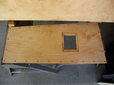

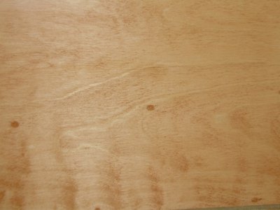

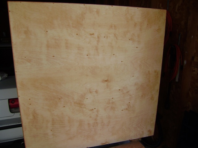

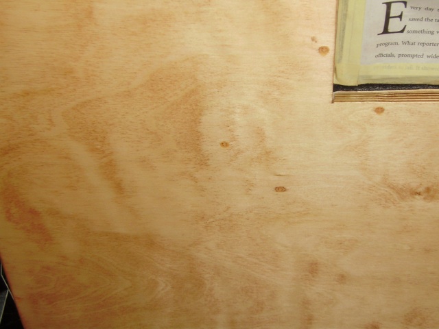

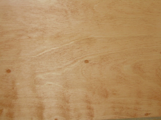

What can I say....me and stain don't get along. Normally I take the advise of the folks here...but I called an audible mid-play, and this time it'll cost me $13 and my pride.
Instead of sanding sealer before the stain, I followed Minwax's instructions to use their "wood conditioner" instead. Sorry Drey. :oops: Things were looking very promising when I applied the stain initially. But it didn't take long for the nice Golden Pecan to turn into an angry case of rosacea. 3 minutes and the finish was beyond recovery. My dwell time was too long. I didn't wipe it quickly enough. :bash:
The instructions should read, "Working in sections, apply the wood conditioner, now while the wood is still damp apply the stain, count to 10 (no seriously, 10 seconds fool), then wipe it all off."
Entire books have been written on the chemistry and technique of wood finishing. F*#K that. :evil:
So take heed....if you haven't read them, or happen to know finishing by trade, stick to paint. :cop:
Plan "B" is for black. Enough farting around in the garage. I don't have the patience to experiment and get high on fumes. I'm tired of looking at this thing instead of listening to it. :|

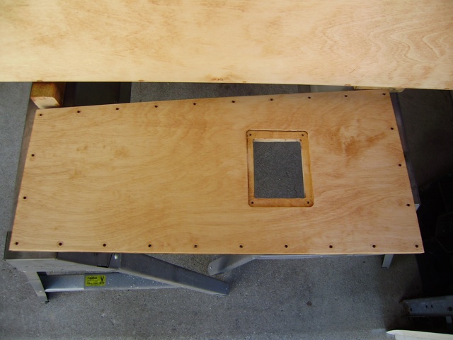

The mess... :oops: The only part that came out even half-way decent, is the access panel. :noob:
When I look at it, I know the Matrix is telling my mind that this job is a train wreck. But I know deep down, there's still a kick ass subwoofer in there. :ugeek:
Drey Chennells
Posts: 1377
Re: THT Slim
#30 Post by Drey Chennells »
Radian wrote:What can I say....me and stain don't get along. Normally I take the advise of the folks here...but I called an audible mid-play, and this time it'll cost me $13 and my pride.
You wouldn't be the first.. :slap: A good stain is difficult. If you decide to go for another round, of course you could rough sand it all out, start over. Or, finish sand it with say 220, light sealer coat and use a dark stain. The most consistent stain (least grain pop) you can get is by mixing your stain into sealer, no more than 30% stain (similar to but better than minwax polyshades). You can spray this mix as well.
