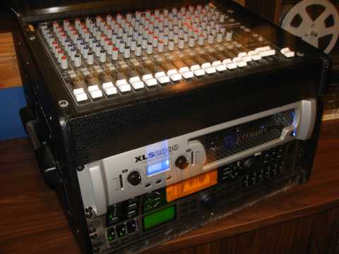

Funny that I saved so long to complete my rack with the DEQ, but often I actually leave it off. I notice that the DEQ panel gets hot after a long night, and the heat ain't coming from the Crown. If you're just running analog, it might be interesting to know that the signal will continue through it without a glitch when powered on/off. I've used results of the RTA to enter some simple corrective eq into the DCX so things sound great without it. Great to have at the press of a finger though!
I'd still like to learn how to use it more fully, especially effective use of the feedback eliminator.
