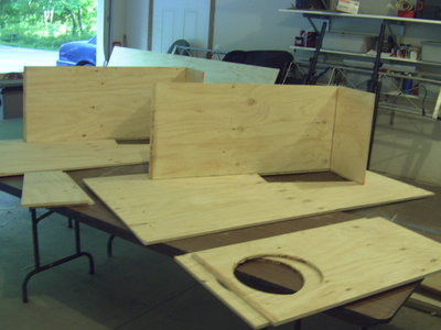

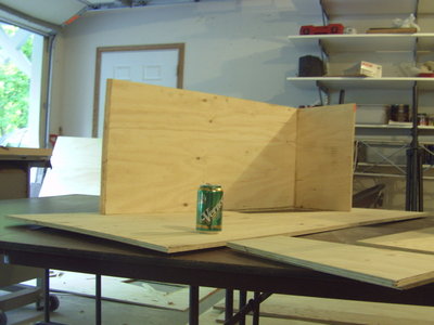

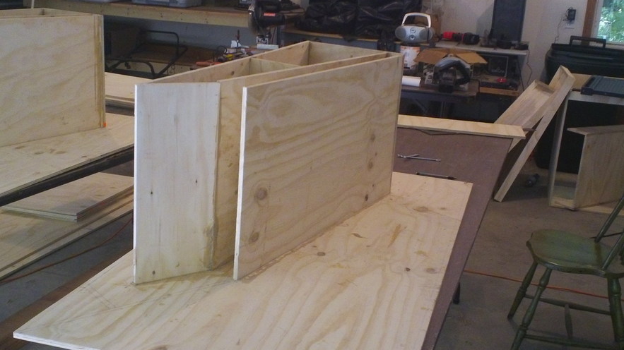

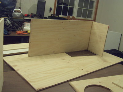

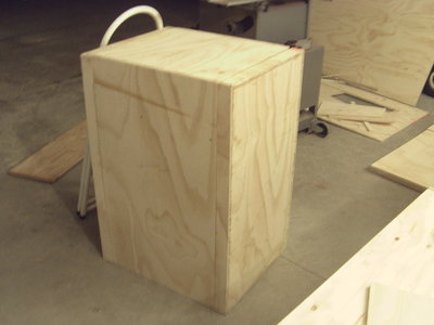

Started at 8 in the morning, went constant till 10:30. (besides lunch w/ delivered pizza :D ) Didn't get as much done as i'd hoped mainly because I don't have the kits yet.

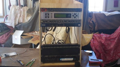

Rack
I started out with my rack, which is turning out great. It is done besides the flip up mixer box I will be mounting on the side. I'm hoping I won't need the corrugated aluminum stuff (think flight cases) to bind the covers on. I will have a lot of butterfly latches or something of the sort.
T60s
I made a stupid mistake on cutting out the sides, and didn't notice it until putting panel 3 on. :wall: I had the side and the panels cut next to each other, so what happened was it was a 1/2'' short on one end of the side, and 1/2 rich on some of the panels. I trimmed and reused the panels but I will use the bad side for braces or flight cases. when you spend 260$ on ply you will be sure to use it! :broke: I was hoping to get farther with it. tomorrow I will sync up the other one to it

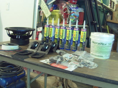

didn't get as much done today as I'd hoped to, but the kits came in so that is great news! currently burning in the lab in the lab (no not a repeat, it's in my beat laboratory :twisted: ). if you were wondering where the other lab is, it is in my t39. I'm reusing the driver; which when I built it I didn't burn it in. would it be worth burning in now? total run time is about probably 30 hrs, mostly just under limit voltage (45v)
Tomorrow i'm projecting i will get the inside panels and the top panel on. Here's the pics for what it's worth

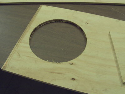

I thought so. i got pretty far so far, but I was wondering how you guys cut out your handles? on my t39 I used a hole-saw and jigsaw, and the cuts didn't look that straight. it was ok because I carpeted it, but these are going duratex. Is there an easy way to make a router path? how else would I go?

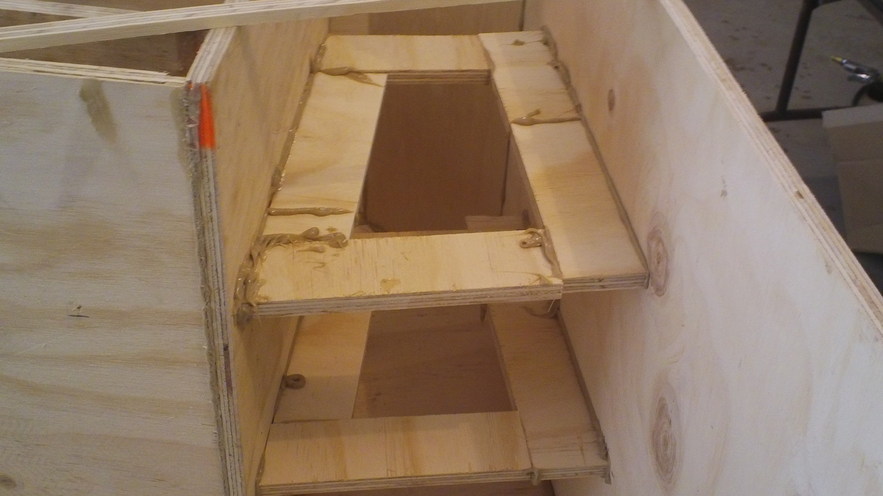

Sorry no pics tonight, bugs chased me in. I got alot of work done today, put on panels 3, 4, 5, 6. the 3/6 braces went in perfect, I hope the rest go great too. I'm not sure what i'm gonna do for the mouth braces, but I like Drey's crescent braces :D, I might do something similar. Putting in the hurricane nuts kind of scared me; if I tightened them too much they would spin. so basically you're relying on the epoxy, which i'm not to sure of the strength. T nuts ftw!
The internals are just gooped with pl, but as Phatman says it's better to be airtight and well braced than pretty on the inside. I think I may have exaggerated that a bit... I'm just paranoid because unlike on the lab 12 version of the t39, you can't tell if there is leaks by pushing on the cone and waiting for it to return. There's the stethoscope method but that isn't as effective.
Having the choice between a pneumatic nailer and screws really makes the job much easier. what i do is put the pl on, nail it in place, then flip it over and crank the hell out of it with screws. I also am using a bit that has the pilot, flange and countersink all in one, so i just drill in, then switch to my Phillips headed drill and screw them in.
I had the right bit for tracing patterns that I didn't think I had, so I made a handle pattern and finished all of the handles besides the bottom one in one of the mouths.

All the panels are installed besides the bottom panel and reflector. So anxious to get it done! I didn't have the best time with the braces on the back. What I did was build it in, but what i'm going to do with the visible ones is build them, then install them. It should hopefully be cleaner.

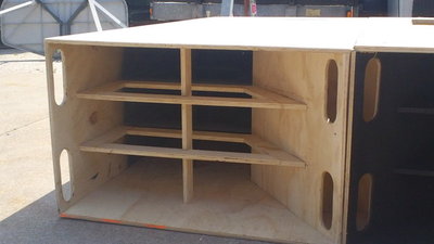

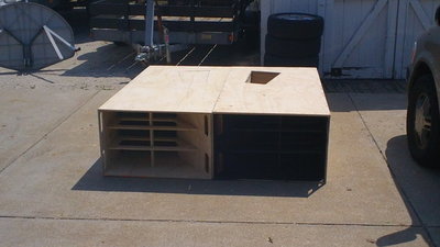

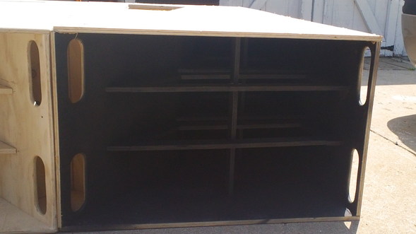

It's been a while since I posted, but all that's left is trimming, sanding, painting and playing! :hyper: :hyper: :hyper:
one is ready for paint, the other I just put the side on. I got to try out one in the garage, but it didn't impress me.... alot of sound at 30 hz and up. but i didn't feel 25... I'm not worried because the only configurations was on a table facing out the open garage, and standing it on end in the center of the garage, still door was open. my limiter was set wimpy too. Haha we'll see when it is boundary loaded and correctly signal processed. -and with the addition of another. :hyper: :hyper: can you tell I'm hyper?
Here's what I hope to have for my setup, using it as a stage. Hopefully putting them on their sides won't affect much, a radiating plane is a radiating plane right?
I put the last side on, and I must say I love the warm feeling in your stomach when you get excessive squeeze-out on the last side 8)
I've been using heavy duty screws for like construction use, thinking that the little drywall screws Leland has in his kits don't have enough meat to their threads... I used the ones from the kits for the last side and they were far better, since they had a small diameter you didn't need a pilot, just a counter sink. and they gripped plenty and sunk way into the plywood. what do I know :confused:? the plans expect you to screw in the access panel, which I thought you would have used h nuts and screws for it. so be sure to order at least 30 nuts and screws (each cab) if you plan on doing it that way, otherwise screws come in the kits for that.
