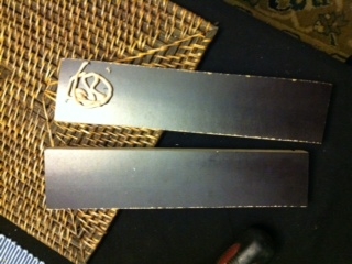

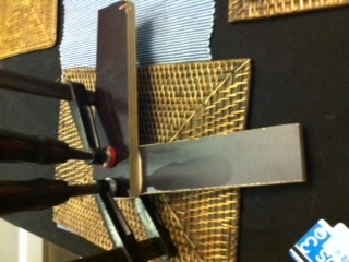

No, I have used poly glue...it's just that the substrate on the ply is a smooth finish...so the forum members have said it's not going to work. I'm just testing some pieces now...if not, I will change plans. An easy fix is to relay the existing two black elevations with a thin ply. Note - all my internals have been cut already...so I don't want to throw away a couple of hundred bucks of wood. By relaminating the two built pieces, I will be OK....as all the other ready-cut panels do not have the black surfece on the ends, where they glue.

Before I progress anyfurther, I'm doing some testing on the poly adhesive with this substrate on the ply.
The poly product is expensive, and the instructions state it is the expanding type, moisture triggered, and can be applied to porous and non porous surfaces. The dry time is 12-16 hours.
http://www.selleys.com.au/adhesives/con ... s-platinum
I've taken two samples and created a 90 degree join to test the strength of the adhesive. See pics.
I will assess tonight by prying the joints apart.
If they simply pop apart cleanly, I will know my build has failed. If the adhesive holds securely, I will continue on my project.
Perhaps we need a new rule #3. 'If someone has done something wrong, but has thoroughly tested the fix, then they should be encouraged by fellow forum members to proced with the fix in order to save throwing in the towel and starting over....and in all cases, pleasantness and civility applies.'

Your crossways joint isnt really a representative test, I guess it will show if your glue sticks to the phenolic coat, but you really should have a compressed squeezed out layer of it.
Scary little amount of squeezeout showing there doesn't bode well. If it was PL it would be all over the place, maybe too quick with the camera?
