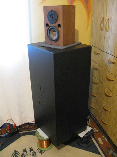

While I'm waiting for some accessories for the car install, and as I am planning on building a set of the David floor standers,
I decided to try and simulate these with the AT toped with a small bookshelf speaker, as in the David configuration.
Like this:
The AT was lifted on top of 6" spacers and placed near the room corner.
The cabs were driven through an active 2 way x-over (crossed at about 100Hz) and separate amp. channels.
I was pleasantly surprised by the good balance and low end extension of this setup.
Apart for the earlier noted peaks, the overall response was quite smooth and very pleasant - I am tempted to say Hi Fi.
I wasn't expecting any substantial reproduction below 35Hz but it was defiantly there, down to even 25Hz!

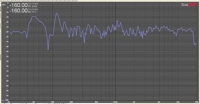

This is the measured response of the setup + room:
Mind you, I wasn't trying to determine the maximum level of this setup, but I felt there was enough headroom to enable serious levels, if needed…
Like this:

What panel width did you use on your AT's? Also, subjectively speaking, do both sound exactly the same to your ears or does one sound louder or have different tonal characteristics than the other? I'm curious if, and to what extent, different drivers change the overall sound. Looking forward to updates

Overall width is 400mm, so the panels are 376mm (about 14-3/4")ryan222h wrote:What panel width did you use on your AT's?

Apart from a thorough listening test, I intend to measure the output and plot the response of the ATs using TrueRTA.
