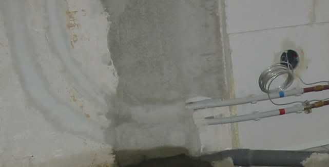

For that reason I was looking for a somewhat flexible diffuser option. I had some scraps left of copper pipe for water runs. We have a type that is flexible and has an outer layer of some flexible plastic material around a copper pipe core. This stuff can be bended manually and poured into concrete walls/floors or stuffed right into a slot that one cuts in a brick wall. It is called "wicu" locally. Don't know if a similar product exists in other countries.
Example use of installed wicu pipes in a brick wall:
From a scrap piece just about the right lenght I pulled out the copper pipe core. What was left was light, the exact right diameter, flexible and glued right to my melded arrays. Before gluing in I roughed up the surface with some sandpaper. After gluing, a little dark paint was all that was needed to make it blend in.Image
