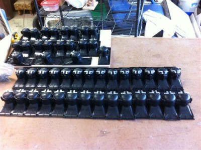

I tested until I was blue in the face.....so I went on with the cutting.
Here's my army of piezos with the straight cuts finished. Heading back out in a few minutes to start the 45s.
This isn't hard word, but it is tedious. Took awhile to get my jig squared up - had to use a little masking tape to build one side up a little as I was off 1/32".
