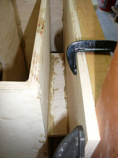

What if there's a leak in there somewhere?

CharlesC wrote: What if there's a leak in there somewhere?
It will make sure that next time you make one of these that you'll be checking three times before progressing on any of the next steps - plus making up a check list for yourself.

Gah you guys provide no consolation.
I forgot to mention. I had read in some post somebody recommended using pocket hole screws instead of drywall screws. Tremendous suggestion. They work much better imo.

DJPhatman wrote: Total waste of money on Bill's designs. The screws don't even need to be left in once the adhesive has cured. Most of the builders now use pneumatic brad nailer.
No doubt the PL is plenty with all the glue surface involved. In fact with my 18" wide cabinet I'm surprised there's even a need for the braces. But even if you plan to remove the screws they're better. They go in much easier (self tapping) and are thinner so they don't bust out the wood so easy.
Moving right along. The end is in sight.
What a damn mess.

#23 Post by AntonZ »
CharlesC wrote:What a damn mess.
Don't sweat it, messy PL is good :cowboy:

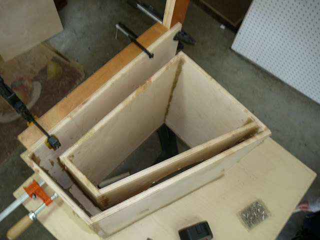

CharlesC wrote: I'm finally realizing that I'm not going to be able to get in between panels 3-5 and 4-6. I guess you just have to pray everything's airtight? What if there's a leak in there somewhere?
Use a bright flashlight in a very dark garage. Shine it down the space in the adjacent panel all the way to the bottom. Look down the opposite side of the panel. If you see light apply more PL if not light move on, you may have to use a stick or something to get the PL down. It is a huge pain. But I found and fixed like 10 leaks on my 27" T60 doing this, and is better to find them now.

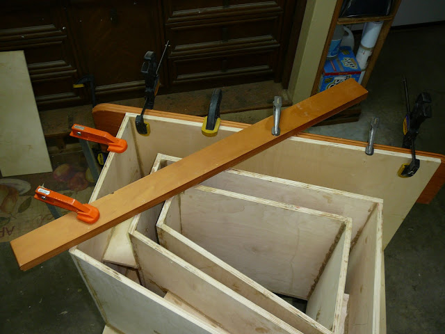

2 more panels! 2 left to go.
I had a major cock-up tonight. Cut the angle on the wrong side! Luckily I had my old baffle that I had screwed up and it fit perfectly. If it wasn't for that I would have had to go get a whole new sheet of BB because I'm out of scrap.
