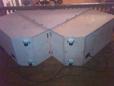

Ooh, they look pretty good with the back angle on them. Good job!

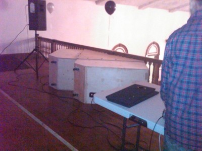

Since no one else noticed: bigtune, follow the sub placement sticky, found here. Your placement in the middle of the balcony will suck the bass out. Move the V-plated pair into the corner behind and left of you to evenly bass up the entire building. Your T48s appear to be in the "no-zone" of bass frequencies, more than 2' and between 8-10' from a reflective surface (wall).

Re: Judgement day Titan 48
Thanks guys. Well, I don't wanna drink the kool-aid just yet because I live in North Jersey and it snows practically every other day so I haven't had a chance to demo the T48s in open air yet. As for the gig, I didn't need to corner or wall load the T48s as they were pretty loud and evenly distributed with just the -10db lights flickering on the xti. I was looking of ways to squeeze every bit of deep and loudness out of these two T48s with out having to build two more

Read your plans. The large chamber version is not recommended for less than four cabs. Want it louder and lower? Wall or corner load.bigtune wrote: I was looking of ways to squeeze every bit of deep and loudness out of these two T48s with out having to build two more
