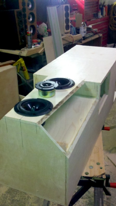

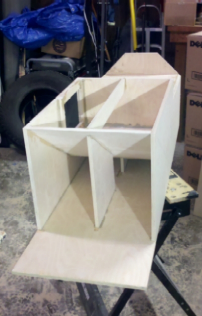

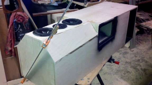

Got some time to build today. Snowed in here in Central Illnois. or course before I build I must clear the driveway and repair an enclosure for my livestock. OK not so much livestock as my wife's pet ducks. The wind blew so hard overnight against the garage; in mean: shop door that I had 2 inches of snow inside, my toolbox was covered, and the furnace for the house (which is inside a mechanical room in the garage; I mean shop) froze up and I had to thaw it in the middle of the night with and electric heater. ' built a baffle on each side of the garage; I mean shop door track so that won't happen again.
Here are the pics

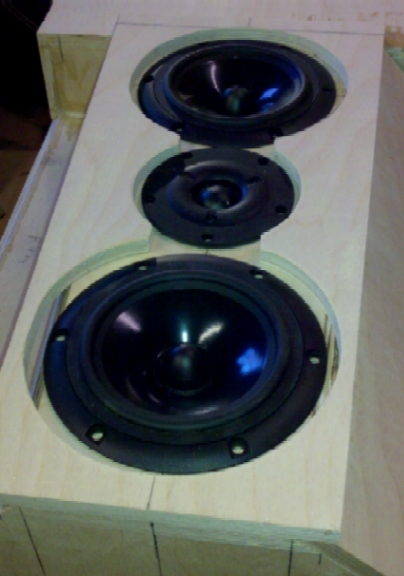

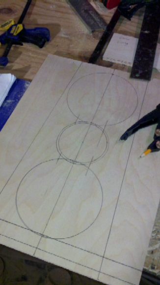

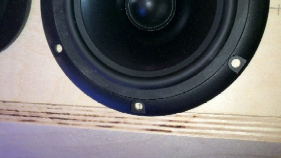

OK, laying out the drivers on the baffle all I have to say is D@MN!! It's tight at the top. The driver flange overhangs onto the wings a bit. I think it will be fine but it gets tight when you are going to add a grille backer. I'll not as good a woodworker as Bill and I left a bit of wiggle room in the driver cutouts in the backer so I can set it square. This doesn't leave enough matterial to make the 45 degree cut on the edges as indicated in the plans. There just would not be enough matterial left at each side of the upper driver for the backer to remain structural. I did put a round over on it and it looks fine. NOTE: As indicated in the plans it is important to get the drivers as high and close together as possible. I took a bit of liberty and my bottom driver is even with the bottom of the wings. It is not ideal but will be OK as that works into my finishing scheme.
