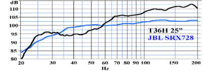

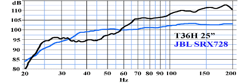

Does anyone still have the SPL chart for these? I remember these subs got super sic in a herd of 4 or more.

subharmonic wrote:Does anyone still have the SPL chart for these? I remember these subs got super sic in a herd of 4 or more.
I don't have the page with the stacked charts, but here's the chart from the sales page.
Bill - if you still have the charts from the SPL thread that compares the various T36 configurations (Vertical, Horizontal, stacked, etc.) I'd love to have them...
From the sales page
From the sales page
