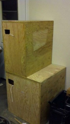

Versatility. I am really glad we built 2 slims and 2 27"ers. This really allows us to have a small footprint when needed and a lot more bottom end when needed.
Slim stacked on top of the 27"er

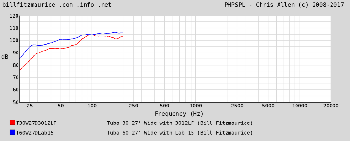

meh, skip it and just build 2 T30s per your planned t60 number? they'll go flat down to 30, belligerent.
2x 3012lf loaded t30s will be just about even with the 27" t60 at 30 hz.

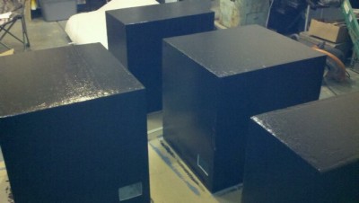

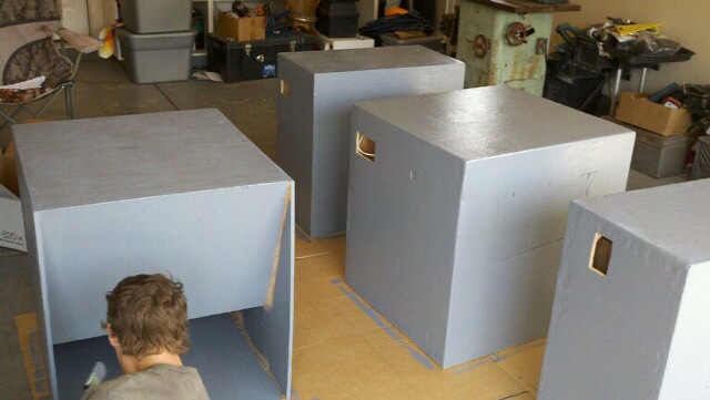

Forgot to post the rest of the build pics. Here you go:

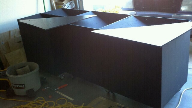

This gives you a great look at the 18" wide versus the 30" wide. We built both for versatility.
Primed and Ready for Duratex.
Duratex all done and drying.

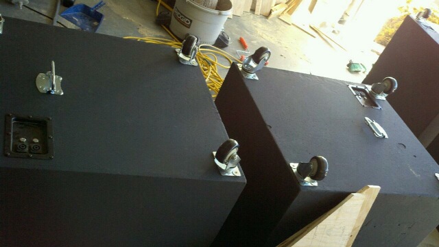

Input plates and casters for Easy movement (these are the same casters used on the QSC KSub)

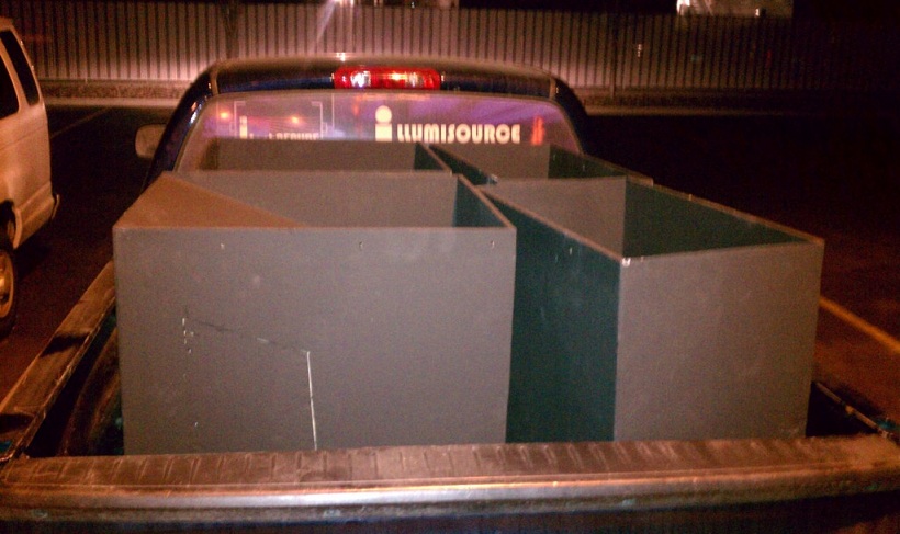

I wanted to show this picture of how much pack space these take. They are in the 6' bed of my 2006 dodge quad cab.
An idea of how much room these take up.

Jasen Chandler wrote:Two V plates so we can have them in 2 places if need be. These slam I posted some vids in another thread of them doing insane SPLs.
Ummmmm....be careful transporting your cabs that way. all it takes is a 35 MPH gust of wind to take out your drivers.

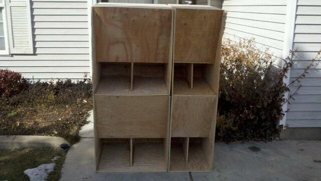

Jasen Chandler wrote:Southern Utah. Here are some more pics (27" wide).
It seems that you have added a single brace between panels 4 and 5. I thought that this was only necessary with twin drivers. I am just at the stage where I could still add in a similar brace (will be PL-ing panel 6 tonight!). Is it a good idea to install this 4/5 brace, just for that extra bit of security?
