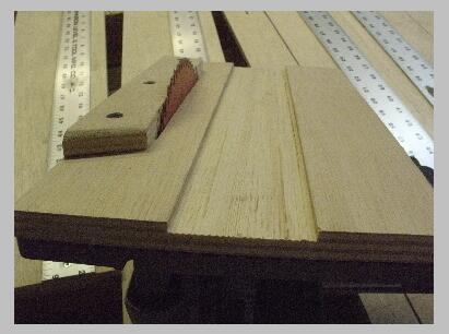

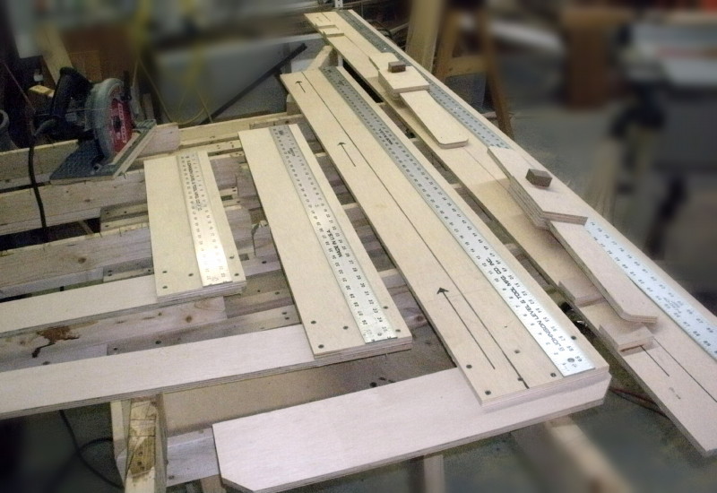

Here's my "cheapie smart" system... all homemade from plywood and giant aluminum rulers. Has zero clearance antichip on all edges just like the EZ Smart. The shorter units are also squares, 24", 36" and 60". Also have repeaters that attatch to the 8ft unit. Cuts smooth as silk. Everything rests on an expandable cabinetmakers table that adjust from 2' by 5' to 4' by 8'.

That's pretty clever, a poor man's version of the EZ Smart. Do you still have to clamp your track on from above? One of the nice things about the EZ is the groove underneath the track allows for clamping from below.chaywood wrote:Here's my "cheapie smart" system... all homemade from plywood and giant aluminum rulers.

On the bottoms I glued a few strips of 320 sandpaper and the guides stay nicely in place. I can also clamp anywhere along the left edge since the guide is wider than the saw plate. I usually clamp each end with a spring clamp when making an 8' cut. Since the guides are wood you can screw jigs and stops to them also or screw them to the wood. I had the 8' ruler already ($19.99), so I purchased 2 additional ones, 60" for $9.99 each at HD. Cut one to 24" and 36". $40.00 plus some scraps of wood and you can cut exact to the line and smooth as silk with no tearout.

I could see where the sandpaper would work well for longer cuts using the squares like you show on your pics. I was thinking about it last night and if you wanted to you could you could make a shorter one and install t-track in the bottom of the guide board and put clamps on the t-track. Then you could use it for doing shorter taper cuts and such.

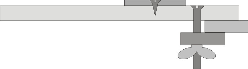

You can drill a hole anywhere on the wood part and put a countersunk bolt through. Use a wingnut and scrap of wood to hold the work in place.

Your wing-nuts look prettychaywood wrote:You can drill a hole anywhere on the wood part and put a countersunk bolt through. Use a wingnut and scrap of wood to hold the work in place.

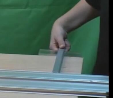

To make repeated cuts as in ripping out pannels you use a "story stick" as shown in this video.
http://www.youtube.com/user/peweuk#p/a/u/1/L2SwVuFmkZk View at 5:45.
