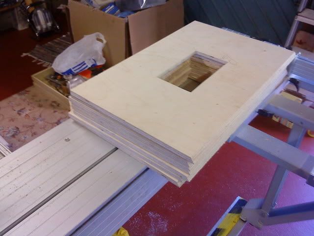

No updates due to numerous delays and exams. The garage is currently taken over by 12 ransome's lawnmowers but should be reclaimed soon. Also there has been problems sourcing the drivers as PAP was very slow/ went down halfway thru the order. But all seems back on track so expect updates soon, I certainly haven't forgot about them.
Regarding the building process I reckon you follow the plans... I've built quite a few subs before and I always see a definite improvement each time, experience counts for a lot building speakers, especially in the all important finishing touches that really finish the speaker off.
As turntablist suggested if you wanna cut in one go, have a model mock up so you can test the cuts, if you notice in the pics there is a separate cut-out trimmed with beading and pencil lines showing the separate cuts, I used it for this very process. I suggest you make it out of thin (6mm) ply tho. If you bead all the edges it will also work as a jig for holding the parts together during construction, a fair bit of work but for 4 or more cabs deffs worthwhile.

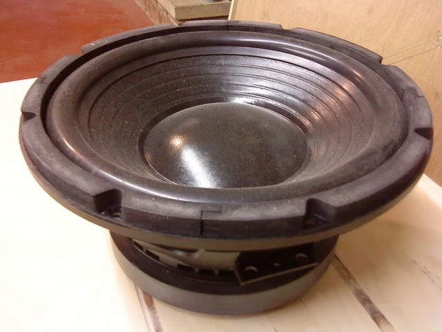

Weight of each driver is well over 10Kg so they arn't easy to handle themselves, but the magnet is HUGE and the constrution very solid. Would be nice if they weighted as much as the deltalite 2512 in my OT12's but one cant have everthing, and I'm guessing if they did I definitely wouldn't be able to afford them. Overall the weight is something im prepared to trade for extra performance in this case. And not following the lead of some of these others, there won't be any lead going into the cabs, :wink:

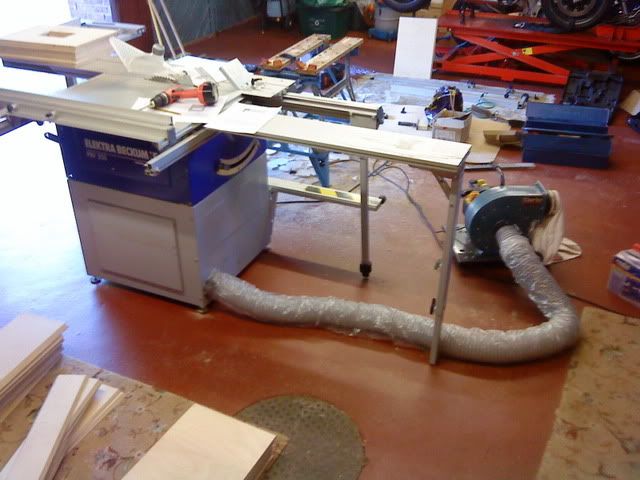

Finaly got some progress down today, there is a 20ft shipping container in the garden full of stuff which means 3 bays of work space for me. So i'm going to be cracking on in the next few days so hopefully they'll be finished befor long.
notice i've also painted the garage floor, definitly a good idea but stoped short of painting the walls just yet.

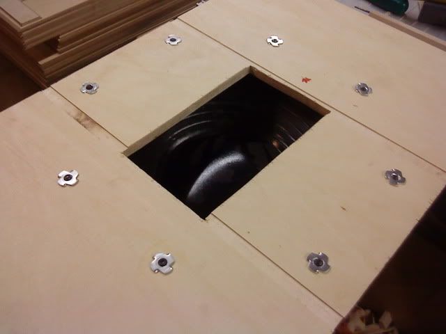

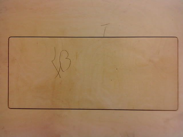

I also cut out the access panel's today, took ages but i got them looking pretty nice.

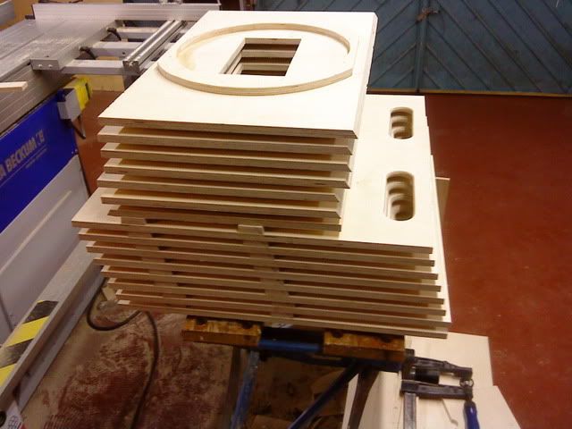

Damm doing things in 8's is slow, progress hasn't been to fast but im happy to be steady away at it.
Pleased with the covers

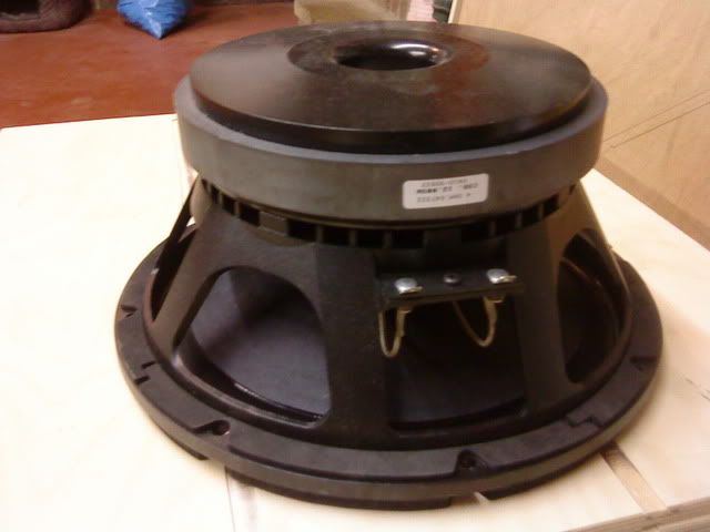

And the (dusty) driver im using:

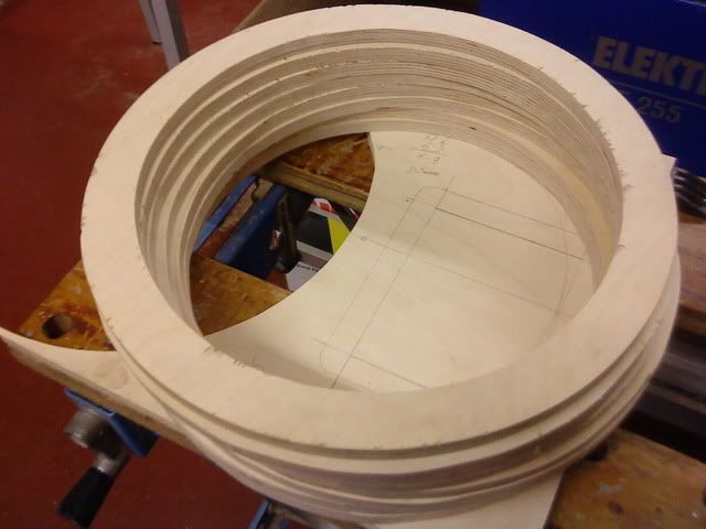

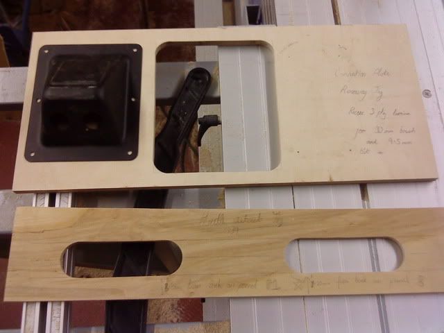

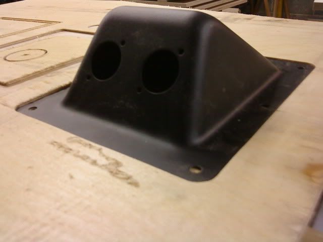

Building a jig to recess the connection plate and a jig for the handle cutouts atm, but after that i should be about readdy to start assembling them. Also im gonna try the floor paint I have left over on some scrap wood to see if it beats the tuffcab stuff, should definitely be harder anyway.

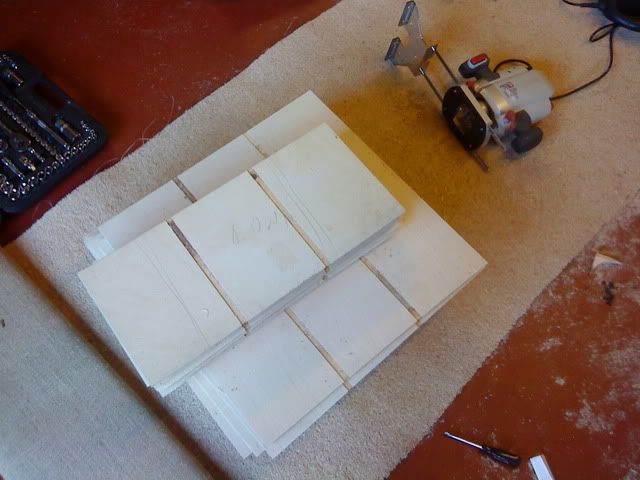

Well all the time I had spare to make these suddenly got eaten up so i haven't done a huge amount since last, the first 5 panels are glued together and all the other panels are preped. Only thing left is to finish the assembly, and cut some more braces, the last set need modding and im not quite decided how im gonna do them so they are changed to support the grilles. Note the blood sweat and tears (last two didn't stain tho) put into the build as evident in the 2nd pic
