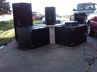

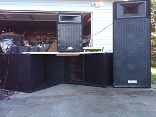

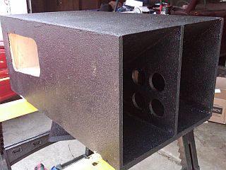

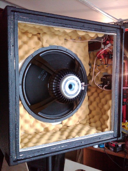

:cowboy: Ok I'm the guy building the "experimental" Tuba 36's 25" wide. I have completed the second cab and have tested with a V Plate. Pic's below. I found that I got the best sound crossing the Tubas at 80Hz and either of the test mains at 120Hz. I do believe this is due to the poor octave slope on my crossover ... better one is on the way. Bottom line my neighbor across the cornfield called during testing and told me I had better stop before the people in town complain. (I live just outside town.) He is the Chief of Police and was getting ready to go on duty and the Tubas were rattling his windows. NICE! I have also built an AutoTuba 17" wide with very pleasing results. That unit is powered by a cheap Dual 300 amp. $55.00 at Walmart but it easily keeps up with my son's friend's Dual 12's. Now he wants to ditch the 12's for a TUBA!
Tuba #2 ready for DuraTex
tuba2 duratex.jpg (16.17 KiB) Viewed 2001 times
Here are the two tubas V-Plated with the two tops I used for testing. I am currently builing some Omni 15's with some help from Leland at Speaker Hardware...<br />Thanks for everything Leland!
V Plate Front 2.jpg (16.02 KiB) Viewed 2001 times

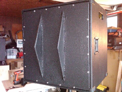

Here is the AutoTuba just prior to mounting the access cover and Amp.
Rear View. The Chief's home is to the right out of view across the forty acre field.
V Plate rear.jpg (15.83 KiB) Viewed 2001 times

OK, It is time to dive in. Experimenation is over. I have learned much.
1. Do not let music or equipment snobbery make your decisions for you.Maybe I should back up. I do live sound DJ, Bands, Special Events, Auctions, and the like. I own a small music publishing business ... I mean microscopic. I learn as I go. My premier artists are very tallented and have toured and shared the stage with many major label artists. I let them tell me the kind of direct radiating megawatted pile of a PA I should get. Now I couldn't afford the high dollar branded gear they wanted so I did the best I could and ended up in failure. Yeah, those are my dual 21" direct radiators in the pictures above. They sound pretty good and get loud if you can feed them enough watts. Then don't get me started with moving the beasts. I could not run my complete PA on a single circuit. I needed too much power and even got a generator and spiderbox supply it all. NO MORE!
The reason I built an experimental Tuba 36 was to see if I could build something from Bill. Here is the ugly bit. Even though Bill recommends Titans for live sound I hesitated to build one since I feared what "the band" might say. I thought the Tuba looked a bit more familiar. WRONG ANSWER
2. FOLLOW THE PLANS, :cop: FOLLOW THE PLANS, FOLLOW THE PLANS For the first Tuba I did not want to wait so I got Luan plywood from the local lumberyard, PL400 for subfloors not PL Premium and went to town. (PL400 will not harden and the joints, although airtight, bow and flex.) Somehow I couldn't understand the rattles and such once cabinet was sealed. Oh, Yeah USE GASKET TAPE! After sorting out rattles, wheezes, adding more bracing and regluing I built the second Tuba 36 using what we call - The right way - and Viola...V plate the pair and BOOOOOOOOOM.
3. Use the Forums - I have never felt so privileged to be part of such a large amount of knowlege from the most helpful group of people.
Special thanks to Leland at speakerharware.com.
4. Building BFM cabs is severely addictive. I never thought I could do as well as I am in woodworking. What a treat!
5. Take your time to do it right. The devil is in the details.

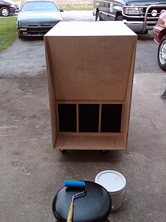

Back with cover added ready to ROCK

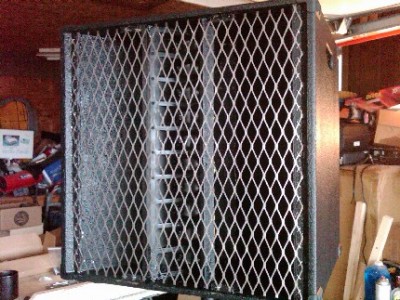

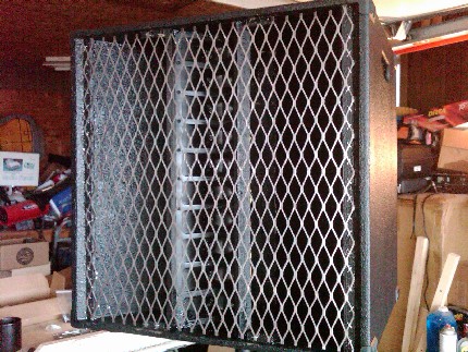

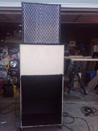

Front view in Duratex with expanded metal grille

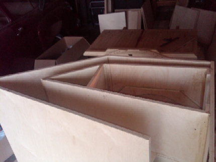

Rear view prior to Duratex and install of back cover

Nice. Did you put the braces on the outside for a reason? Cab protection?

Back bracing on the outside was a misread of the plans. It seemed that if they were internally mounted they would hit the driver. I also wanted as much air as possible moving to keep things cool as I can see these getting run hard. I hope it doesn't change the sound. Now that this cab is built I kinda like the look.

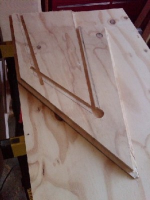

' Started in on the Titan 48's today. I see builing quite a few of these in my future so I made an assembly jig for the inner baffles. The jig sits on top of the parts top hat style during assembly acting as a third hand holding the panels true during assembly. I have been finding it difficult to true the panels with just a guide board. Maybe I am missing something but this jig seems like it will speed up the production process. It was a tip from the cabinet shop where I have been buying my BB. I made two. Each a mirror image of the other so I can test fit the pieces before attaching them to the side for final construction. I rough cut my pieces and tested the jigs. So far they work like a charm. I will post updates in a couple of days after some time in construction.

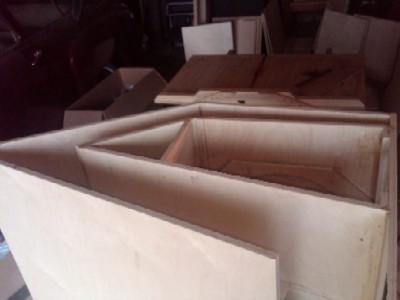

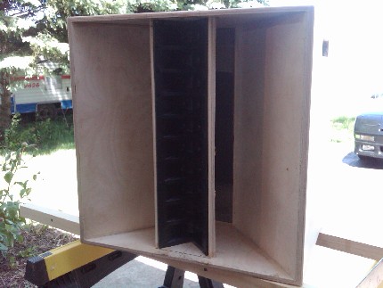

Titan assembly ready for top side

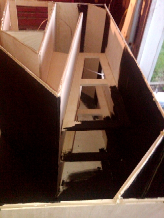

Here is the pre-built chamber and baffle assembly ready to be put onto a side
