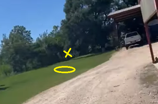

CarterKraft wrote: Wed Oct 05, 2022 7:39 am Final detail question.
Optimism is a good thing. :lol:

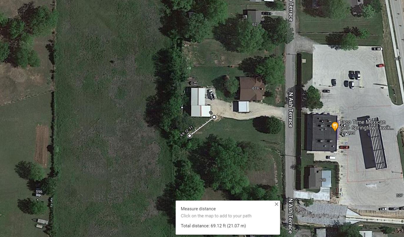

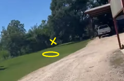

I agree with Bruce. Since your going to want the test signal 10-20dB (20dB is better if it's not too loud) above the highest point of the noise floor in the frequency range you're testing, the further out you go, the louder it will need to be (+3dB for every doubling of distance). Mic at a height roughly on axis with the mid and tweeter, 5-10 feet should be great.
It's not uber important. But, since were taking the time to do it, may as well take a moment, consider the environment, and be mindful and deliberate about choosing the best possible placement to minimize reflections.
In your test video, I don't know if you heard the reflection off your neighbors house at the end of the driveway. It's far enough away that it's not likely to affect your measurement. But, a quick glance of the space, I think I'd set it up, maybe not exactly, but somewhere around here, aimed toward the X. Or, depending what's behind that tree line (anything reflective?), maybe in that corner with the X aimed out toward the circle, 45º to most of the reflective surfaces in the area (buildings, vehicles, etc.).
Not a huge deal breaker. But, just a reminder to be mindful and intentional when you choose your placement.

I was thinking something like you suggested Seth, possibly rotated more towards the South but in that corner is fine for me, it is open for a long way behind that tree line.
I will take more video for sure, the videos were taken by my son who has a totally different video style than myself.
This is a satellite view to help with some scale. I have plenty of schools with large open parking lots but I am not sure if I can get a better/lower noise floor at them. I will set up here and give it a run, if I run into problems I'll find a new location.

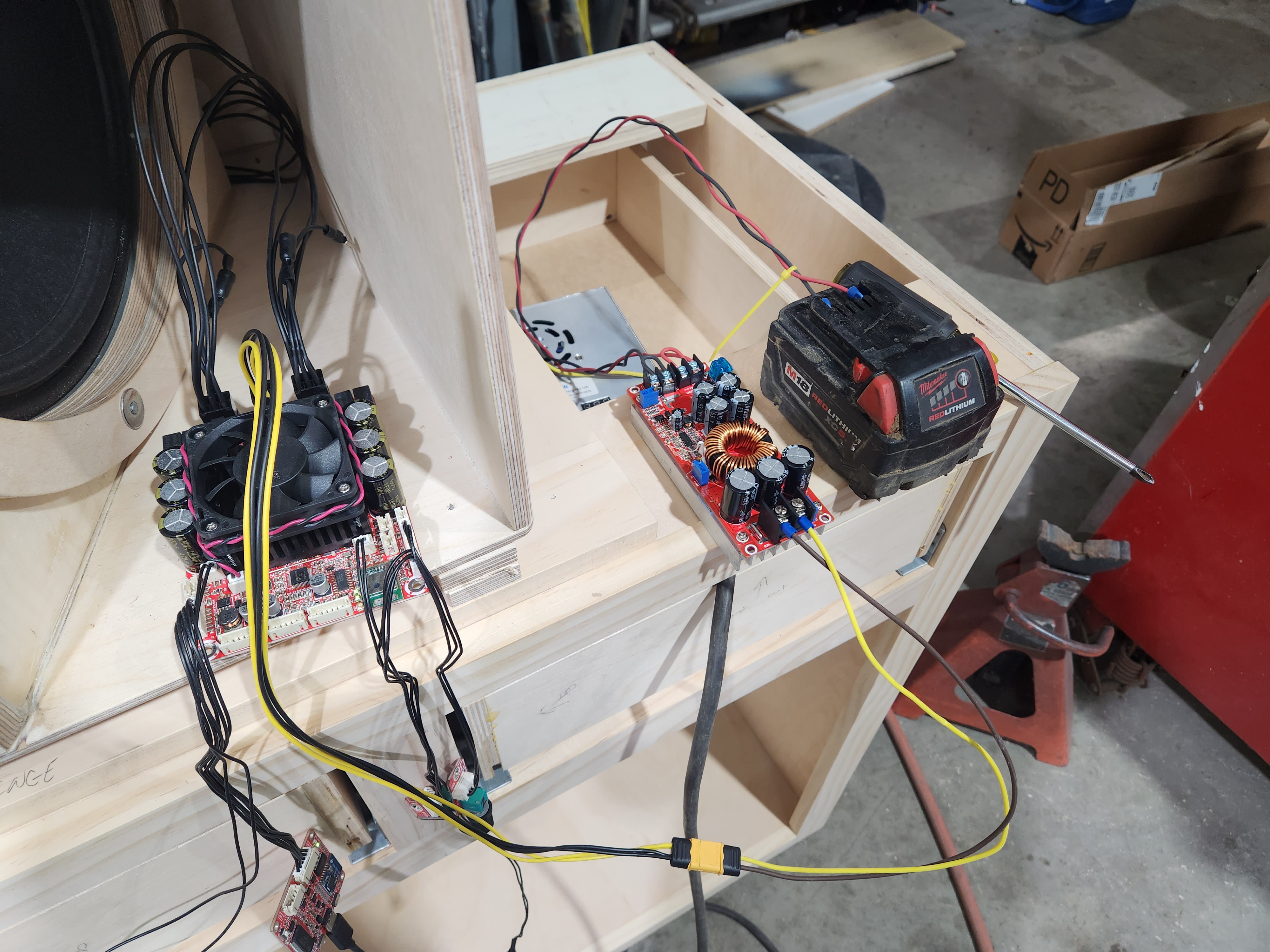

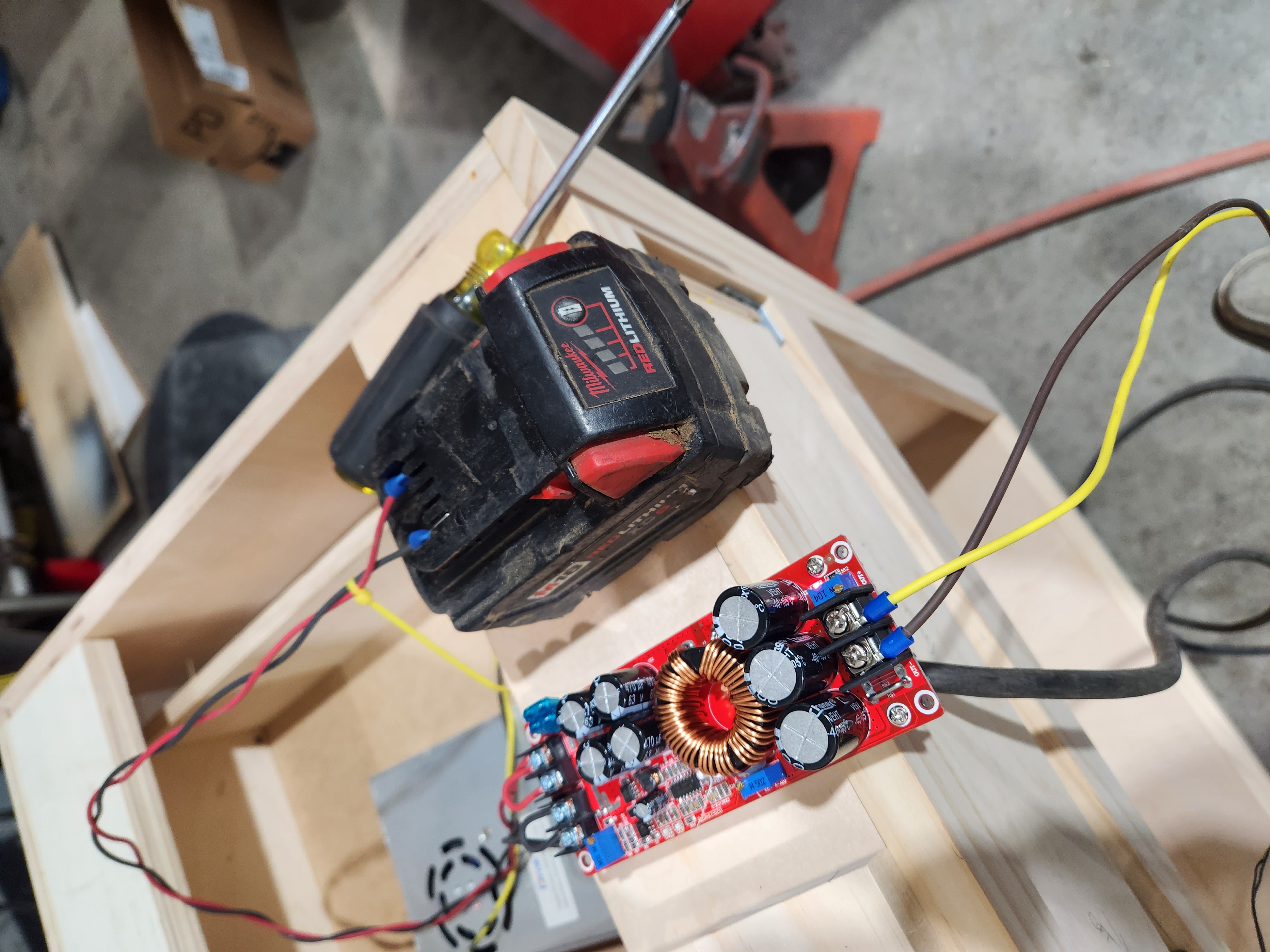

So I messed with the battery power supply.
I got a 1200w "china rating" boost converter to use the Milwaukee or Ryobi 18v batteries. I set it to 35.75 volts and tested it for a hour at easy listening volume.
It didn't get above ambient temperature and battery voltage was still 20v when I went inside on a 5ah battery.
It's hard to say on run time yet but with up to 12ah batteries off the shelf the desired runtime is there.

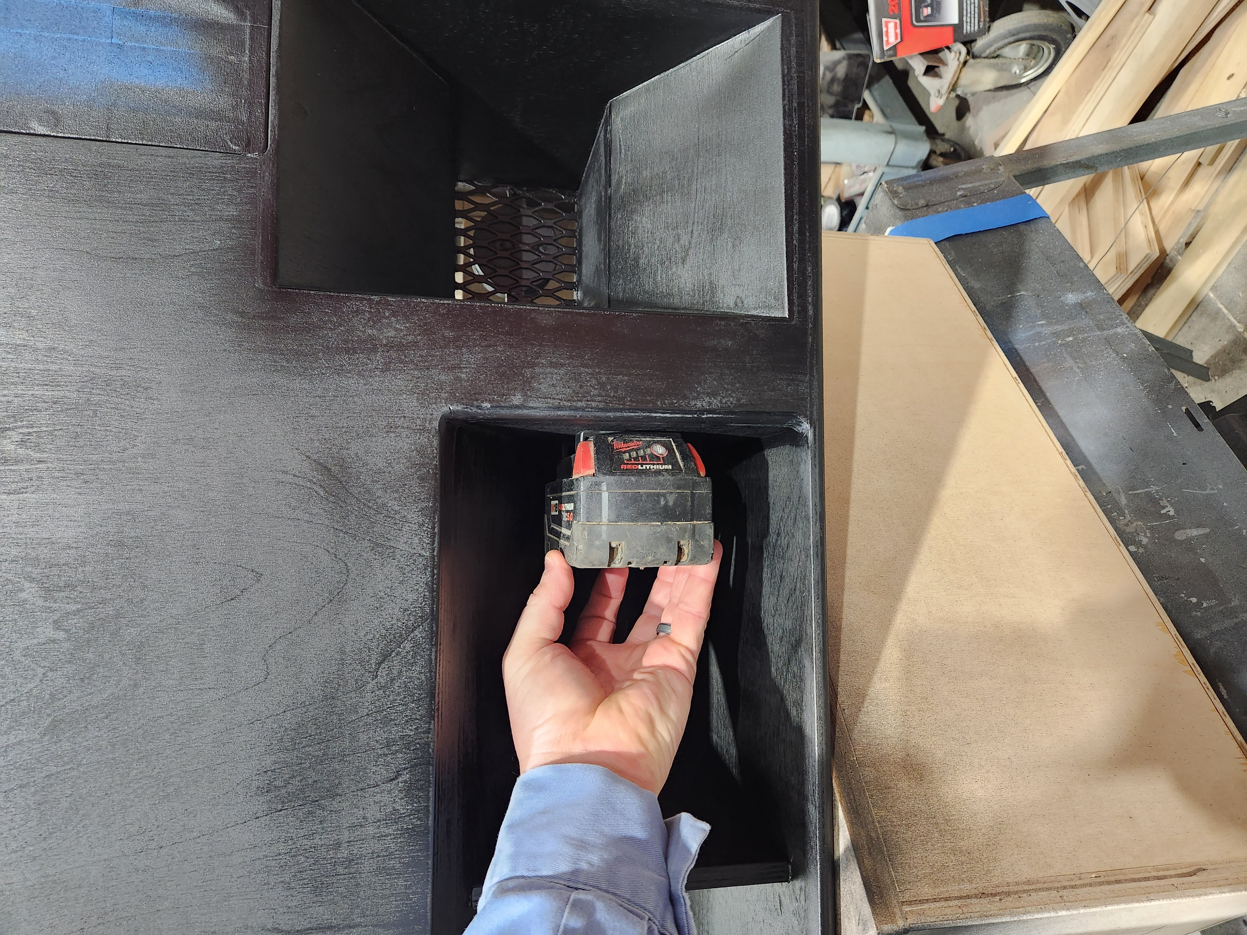

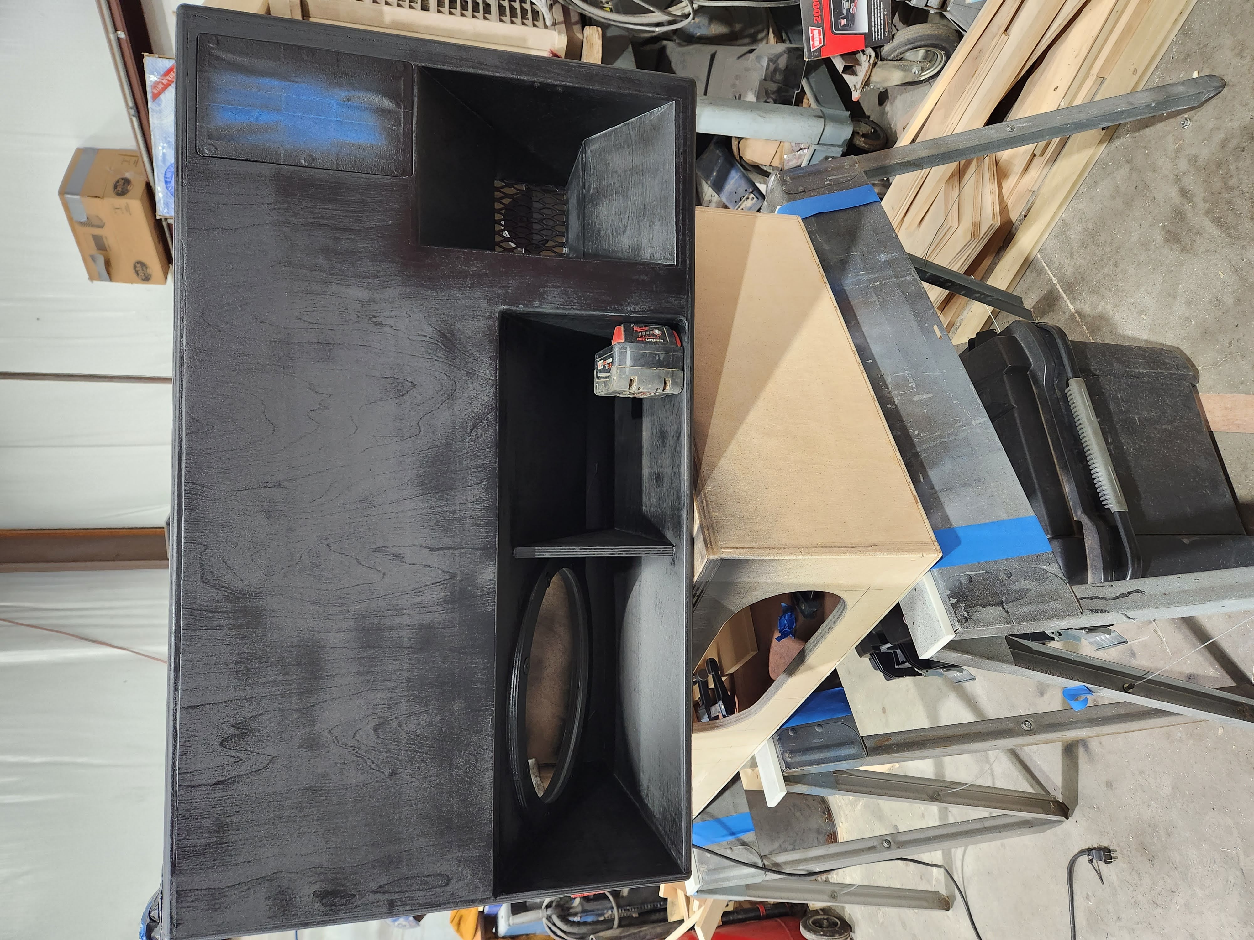

What does the hive mind think about putting this battery/holder in the mouth of the port? Obviously it will change the port volume, but does it matter enough at this far edge of the flare? I can install it and test but before making holes I wanted to get a idea of the consensus.

Why not have your brother 3d print a battery holder clip thingy and mount it on the back? Like this: https://www.thingiverse.com/thing:4850997
CarterKraft
Posts: 263
Location: DFW
#148 Post by CarterKraft »
I have one of the injection molded holders for it.
I don't want anything protruding from the sides, front or back for the sake of easy loading/unloading and not to prevent accidental damage to the box or transporter.
Top is the first seed but I thought it could get hidden in the port that's a two birds deal.
Weldon Carter
Posts: 3031
#149 Post by Seth »
I like that location. Clean and handy spot. Just a guess, but I don't think it'll hurt anything enough to rule it out.
