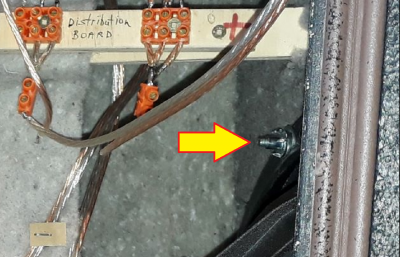

For real though, my guess is one of those T-nuts you have holding the driver on either didn't get tightened enough and/or backed off. Highly recommend lock nuts on lock washers, or double nutting those.

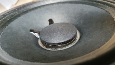

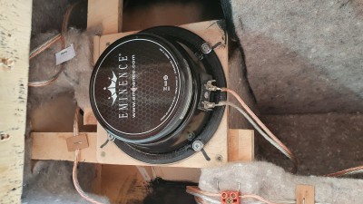

That Elusive Buzz - I think I may have it - Maybe!! - Omni 15 Tall Boy in New Zealand

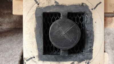

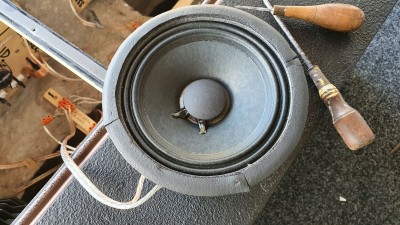

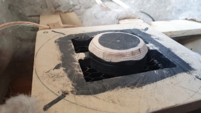

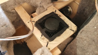

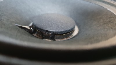

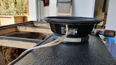

Afternoon All,
We're back in COVID "lock down" agin so, took time out to properly investigate what's going on.
Pics attached for your edification.
= back removed

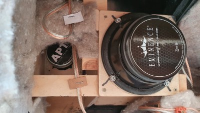

= thought it could be a rattling loose wire etc. Everything tightened, resoldered, stapled cardboard caps on long run wires.
= tightened all speaker bolts etc
= tweeter turned off
= sound appeared loudest in the midrange.
= removed Alpha 6CBMRA

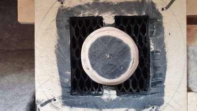

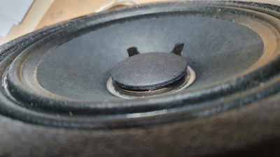

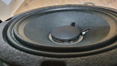

= checked speaker. Pics show what I reckon is definitely a gap between the dust cap & coil. Came adrift? Your thoughts please?
= Why he thinks??

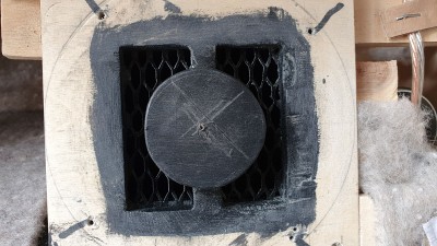

= looked at my cutting of the plug. Looks quite a bit off on one side. Actually, more than a bit
= Didn't notice that at the time!
= using a divider with pencil scriber, marked the required size circle and I was oversize as the pic clearly shows.
= Thought to meself, ahhh that's the phantom buzz right there
= ground down & curved plug edges to be safe just in case
= to ensure (double braces) of enough space between plug and dustcap, I also added an additional layer of speaker tape
= all-in-all, the cab back came off & on 3 times
= when tested with mid removed, no buzz
= reassembled after adjustments and tested loud with good quality jazz & dub tracks; sounded good
= I've taken 4 or 5 vids to show you the tests I did but not sure how to load them as I can't resize them.
= back removed
= Why he thinks??

Oh, and one more thing: is there clearance between the midrange baffle RH lower corner and the front/rear brace?

The gap in the dust cap on your mid driver looks exactly like mine. I don't think it's a problem.
I built a OTB12 with two 10" drivers, and have a sympathetic resonance at 133hz.
It feels like a really loud golden tone, for any upright players out there.
I can't find any structural defect, I've swapped out the drivers and taken out everything except the two 10" drivers.
Also increased the bracing (joining the top and bottom structures) and removed the back.
Even then, same resonance.
Bill and the members here were very helpful, but I've built a couple of Simplexx and Jack 10 boxes for the drivers instead.
If it's not a delamination, I can only think it's a natural resonance for my particular build. Like ringing a bell.
Could be wrong, of course.

One thing I remember, I thought the plug might have been quite close to the dustcap of the mid driver on my build.
I feared with the excursion it might buzz against it, so I thinned it by about a mil.
Ply varies in thickness.
That wasn't it.
That wasn't it.
