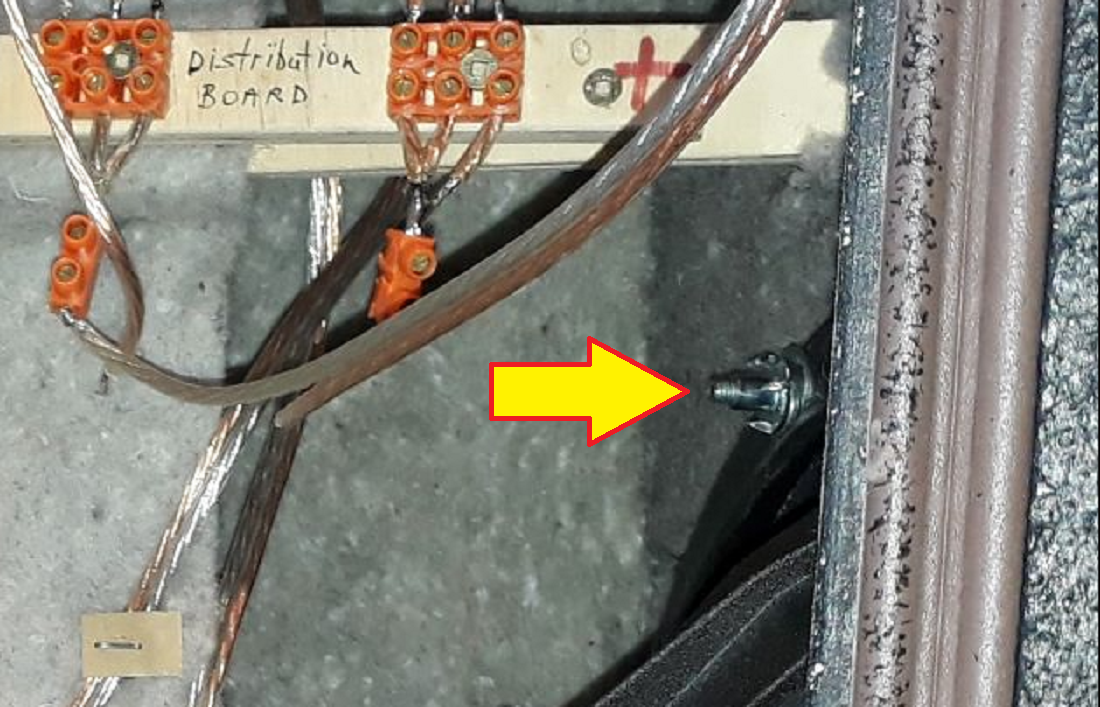

For real though, my guess is one of those T-nuts you have holding the driver on either didn't get tightened enough and/or backed off. Highly recommend lock nuts on lock washers, or double nutting those.

We're back in COVID "lock down" agin so, took time out to properly investigate what's going on. :fingers:
Pics attached for your edification.
= back removed
= thought it could be a rattling loose wire etc. Everything tightened, resoldered, stapled cardboard caps on long run wires.
= tightened all speaker bolts etc
= tweeter turned off
= sound appeared loudest in the midrange.
= removed Alpha 6CBMRA
= checked speaker. Pics show what I reckon is definitely a gap between the dust cap & coil. Came adrift? Your thoughts please? :broke:
= Why he thinks??
= looked at my cutting of the plug. Looks quite a bit off on one side. Actually, more than a bit
= Didn't notice that at the time!
= using a divider with pencil scriber, marked the required size circle and I was oversize as the pic clearly shows. :slap:
= Thought to meself, ahhh that's the phantom buzz right there :hyper:
= ground down & curved plug edges to be safe just in case
= to ensure (double braces) of enough space between plug and dustcap, I also added an additional layer of speaker tape
= all-in-all, the cab back came off & on 3 times
= when tested with mid removed, no buzz :D
= reassembled after adjustments and tested loud with good quality jazz & dub tracks; sounded good
