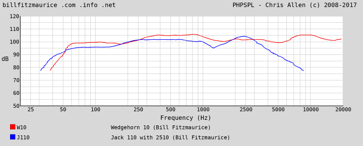

I'm assuming no piezos or horn on that J110?

Bruce Weldy wrote:I'm assuming no piezos or horn on that J110?
Correct. That chart is the one for driver-only. No tweeters of any type.
Harley, was your point that the W10 has better response than the J110 across the board? Are you thinking of switching?

It''s not for me - I have a client who wants both a W10 monitor for keys and a J110 for upright bass. Was thinking of just one wedge shaped J100 or a W10 to do both jobs, hence the comparison.
For my own personal bass use, I am happy with my J110s in either one, two or three stacks for most my gigs which invariably have FOH so no I would not switch to a W10 for bass. I just need enough sound on stage and that's it. The T39/Dr250 are our FOH system. I am more concerned about what comes out of FOH than on stage and the T39/DR250 deliver excellent quality with heaps of low end if need be.

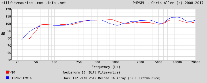

Here's an apples-to-apples comparison with a cab about the same size.
That looks like a tie to me. The J112 stacks better and takes a bit more power. The W10 has the flexibility to be used as either a wedge or a top. If I were looking at building a pair of J112's as tops, I'd seriously consider building W10's instead.
