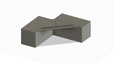

What do you all think of this for a T-48 V-Plate?
Would it matter at all if I flipped the plate over so bracing was on the bottom of it? Can't imagine it would but thought I'd ask.
Thanks!
Thanks!

That fine, but it will still probably flex. I doubled up on the plate thickness by gluing two sheets together with no bracing. No flex at all.

Gonna use 1/2" premcore for the v-plates. Way cheaper and lighter than BB and still clean and easy to work with. Bonus is it's on sale right now at Woodworkers Source. I'll take your advice and double the thickness. 1 sheet will make two plates just fine.

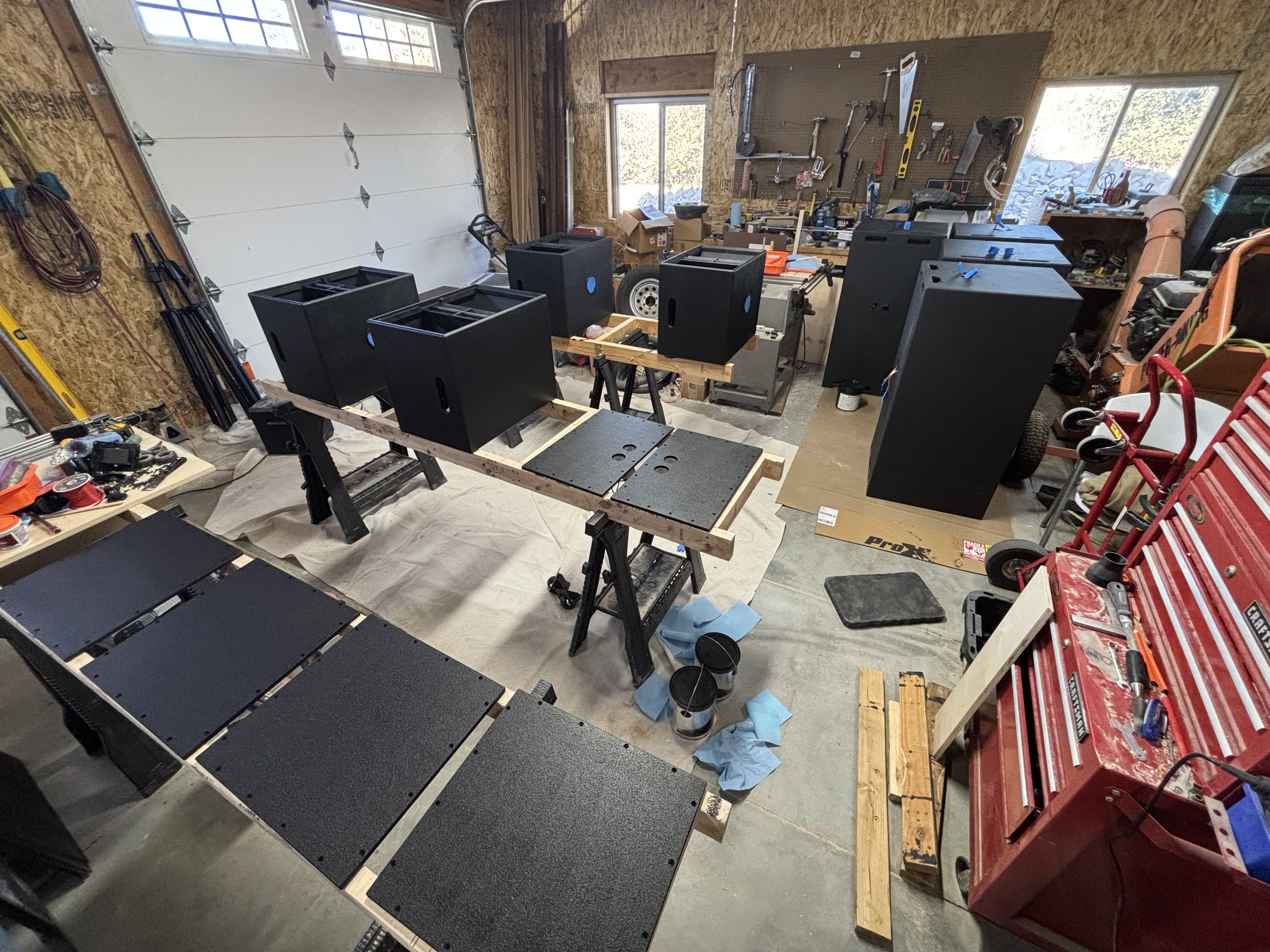

It's been a while since I updated. Been distracted with a few things but still I've been making progress. In fact, just need to drop the drivers in the last two subs and paint the grills and this build is a wrap.
Then I've got a couple Simplex Wedges to build and some load in cases for the OT-12s.
Some pics,
Laying on the DuraTex. It's a Paint Palooza!!

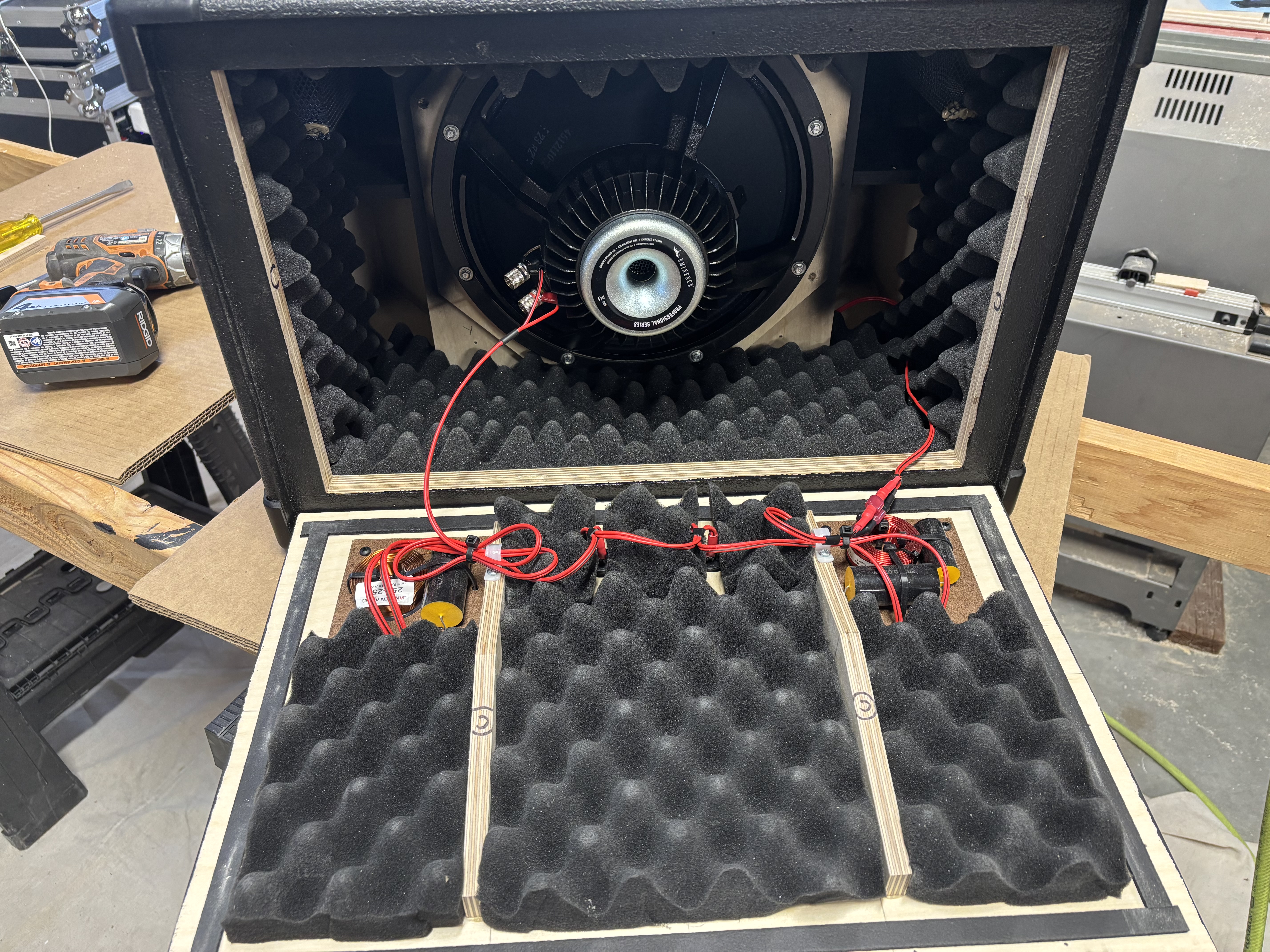

Here's one of the OT-12's just before I buttoned her up. I know nobody will see it (except now you guys) but I will sleep better knowing it's nice and tidy in there. lol

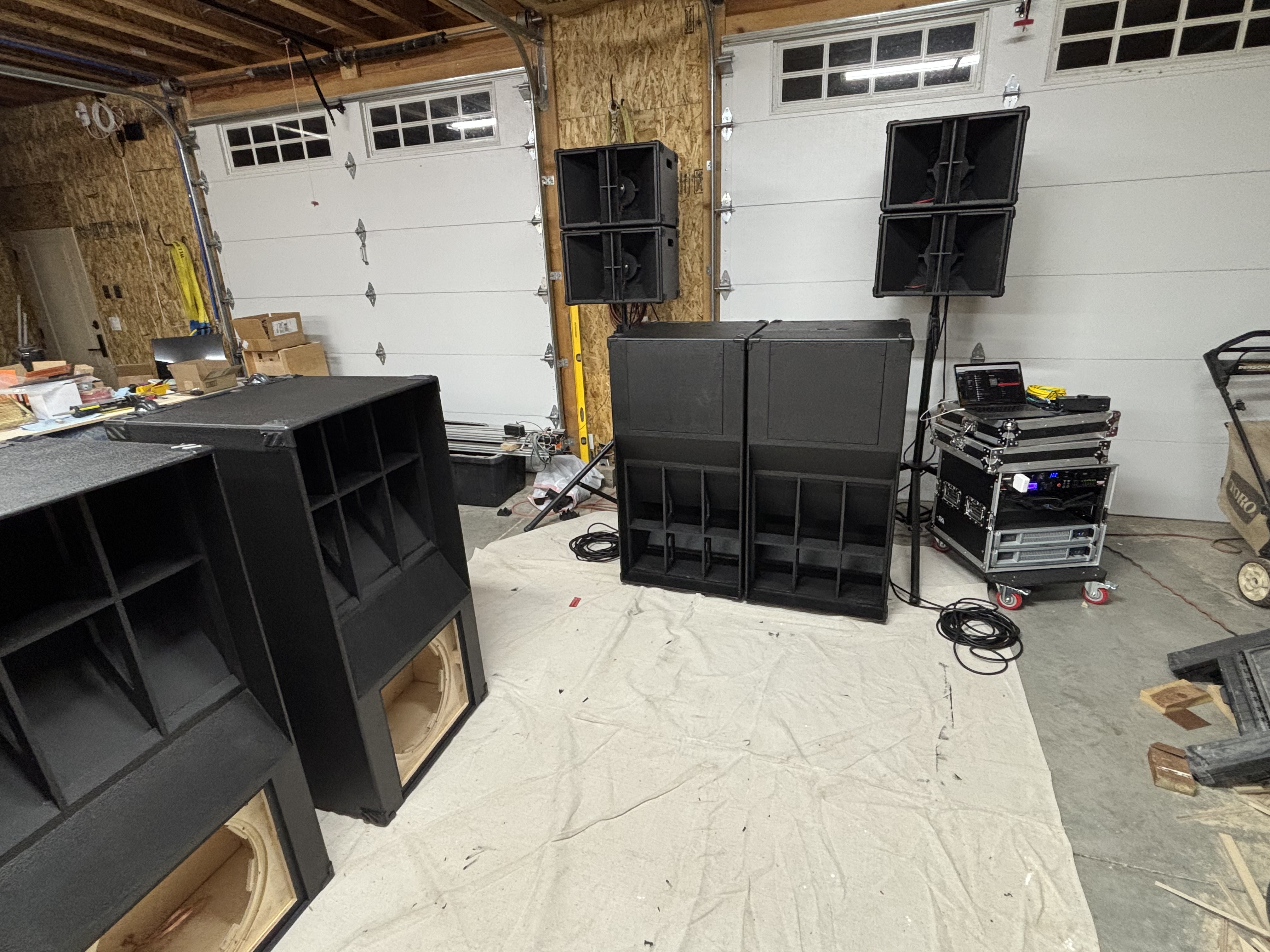

And here's where we're at right now. Jamming to some Steely Dan Aja. Dayum this sounds good!
I'm pretty impressed with how the OT-12's couple when stacked like that. I was doing some full range testing with them and one box was awfully bright but when I stacked them and they coupled the low end got nice and full. Not like with the subs of course and I know they're not designed to be full range but I was impressed how coupling changed the response.
When I can get these things to an environment where I can do some traces (not my shop) I plan to get some response curves in the different configurations and I'll share them. After the holidays.
