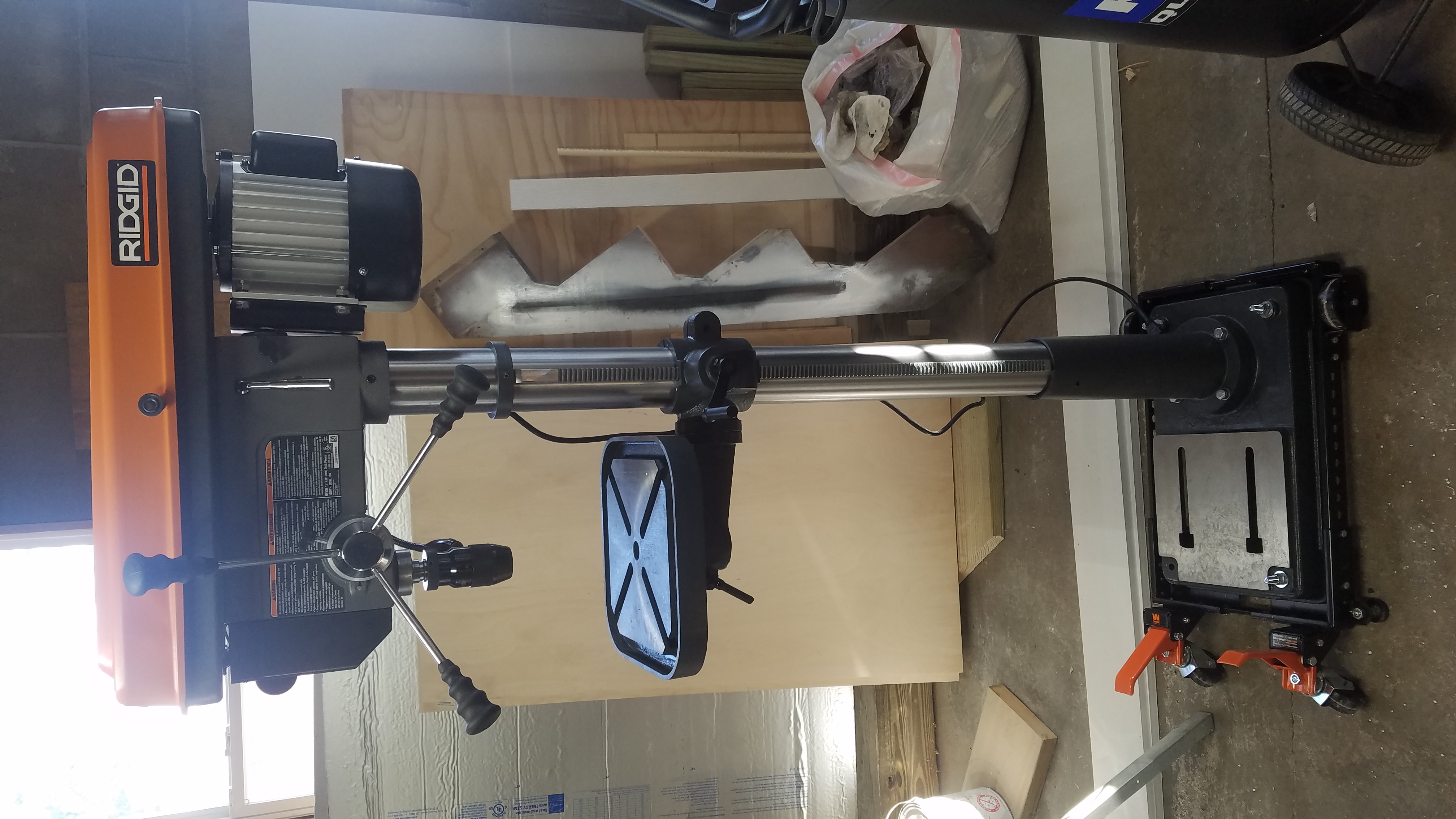

And an update, finally got to open my Christmas present and start working on assembly. They all chipped in and got me a floor standing drill press i've only been asking for forever. My awesome wife bought me my super table saw nearly 20 years ago, and i've wanted this practically as long, just never justified. Now she's getting serious about little projects for her, so lucky me! I've already paused assembly to get a mobile base before I proceed (and it's too darn cold in the garage today!).

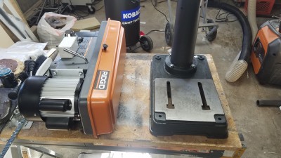

I'm soldering piezo's today, but until I get some progress...my drill press is finally assembled and on the stand.
Fired it up this morning only to find out the motor housing was dented in shipping and rubs the fan.
I waited a week for a mobile base and now I may end up taking the drill back for a replacement. Oh the setbacks!

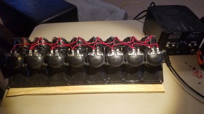

One array soldered up. I had two piezos that seemed off, rattling inside. One was bad for sure but the other tested fine. That being said, as I put them together, somehow two cones smashed or went out of alignment so now i'll probably replace 4.
Live and learn. Oh well, i have one done, i'll order spares and some to make a test better test jig. I cut all my wires in 4" lengths, and stripped a bit from each end. Then I tinned them all, and tinned each terminal just a bit. I held pairs and warmed them, and then touched to terminals to get minimal heat and solder them in. It was putzy but not bad.

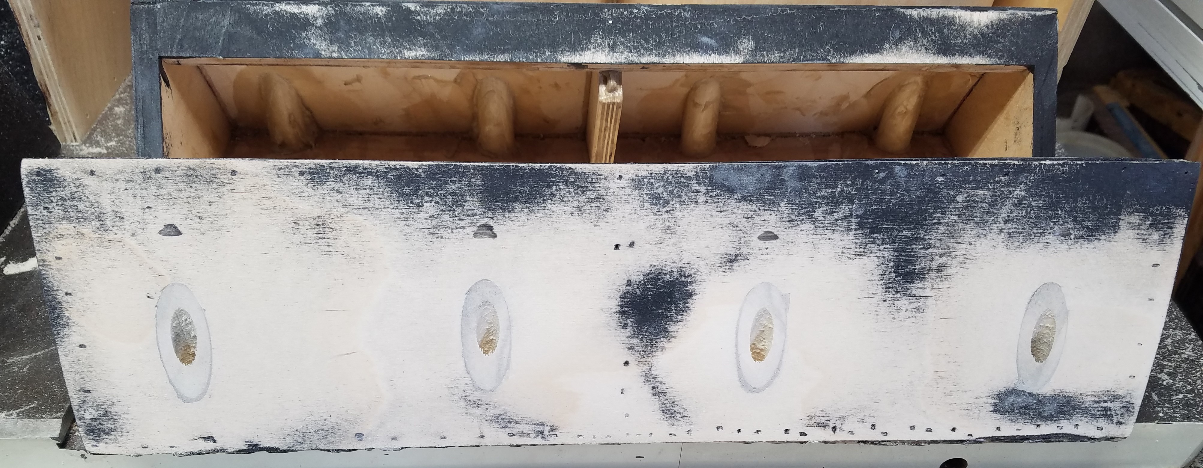

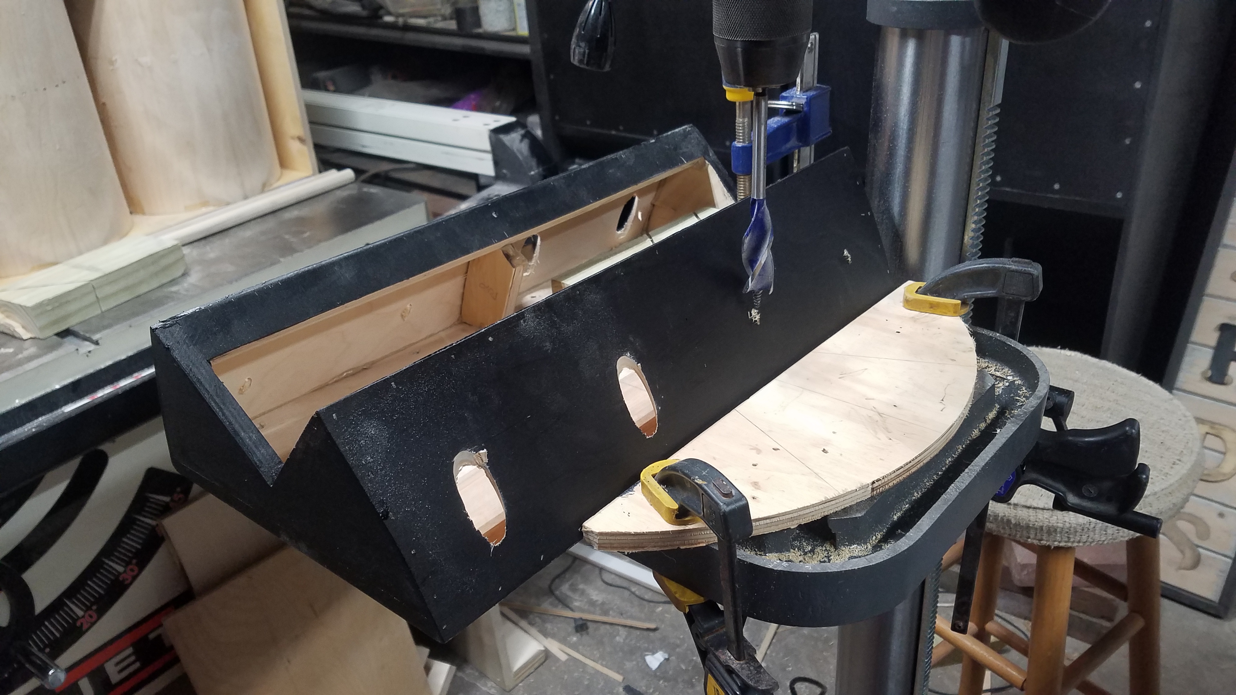

Now that I have a drill press, i'm taking a stab at the Array Modules and nacelles. Someone on here cut holes and put PVC tubes in to recess the screws, can't remember whom to give credit to. I decided i'd try to drill 3/4" diameter holes in the module face. I had match drilled the back to my driver chamber sides/braces. So I flipped it over and ran a 3/16 drill back through from the back side, slowly biting into the module face. My hope was to not deflect too much and get a decent target to hit from the front with a forstner bit. I dont' have a 3/4 forstner but I do have an Irwin 3 blade wood auger of sorts. I then aligned it's point in the hold and slowly cut into the face to make the same ellipse from the PVC mount thread. I find if you put a block of wood on the trailing side of the bit, where it would chip out, you can drill pretty fast. The first one I had some chips, the second cab cut all 8 ellipses pretty clean. I made a stop so all my holes were equadistant from the side/edge. And I was able to align a hole and clamp, slide it and do one more clamp/hole. THen I spun it 180 and did two kittly corner. Then I flipped my stop block and cut the other 2 and 2.
edit credit to Grant Butler! viewtopic.php?p=194715#p194715
My plan is to use wood dowels so I can PL them decent, and i'll fill in the chips with bondo.

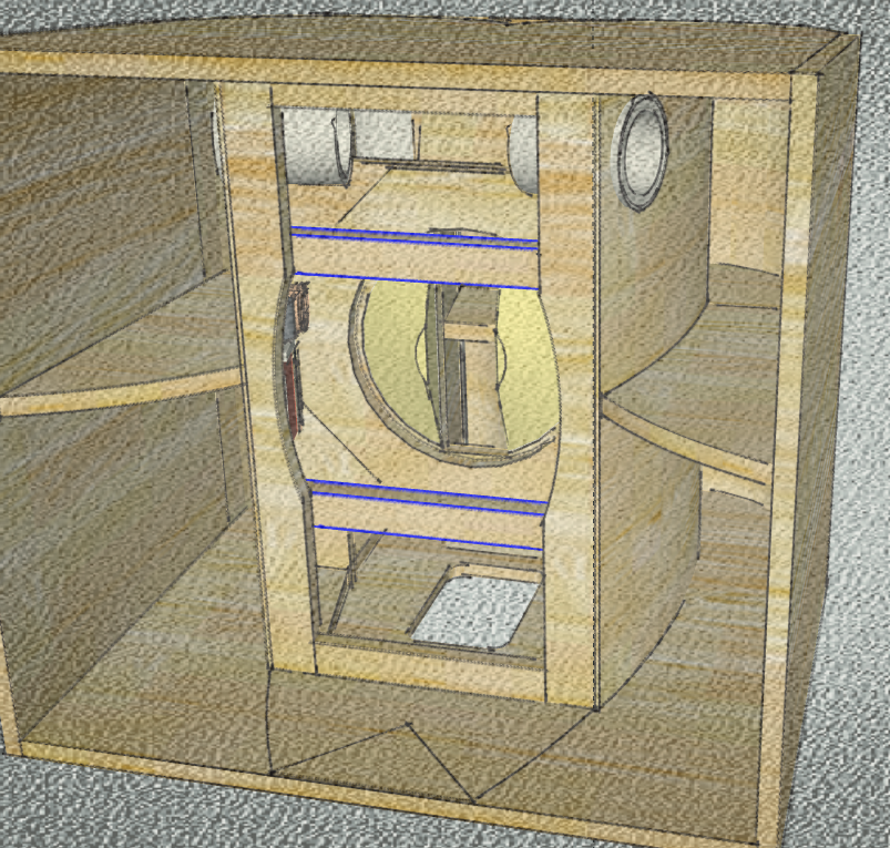

I think I'm going to screw (from the outside) a couple lengths of wood accross the driver access hole (on the inside), which will allow relocating the module screws inward toward the centerline of the cab, where the heads of the fasteners will be completely hidden and accessible by removing the tweeter array. This should be much simpler than making nacelles or anything that requires drilling through the module sheaths. It also leaves the smooth lines of the mouth intact. If a driver needs to be changed, remove the tweeter array, remove the tweeter module, remove the cross braces/anchor points. It wouldn't really be an option for the compression drive horn module though.

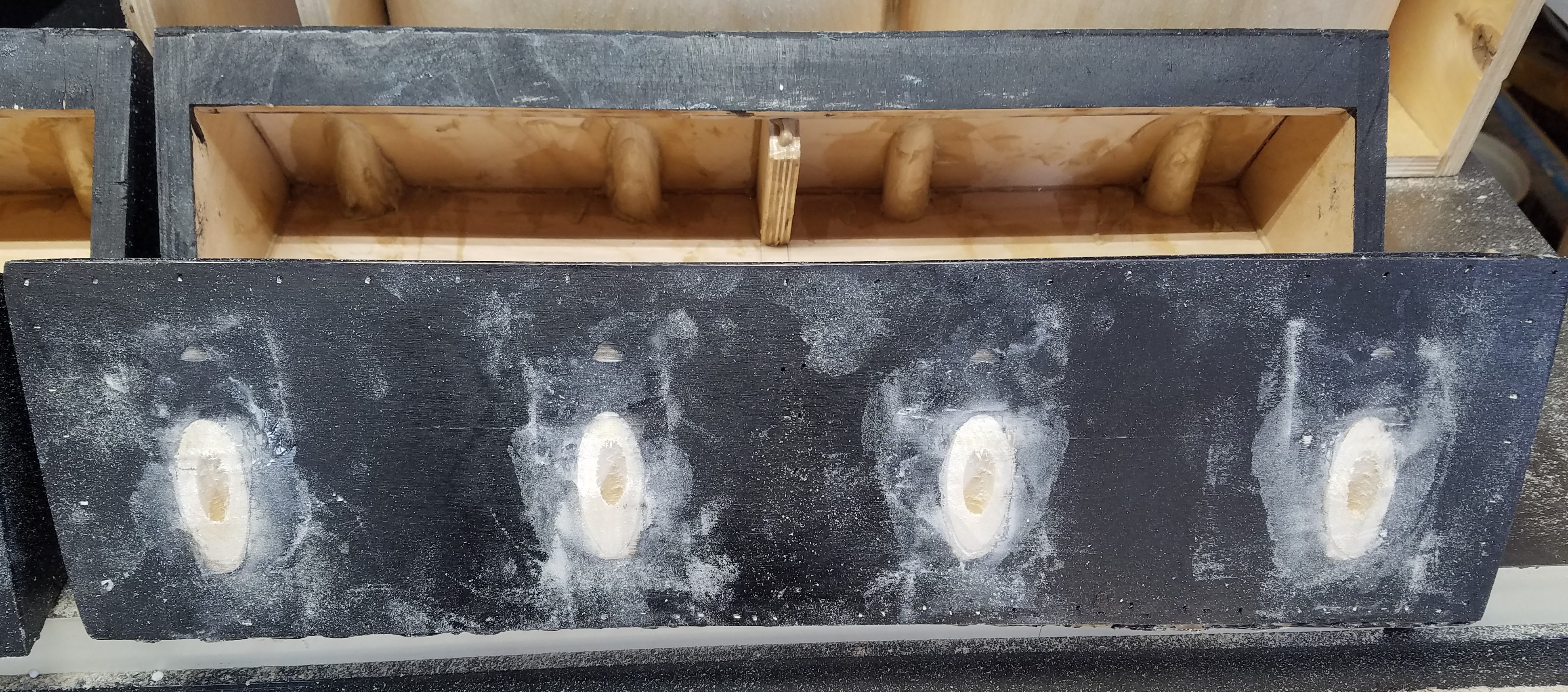

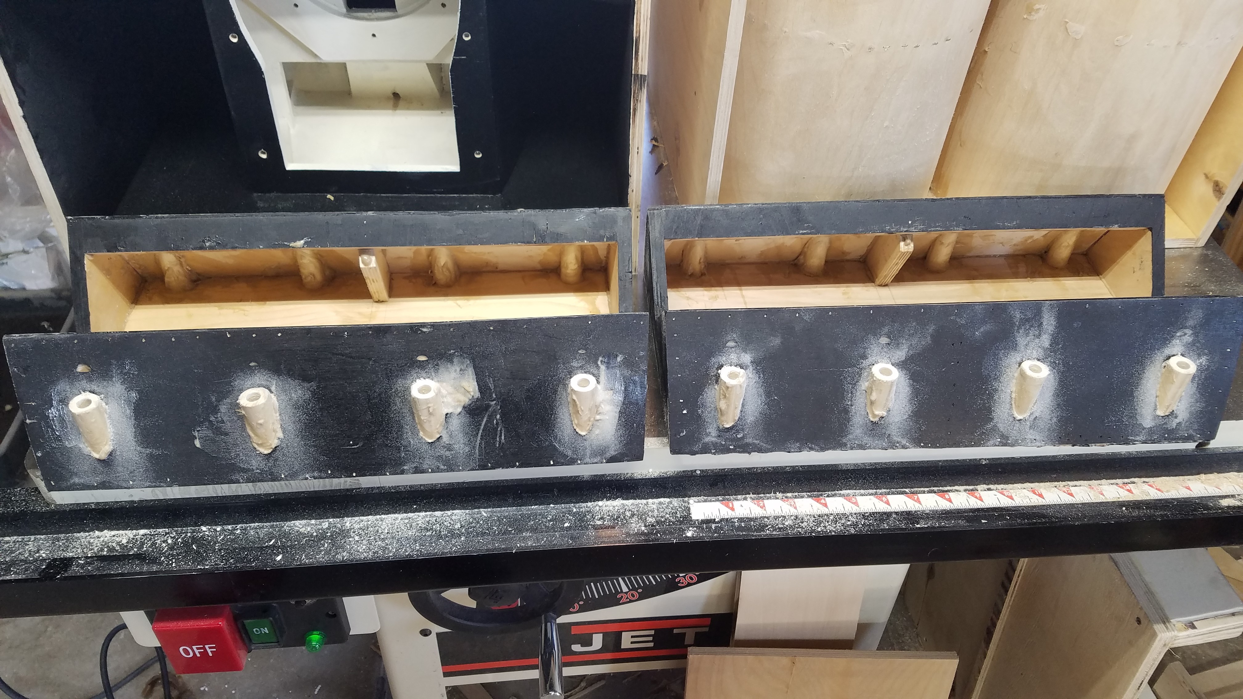

I counterbored my dowels today after they sat/cured while I was gone. Then I cut them mostly flush with a multi-tool. Last I sanded them flush with 60grit and 120. Now to fill in the nail holes and chips with putty.

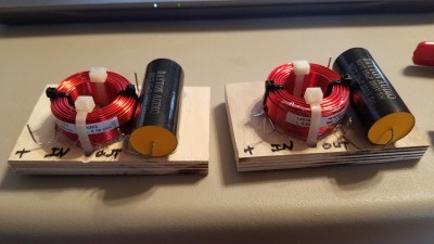

Anyway some updates, crossovers started.
